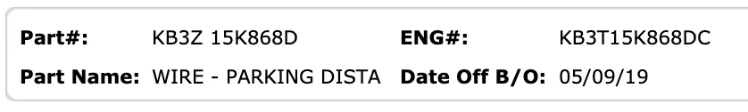

Backorder has been pushed back to 05/09. I have a harness sitting on the floor in my office but like a doofus, I dragged my feet on the hitch and now that is on back order. I have two KB3Z-15K868-D's on a priority order so they should be here before the off back order date. One of them is promised to @Jason L but I will be more than happy to sell the other one to a forum member when they come in.

Thanks for the inside info! I have an order in with my local dealer for the harness, so hopefully it will arrive the same time as your B/O's do..
I went with the Curt hitch due the availability, price, and ease of installation, and will make due with the 4 pin connector under the bumper until the "D" harness is available.
