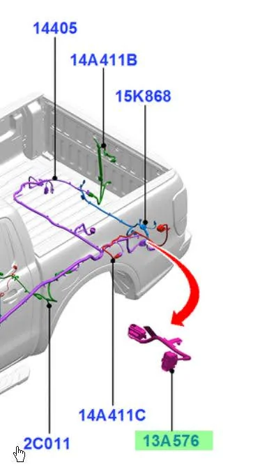

It looks like I missed the K in my post above, it's the "D" that I needed. Out of curiosity, will the 15K868 without the sensors work if you reuse the sensors from the current harness, or does that version not have all the "pig tails" for the sensors?
Also, does 15K868 come with 13A576? On the truck now, it seems they are all one harness even through wire diagram shows them as two, and you can seemingly order 13A576.
The "13A576" is only on Rangers that don't have a rear bumper, like utility beds. You shouldn't need the "13A576".

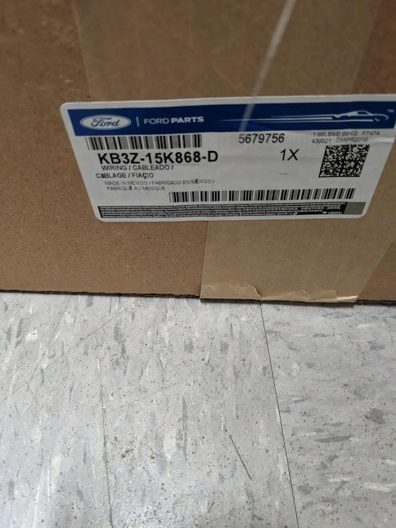

Back-ordered wiring harness, part number KB3Z-15K868-D, came in today. This is the harness that is needed to add the 7 pin plug that is located in the bumper. This part number is for Rangers with back up sensors.
