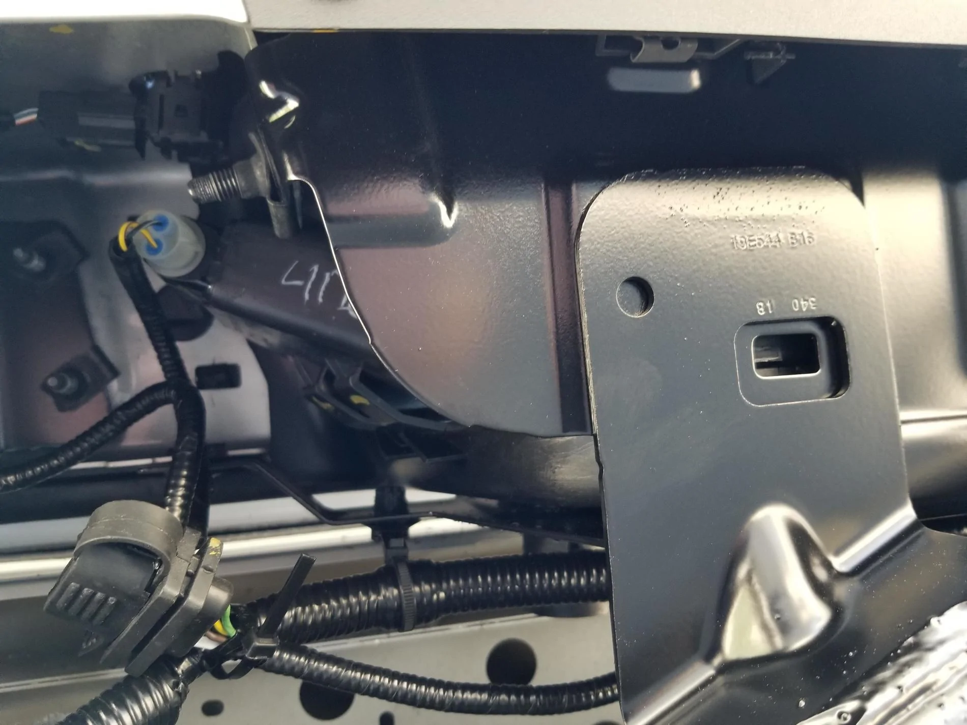

Awesome! Hope it works out. I found a receiver, now I need the wire harness. If your dealer is willing to give you the part numbers they used, please post them. Would also be cool if you could get a few pics of the wire harness connectors before and after :)

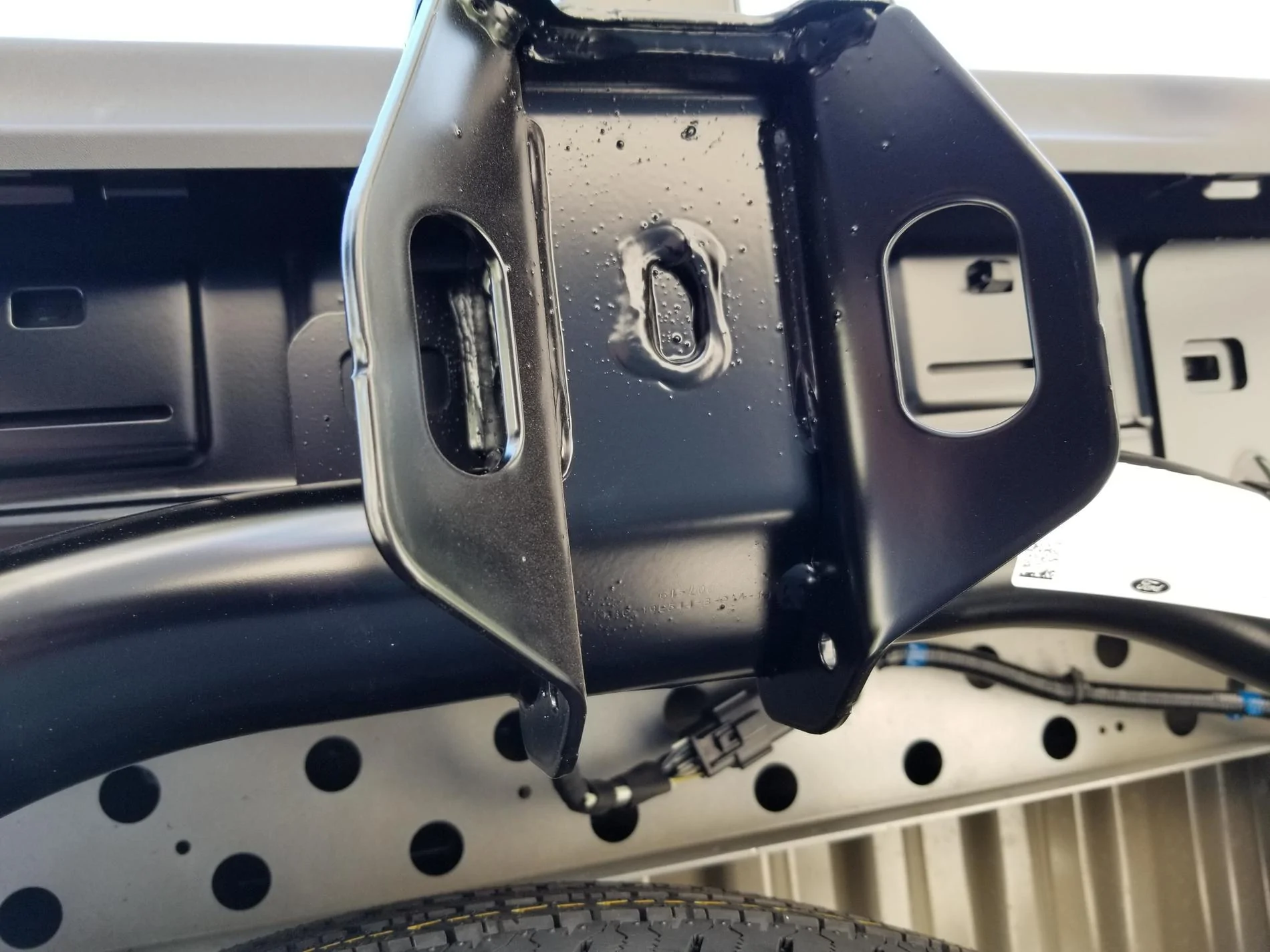

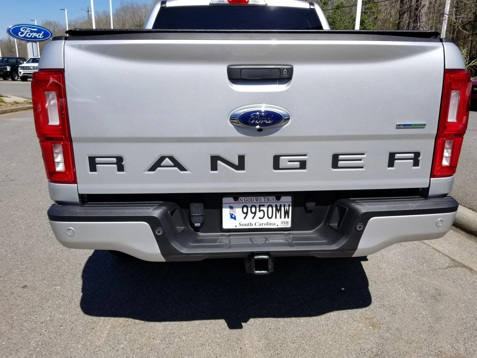

Hitch installed. The only issue is the 4 pin to 7 pin adapter is back ordered.

Yeah, it looks like the part number for that wiring harness is, KB3Z-15K868-D (with back up sensors). It's on national backorder until 04/22. It's probably the same situation that the engine covers that went on backorder because of "unanticipated demand".
