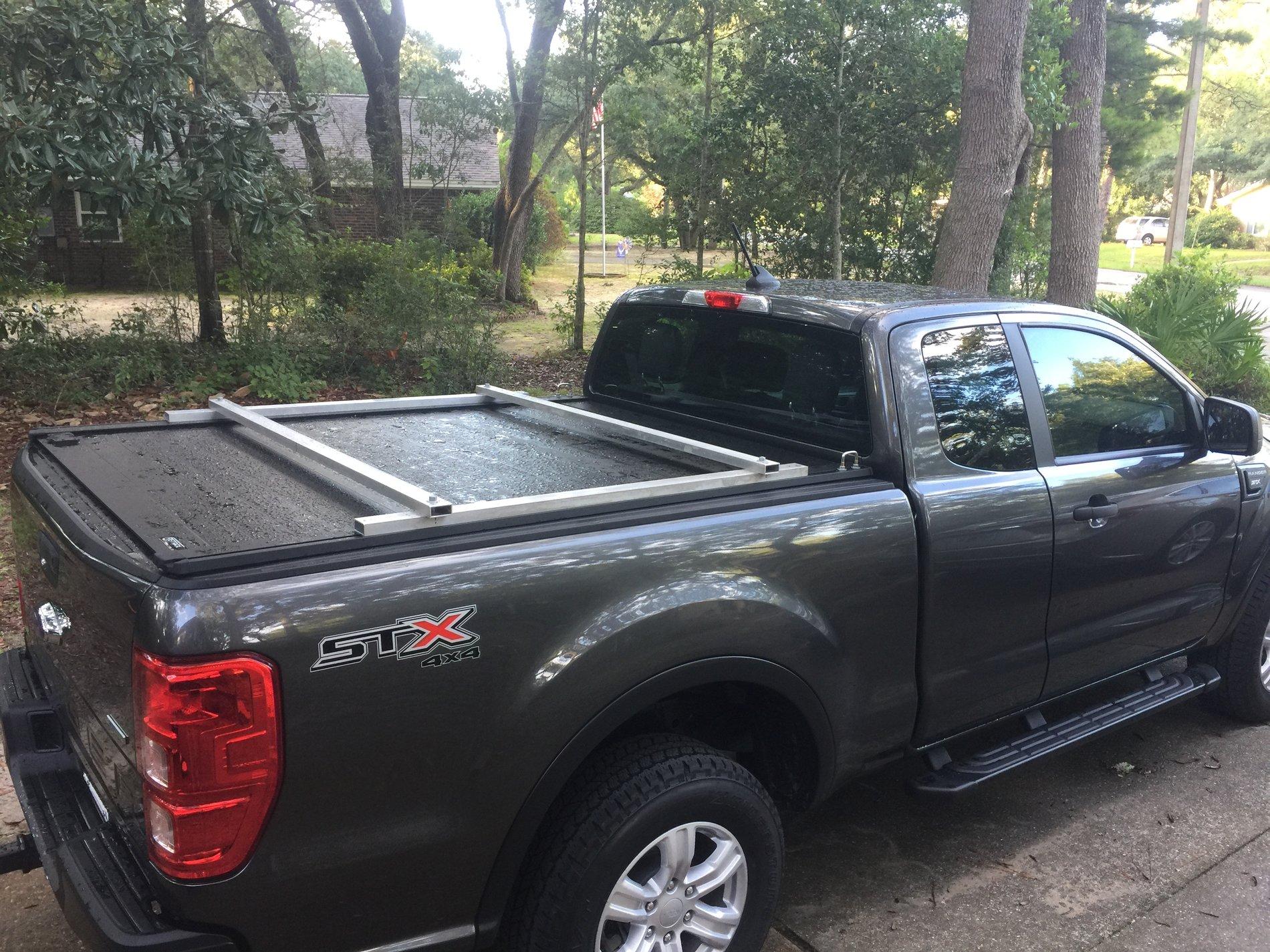

Here is the prototype photo of my set up. Just so happens that 3/8-16 carriage bolts make excellent fasteners for use with Retrax T-slots.

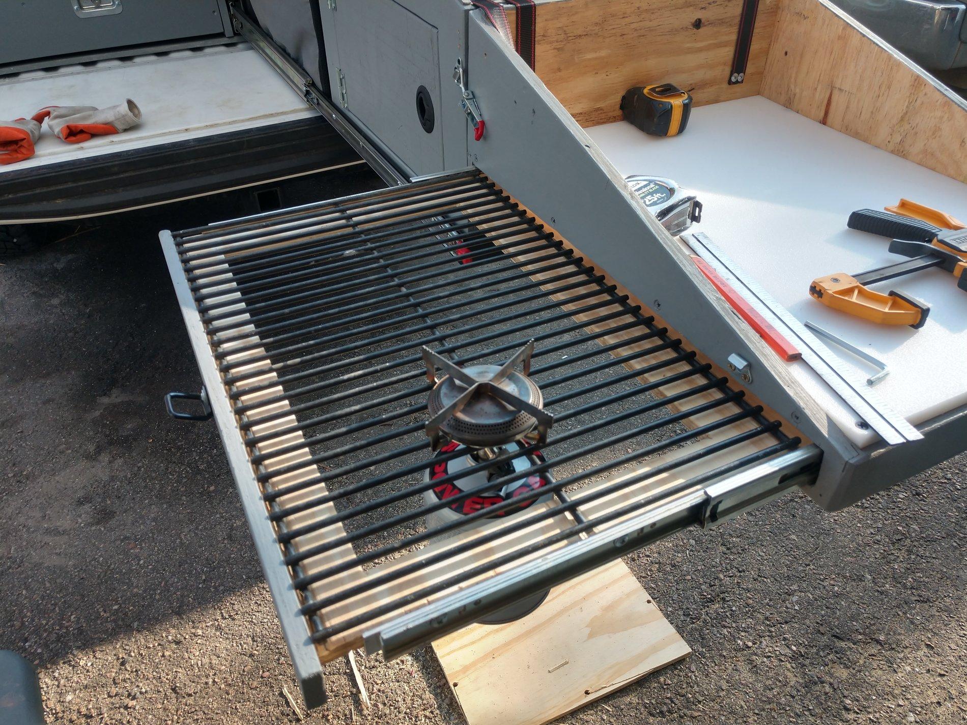

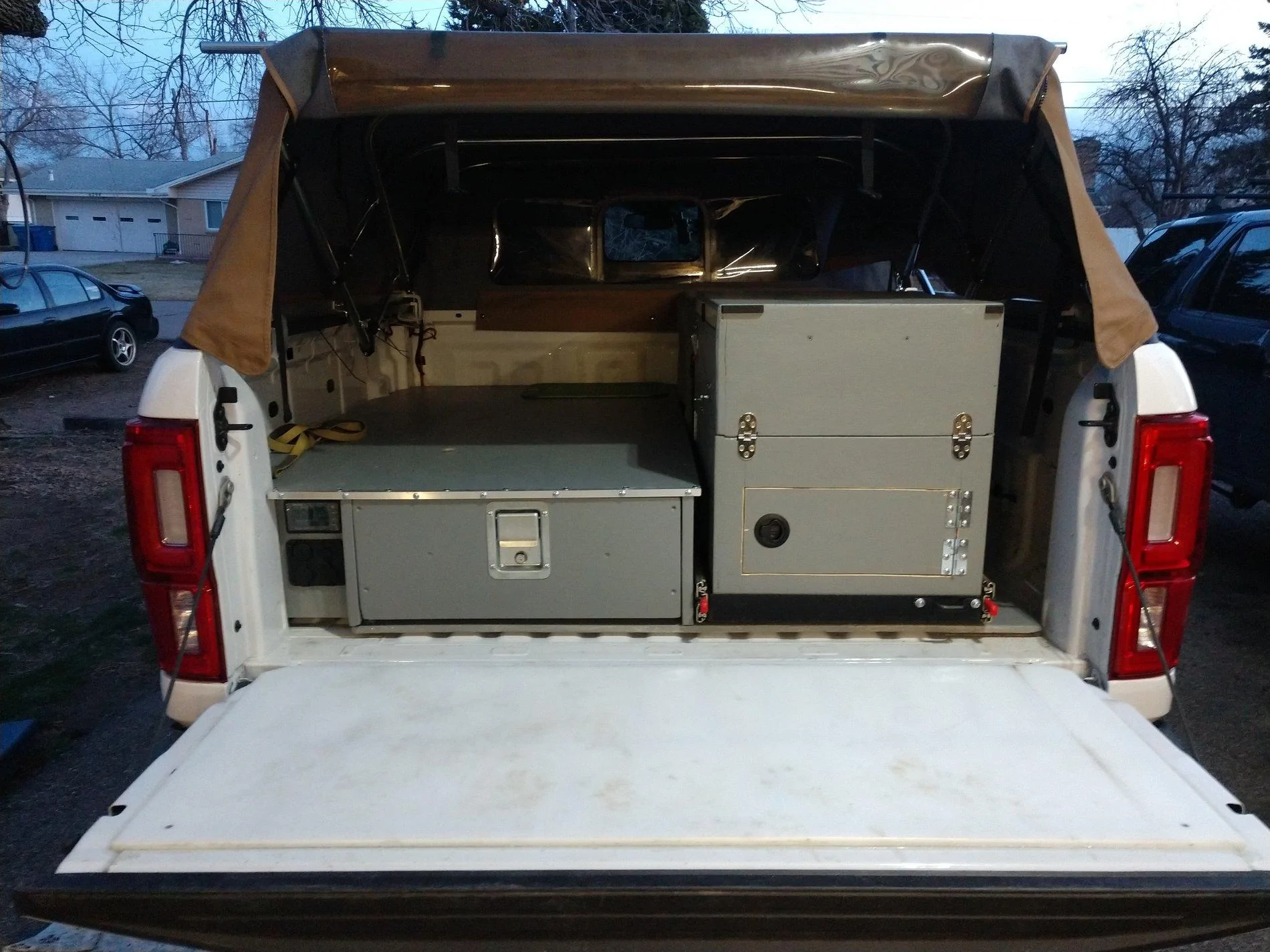

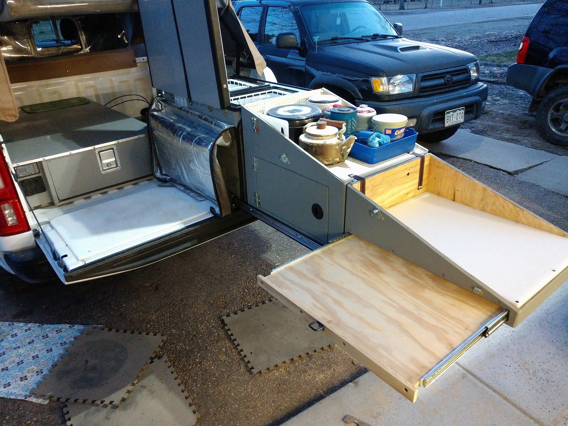

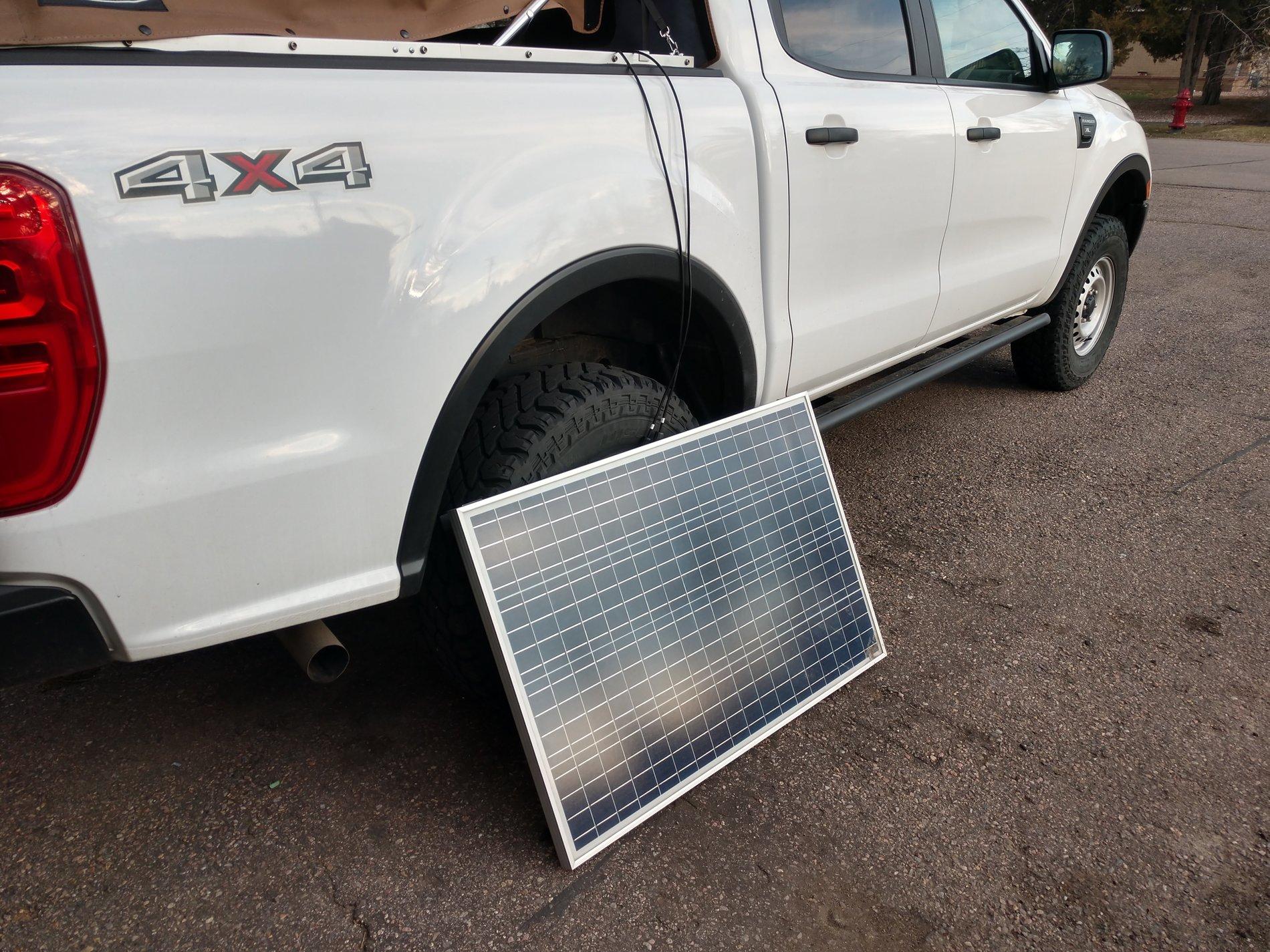

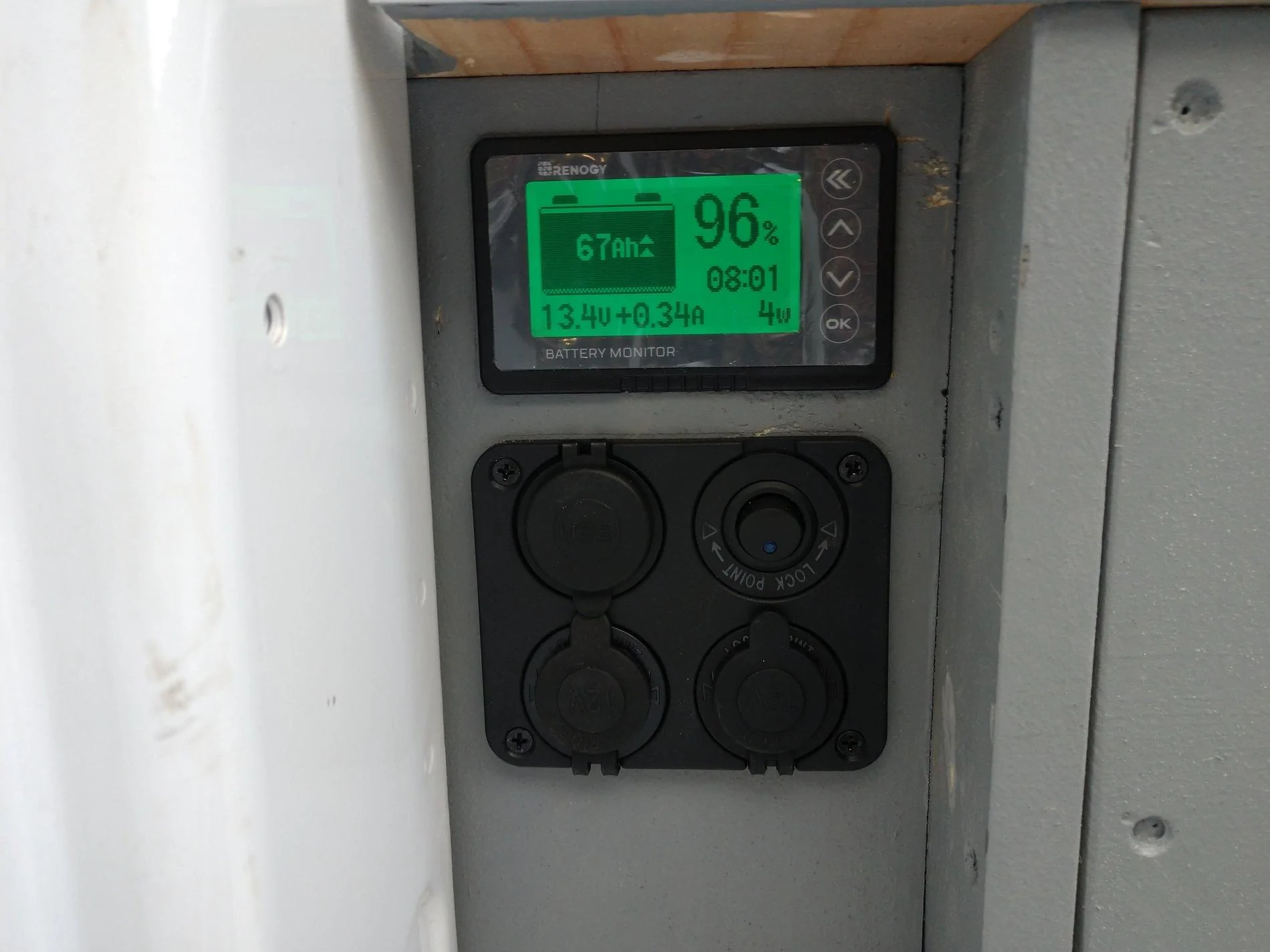

This is the setup I've been working on. it's just about done, but have a couple more details to do.
Pull out kitchen/fridge on the right, low storage drawer on the left. For some reason I don't have a picture of the drawer open, and its snowy so I don't want to go outside right now. But it holds my tent/air mattress, camp chair,tarps, large pots/pans, hammock, and a bunch of other stuff. everything except my bulky sleeping bag. Also at the front there's a spot to store the electronics - two small batteries, DC to DC charger and solar control panel and fuse panel. lower half of the kitchen box is the food pantry. and the entire tailgate is cutting board material.
Also the fridge is accessible from the side of the vehicle so you can just open up the softtopper to grab a drink or snack instead of sliding out the whole thing.
I also designed it with the idea one person could sleep on top of the storage box, though unless you're really short you need the tailgate down and a cover over the end, though I intend to sleep on the ground in my tent most of the time. My dog rides on top of it normally.
Real nice setup, is your storage drawer custom made?

How is the whole drawer system fastened to the bed underneath?

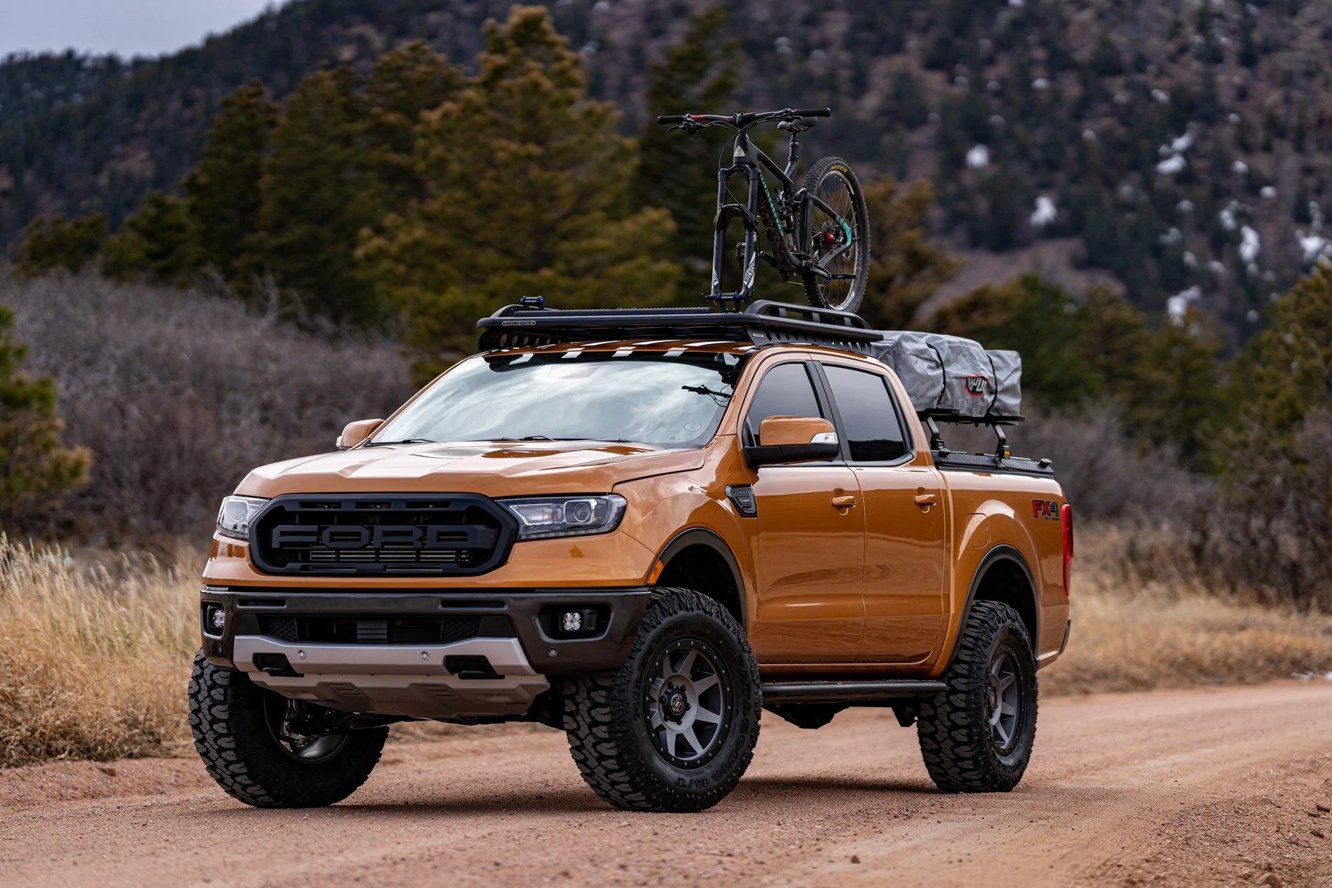

Leitner designs rack (with a lot of stuff attached and rtt up top). So easy to use, super strong, super functional and my bed is completely open for stuff. Only downside...not cheap, but you get what you pay for imo.
I ended up just drilling 4X 3/8" holes through the bed and just bolting a sheet of 3/4 plywood (that I coated with epoxy) straight through with some big fender washers underneath. the bolts also go through the metal brackets that attach the sliders for the fridge/kitchen.
I figure the holes should be small enough (and are very evenly spaced) that if I remove the setup in the future I can just pop in some plastic plugs and they will be virtually unnoticeable.
