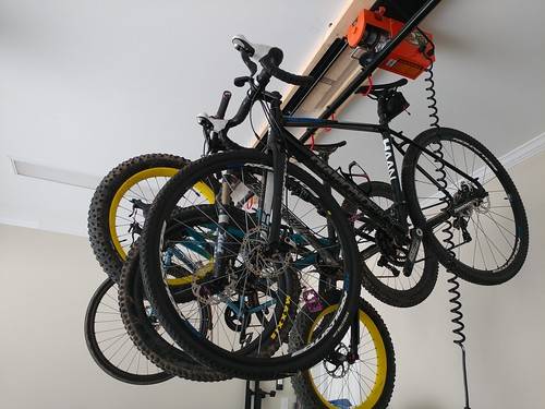

mtbikernate
Apr 13, 2020
1,082
2,381
NC
2019 Ranger XLT 4x4
I thought about attaching a hoist to the ceiling using a 2x6 as its base lag bolted into the joists. I even saw this video but I do not have a tall ceiling and the garage door takes up a third of the ceiling space when open.
I have a similar product I bought years ago called the Garage Gator. It's now owned by "Pro Slat" but I bought mine when Garage Gator was its own company.
garage gator 2 – Proslat US
The weight limit is 220lbs. Which is fine for bikes and other stuff like that, but it's not a lot otherwise.
