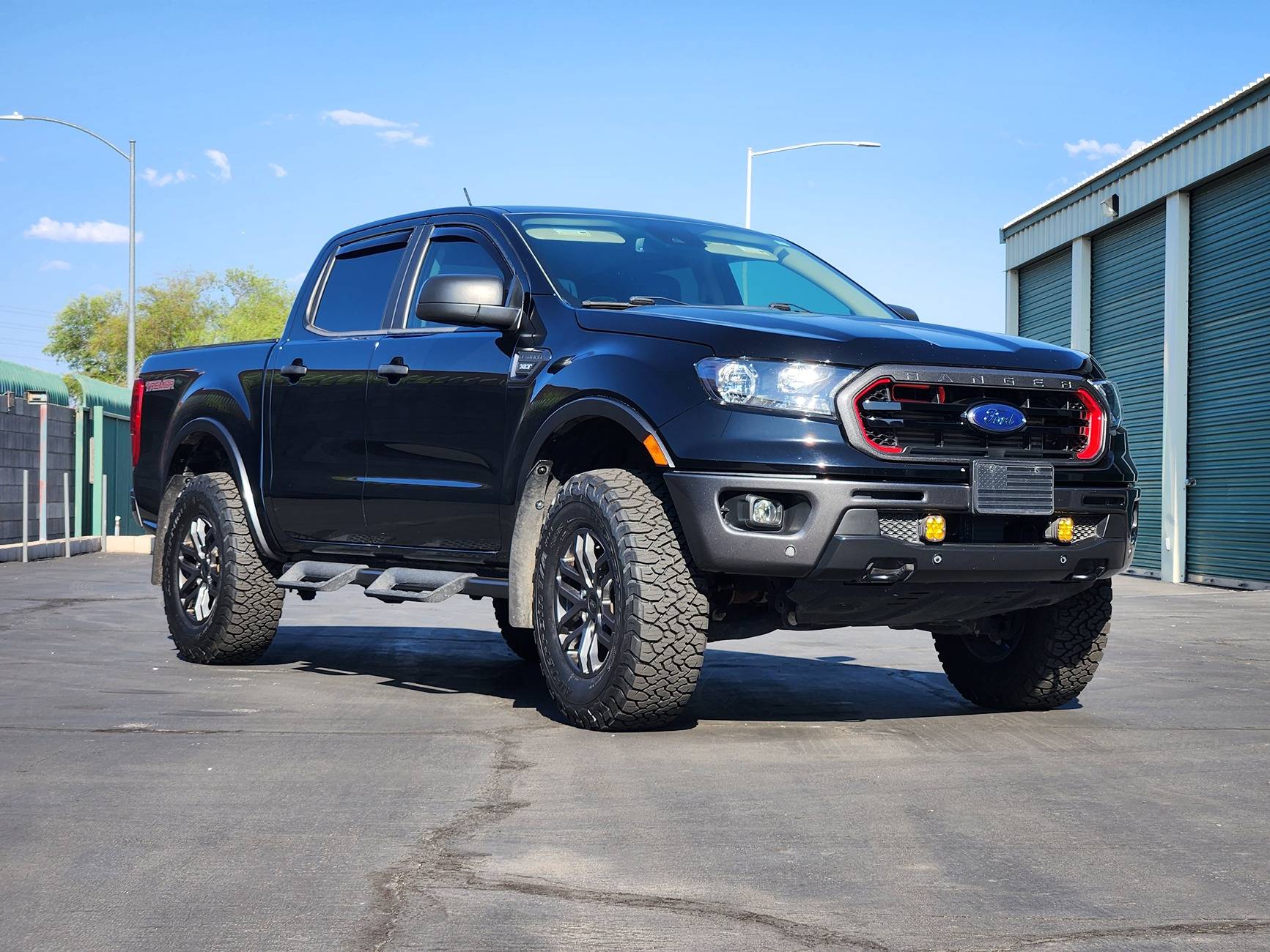

Since your goal is to basically level the truck, I think the front spacer/level will be the better route.
1" technically still keeps the back about 0.5" higher but it looks clean (when measuring the wheel well opening).
The Tremor has a nice multi leaf spring unlike the normal Rangers. I wouldn't want to mess with that setup to get the truck level.
The 2" levels will create the optical illusion that it is level because the way the hood slopes down but if you measure at the wheel well opening, it is higher in the front.
Some have done the 2" front level with 1" rear block too.
When I had it aligned after the 1" level, it technically did need an alignment but it was JUST BARELY out of spec.
I just have a 1" level, 1" wheel spacers and 285/70/17. Only mod to make the tires clear was to remove the crash bars.
