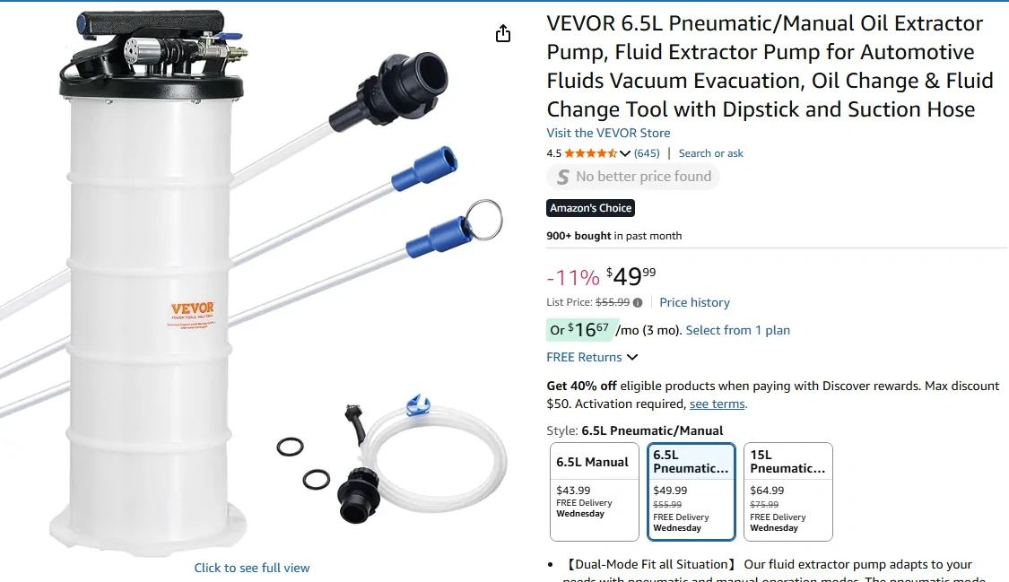

I too have done the electric pump, but I've since upgraded to one of these:
I use the air compressor vacuum option, but the hand pump works fine as well. Neater, cleaner, and less hassle than the electric pump.

Well then, I think you should be fine. I also don't like the idea of not being able to check the fluids. It's a quality piece and worth every bit the price.
I have one similar that I got from harbor freight. It was a open box that was discounted. I don't think mine has an air compressor option. It doesn't take long with the manual pump and like you said, it's an all around great option.
