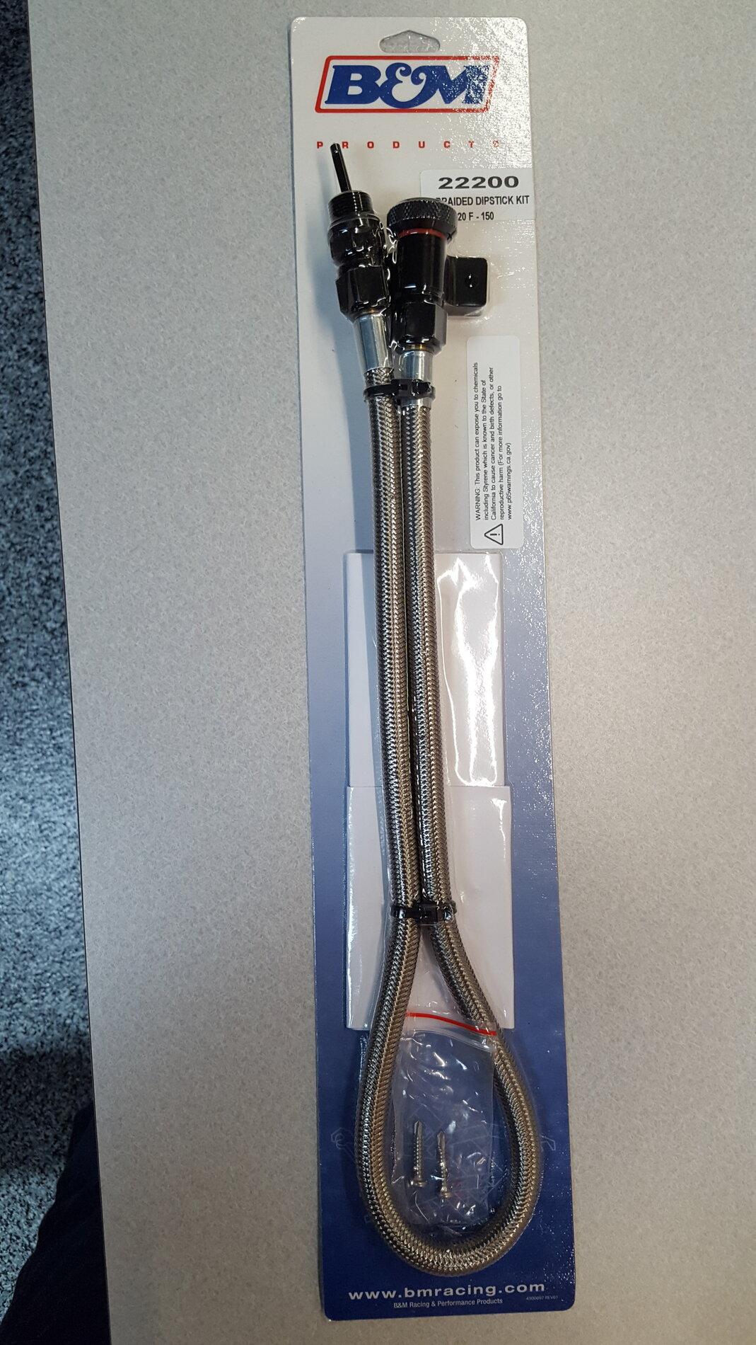

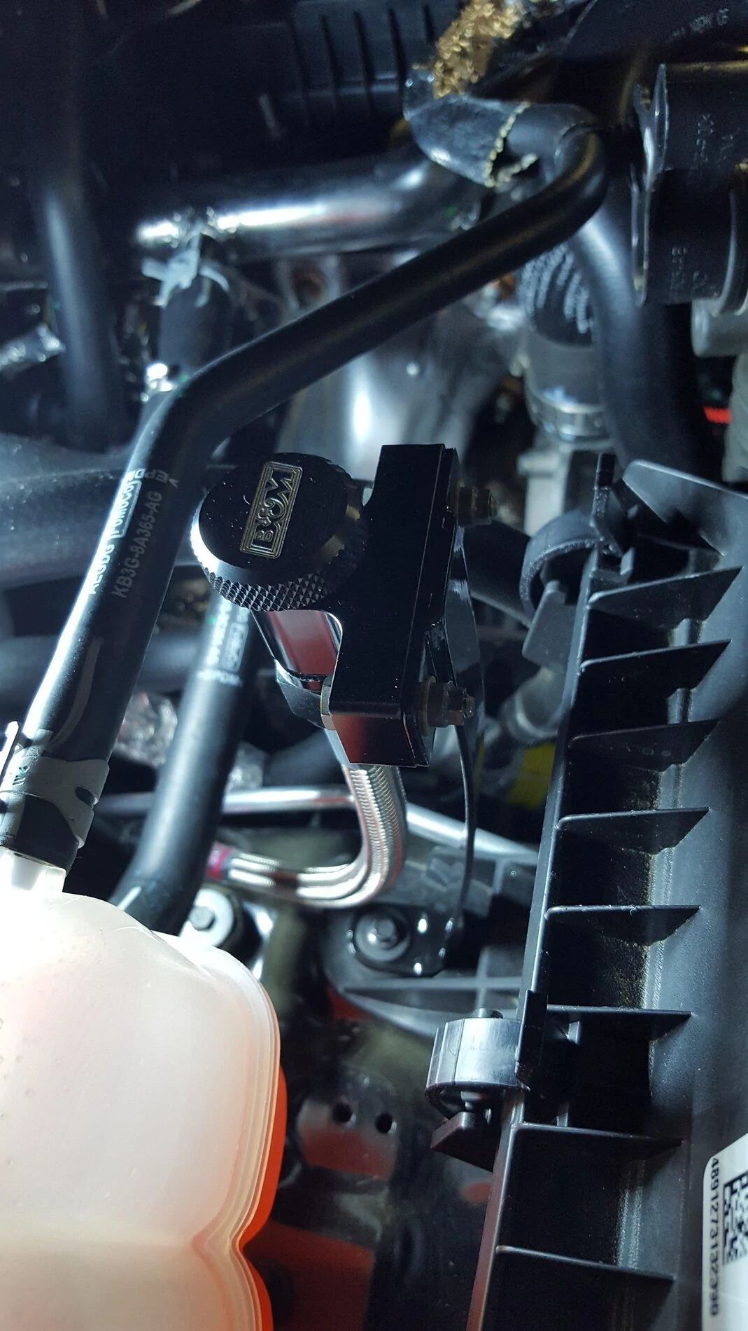

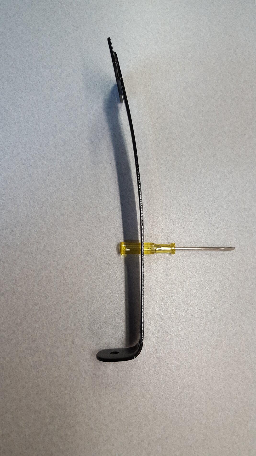

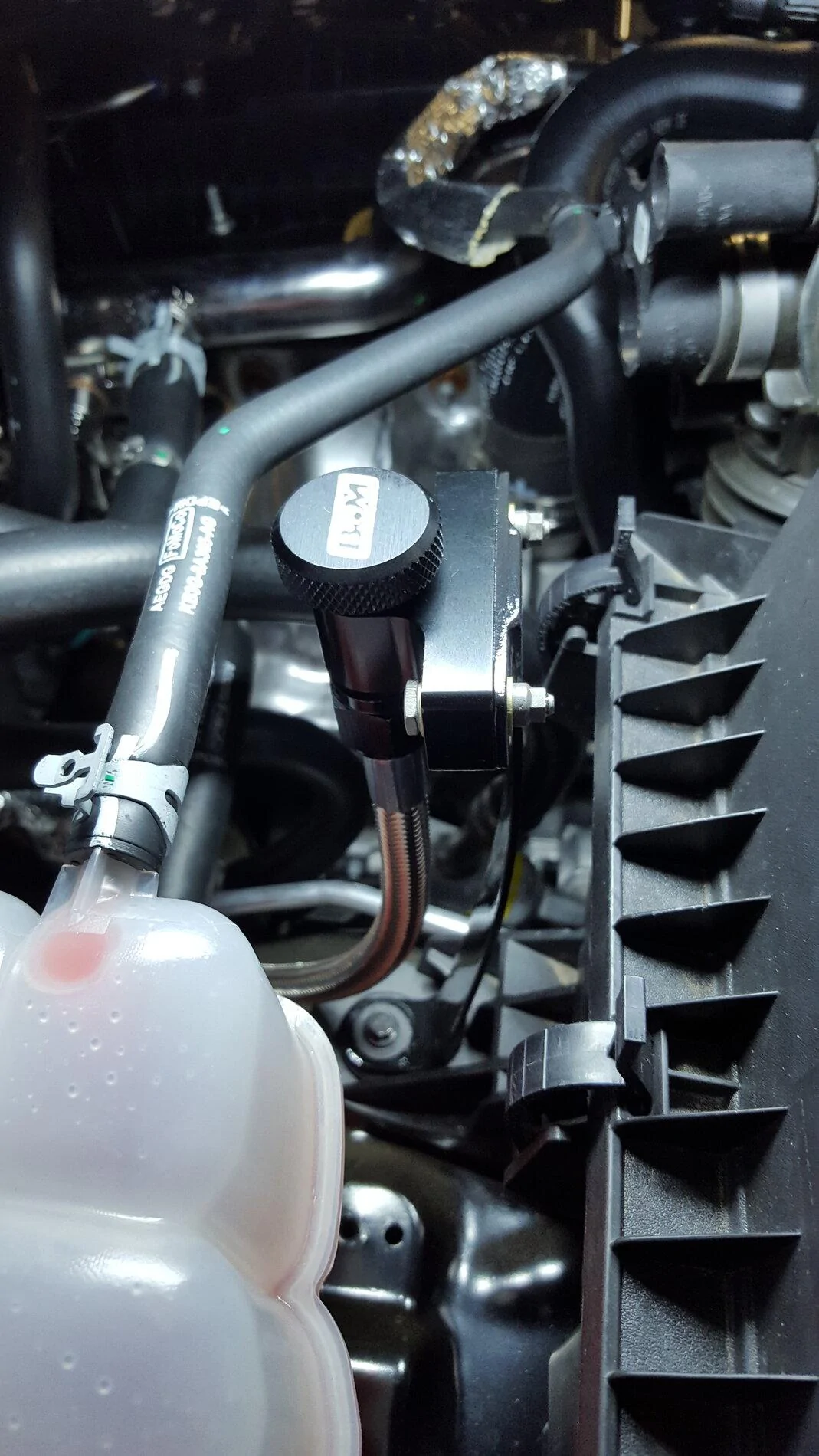

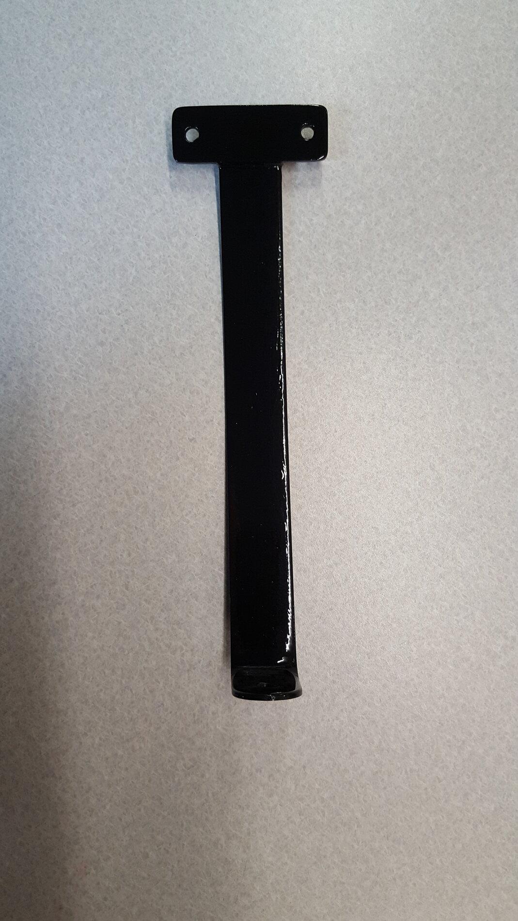

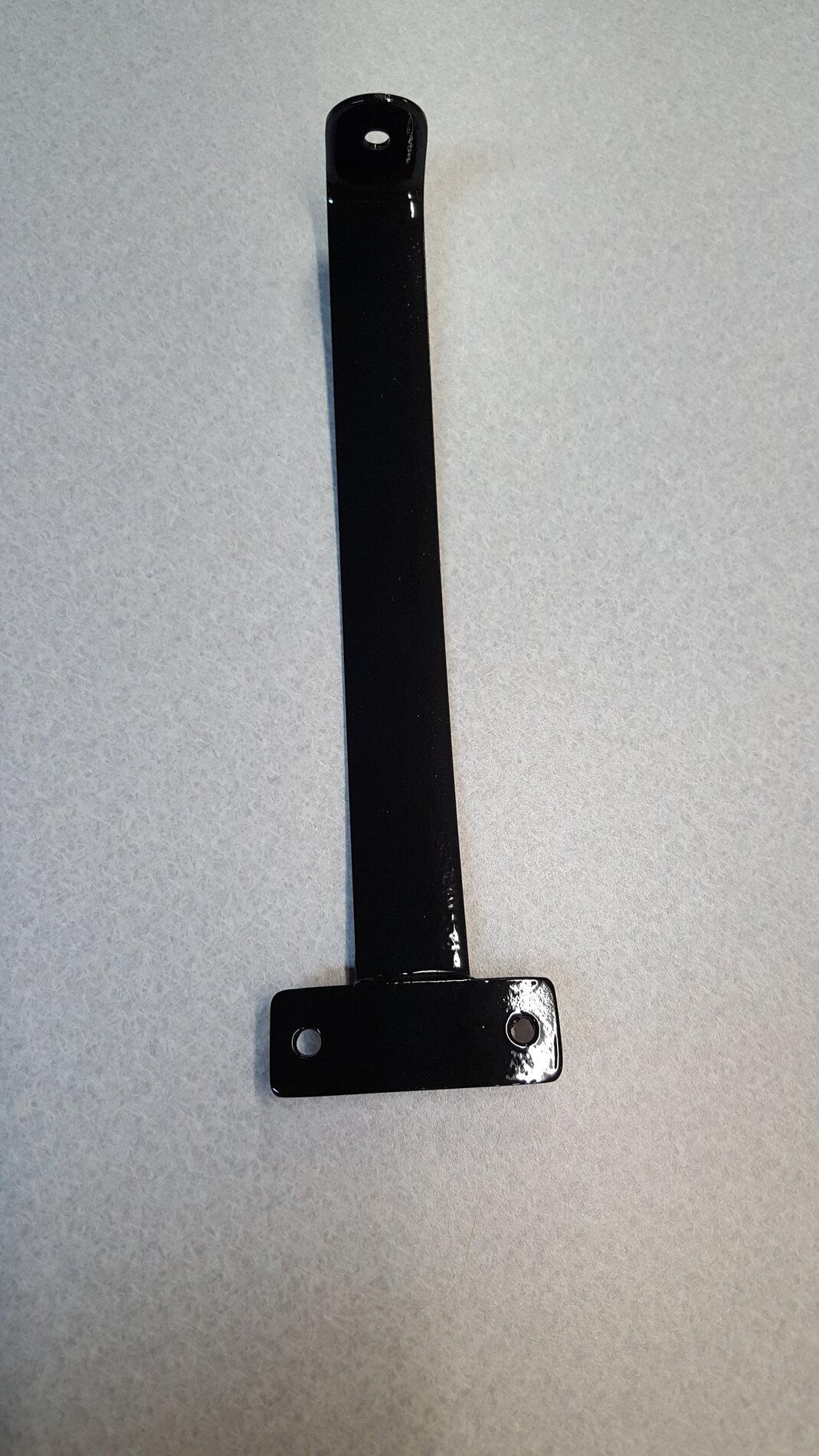

Ok people you may have seen some of these out there. This is a B&M Tranny Dipstick. It calls out for the F150, but fits other vehicles as well. And fits the 4R70E, 4R75E, 6R80 and 10R80 transmission. I installed this on my 2019 Ranger, fits great works perfect. I made bracket out 1' wide 12 gauge steel. I mounted it in between the coolant reservoir and the air cleaner box. And I put a heat shield sock on it down around the exhaust. No interference with access to anything. Here is some photos.

Who knows what happened with the pictures but I lile the idea of this dip stick over the factory one!! Now to get a pan with a drain plug!!!!!
