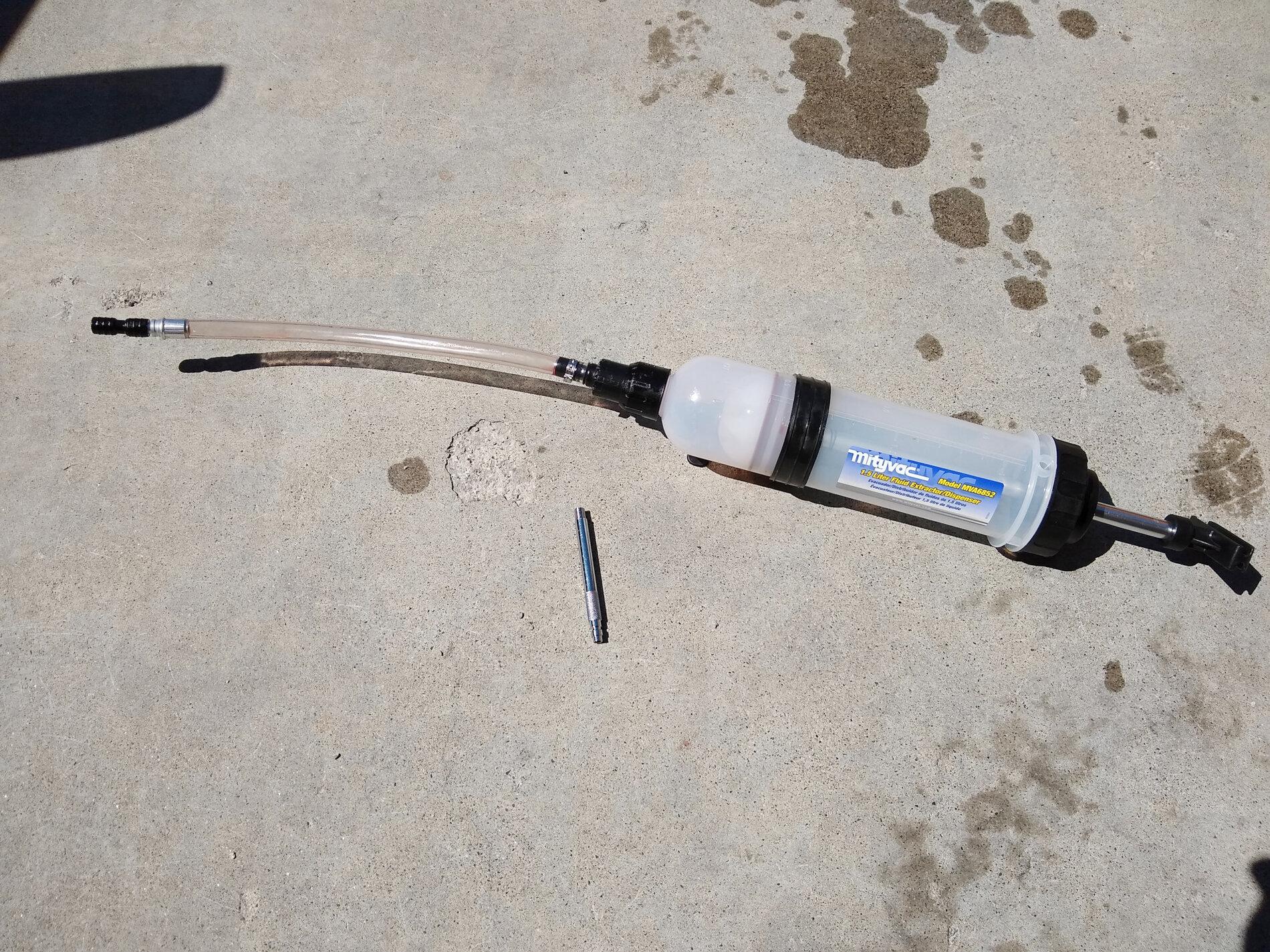

The plastic pan is definitely a nuisance since like you, I would be nervous trying to install a drain plug in it. I haven't looked for a metal one but that's not a bad idea. Here's what I did just this morning, though, in case it makes life easier for anyone else:
First, pick up a set of these (Mityvac 1.5-L manual evacuator + the Ford-specific fill/drain tube extension):
Because there's no long dipstick and fill tube, it helps to have a little extra maneuvering room under the truck, so I put the front on ramps and raised the rear slightly with jack stands making sure that the rear wheels stayed on the ground for stability. The truck should be fairly level, but it doesn't have to be perfectly level because I used relative fluid level measurements, not the procedure in the manual.
What makes this easier than the procedure in the manual is that there is no dropping of the pan, and that the oil level measurements are relative to what they put in at the factory. So yes, there is an assumption that the factory put in the correct amount and that there are not yet any leaks after only 12,000 miles (I'll explain later why I'm doing this at 12,000 miles).
NOTE: to do this you need to get intimate with the exhaust system, which runs just inches from the transmission and the fill port, so I did this with the truck cold, having been run only the few seconds it took to get it up on the ramps. I also made sure that the new bottles of oil were at the same temperature as the underside of the truck.
If you engage the transmission to move the truck onto ramps, let it sit for a while so the oil settles, then loosen the cap and use the dipstick inside to measure the existing factory fluid level and remember what it is.
I then sucked out 3 quarts of oil, which is a bit less than what the manual says you should get by dropping the pan, and replaced it with 3 quarts of new oil using the evacuator. I then checked the level, which was off by a tiny bit so I added a little to correct for it.
Put the dipstick and cap back on and you're done. I test drove it for 10 miles or so and it's fine. I'll probably recheck the level again in a day or so.
So why am I doing this at 12,000 miles? According to the manual, if you just drop the pan, you will only be draining 3.5 quarts of oil (out of 12). My plan is to remove 3 quarts (about 1/4 of the total) and replace it with new oil every 10-12,000 miles. That's not exactly the same as changing all of it at once at 50,000 miles, but based on the manual, you can't do that by just dropping the pan. I think this method is pretty safe since you're just directly replacing oil that is sitting right in the pan, and with the evacuator it's really only slightly more of a headache then changing the trans oil on our '93 Ranger where I installed a drain plug. It will take a little extra time to navigate your way through the first time, but I suspect the second time, it will take me around an hour.
What I probably will do at 50,000 miles is to drop the pan and change the filter, but that will be less painful of a task if you first use the evacuator to remove as much oil as possible.
Note on cost: I was pleasantly surprised that the ULV oil was pretty inexpensive even at the dealer. It was about $6 per quart. After the initial cost of the evacuator, replacing 1/4 of the oil every 10-12,000 miles will cost all of $18 and an hour (+/-) of time.
