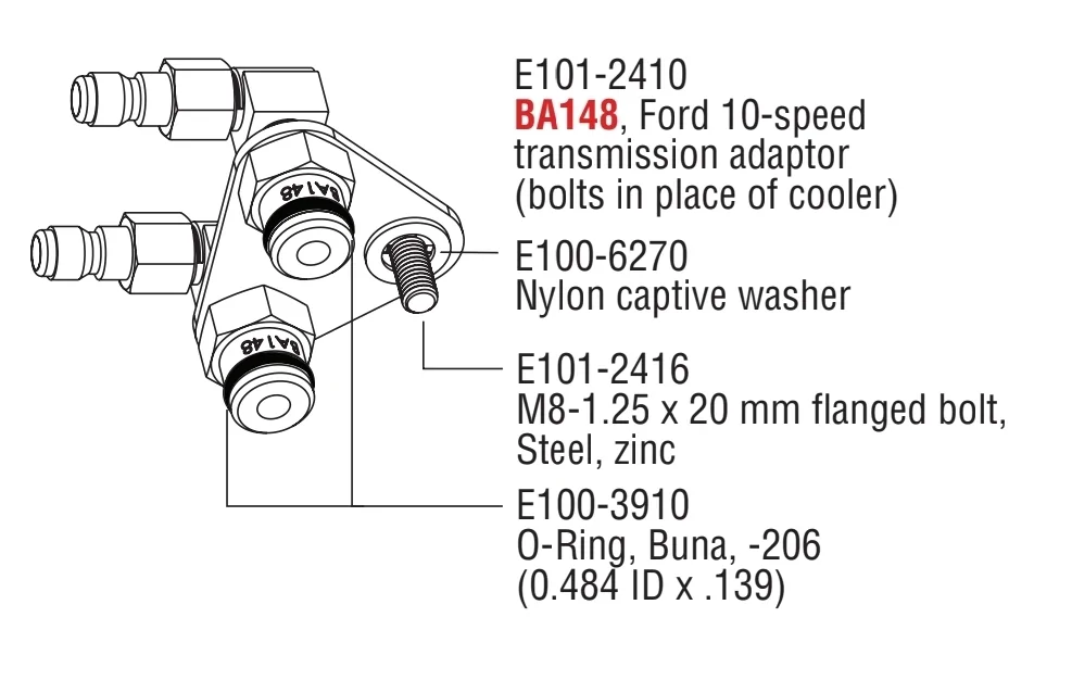

I have my Ranger at a Ford dealer, and I wanted to have them do the transmission fluid exchange, but they say they can't because the transmission cooler is mounted in the trans and doesn't have lines on it to do the fluid exchange. How are services performed on this transmission? I know you can drop the pan and get that fluid out and then refill, but that will leave all the old fluid in the torque converter. Is there a way to properly service it and get all of the old fluid out?

The cooler is temporarily removed from the transmission and an adapter plate is installed to connect the flush machine. The cooler is then flushed and reinstalled. The coolant lines are not opened.
Thank you! Looks like they need to get this:
