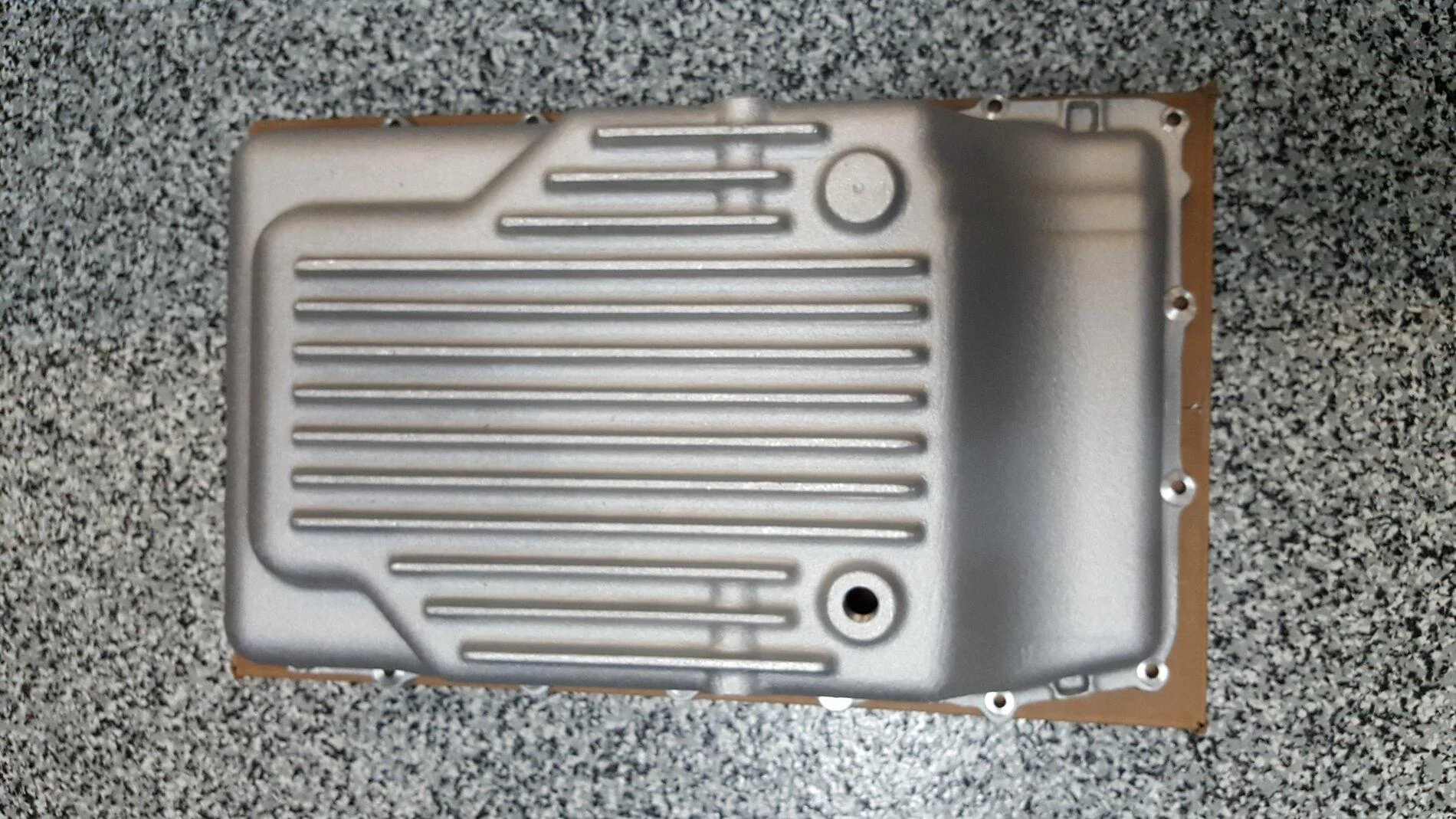

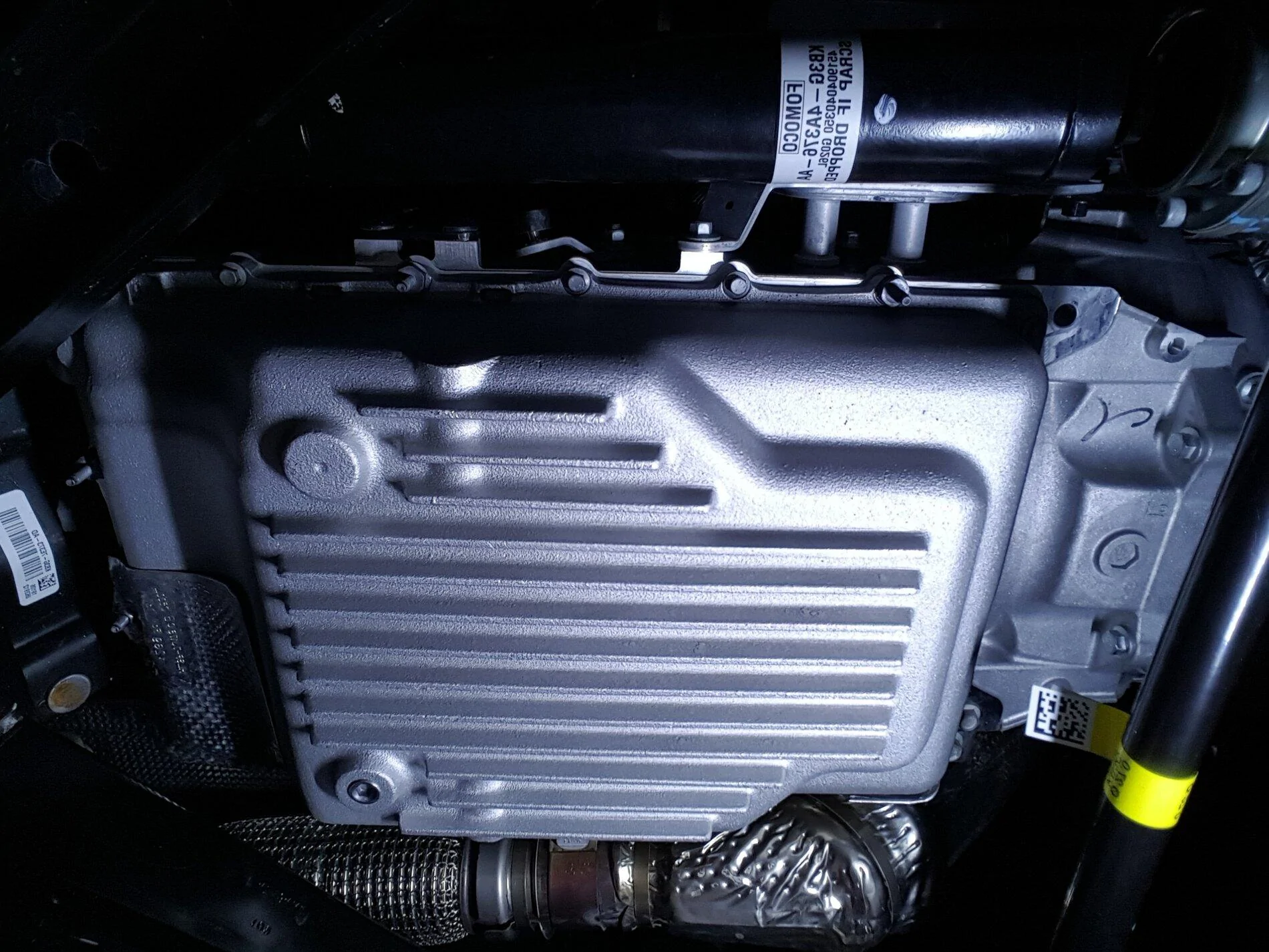

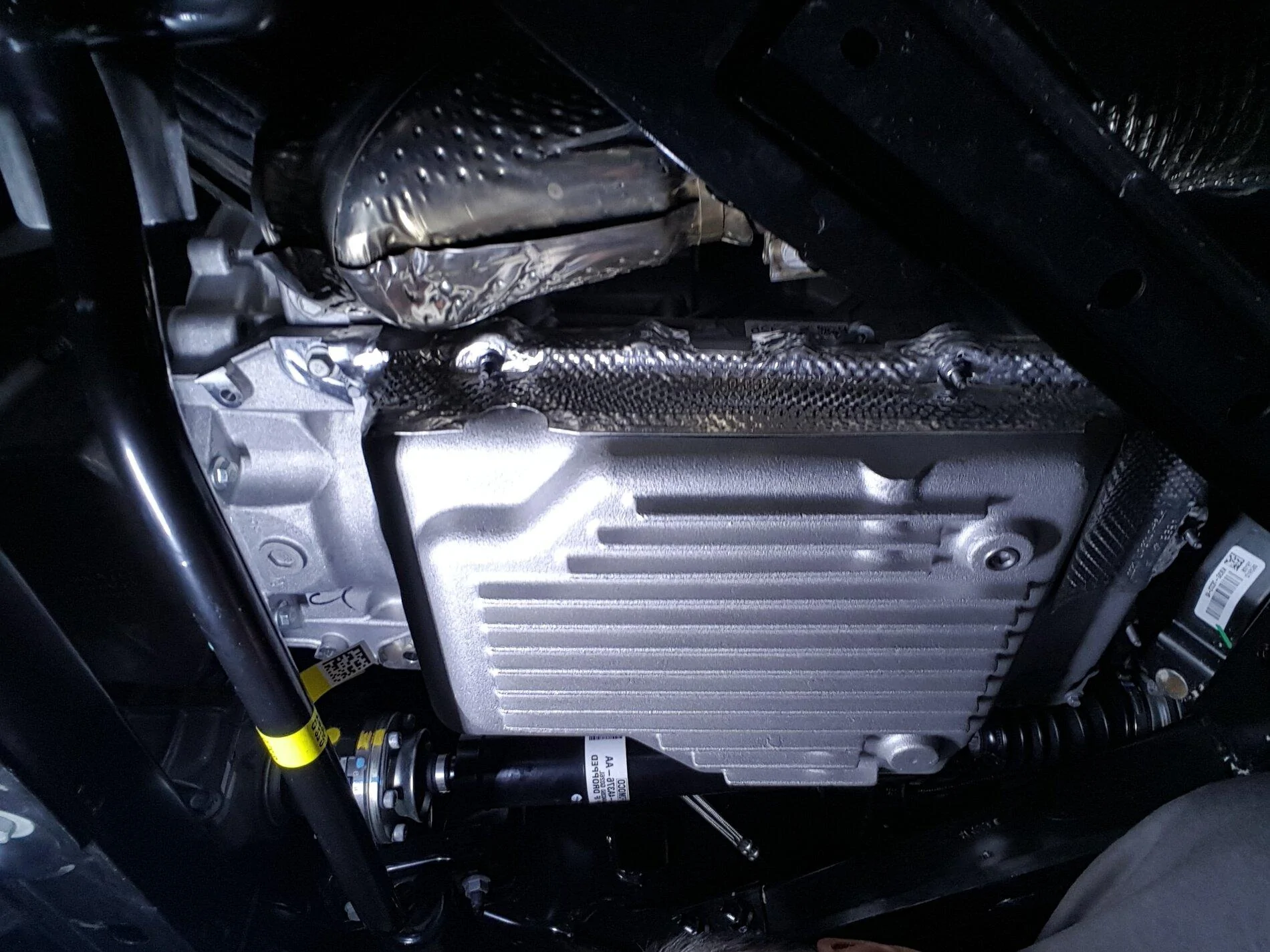

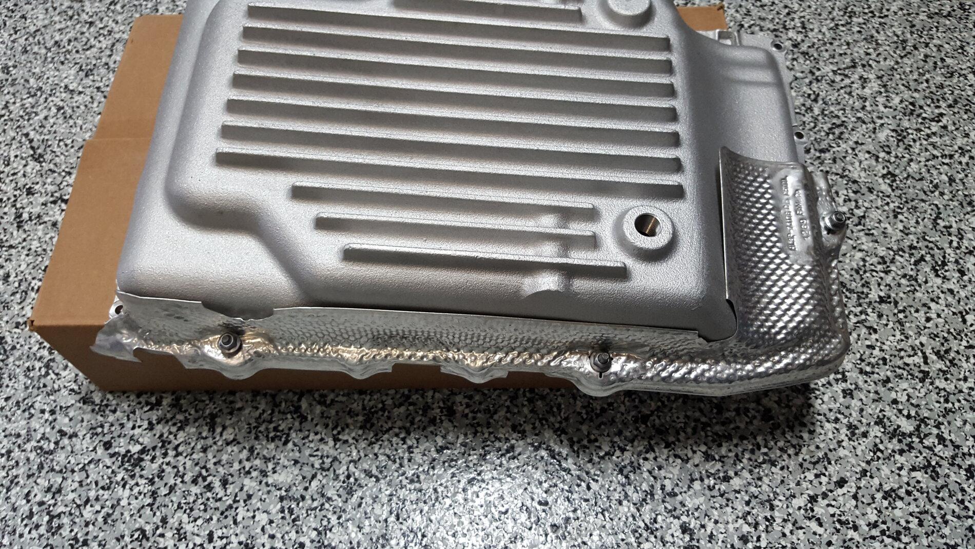

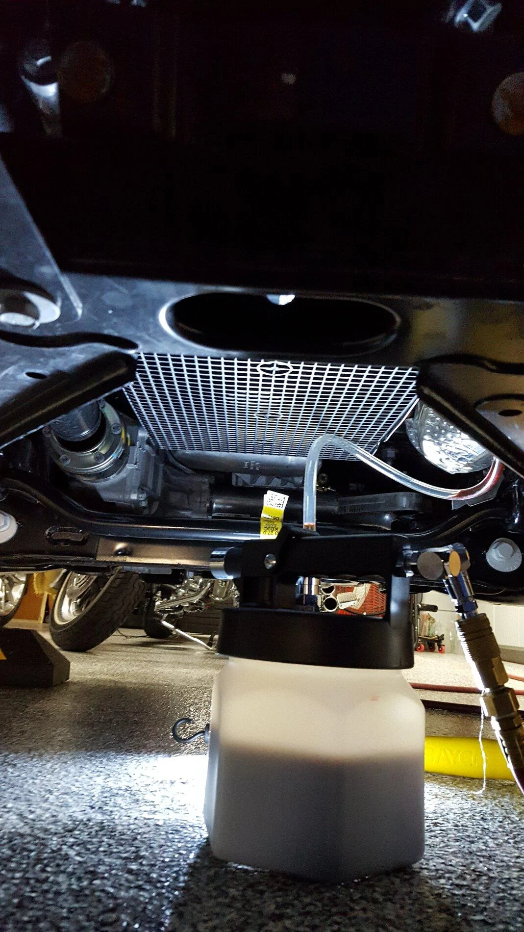

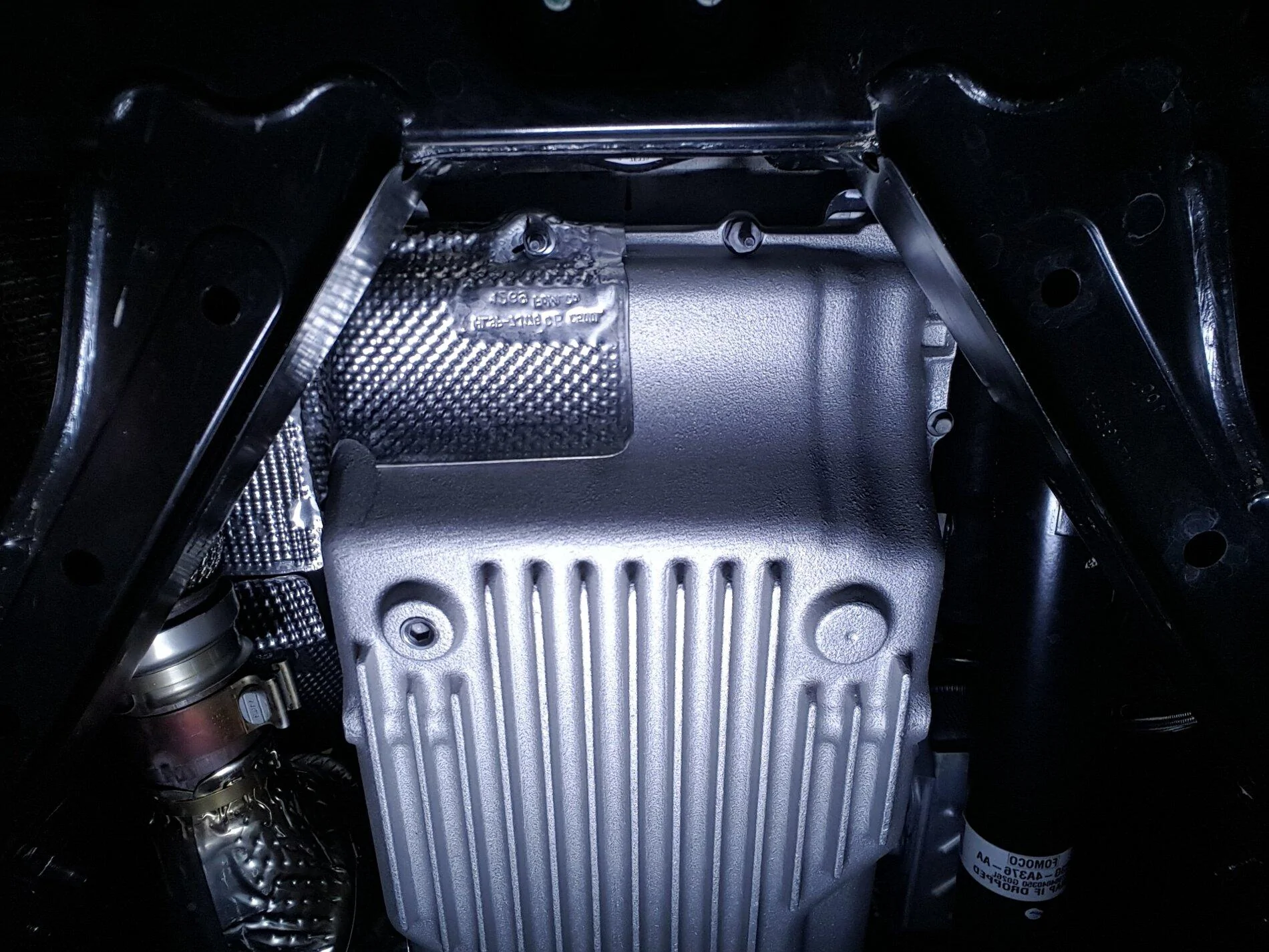

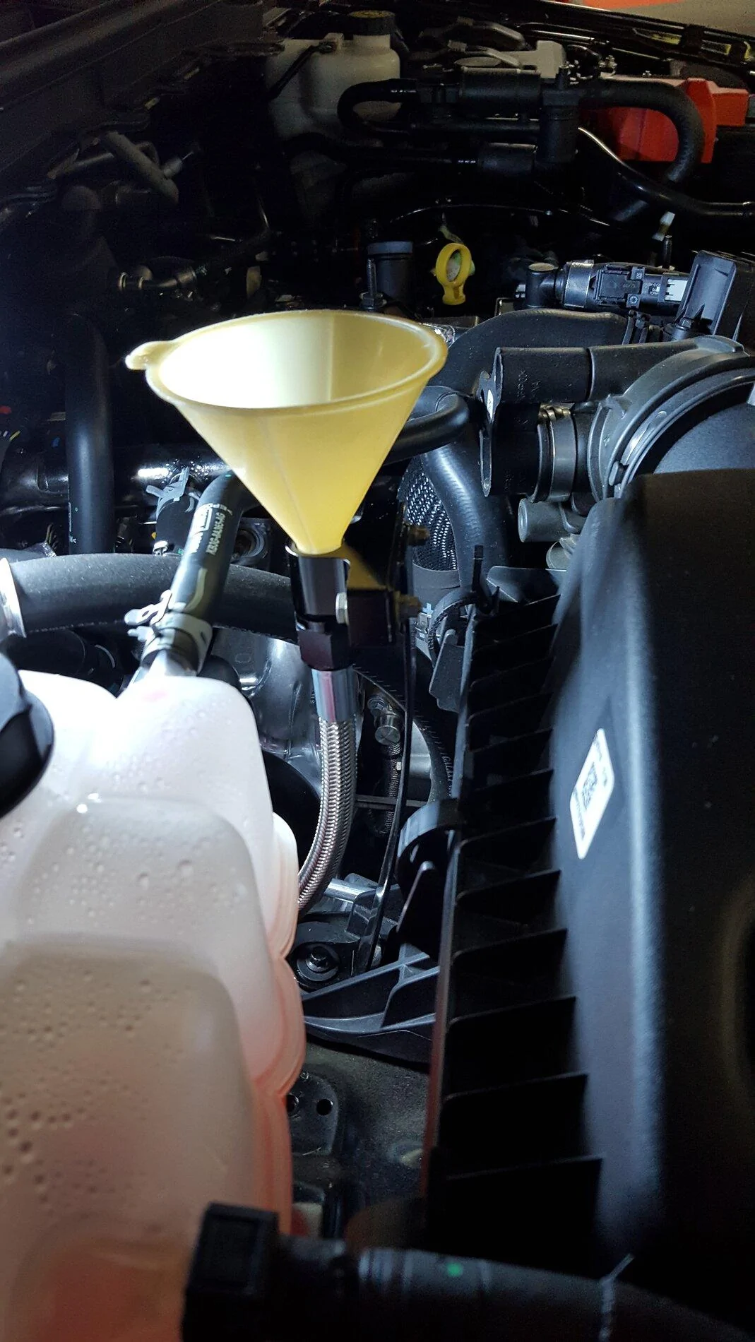

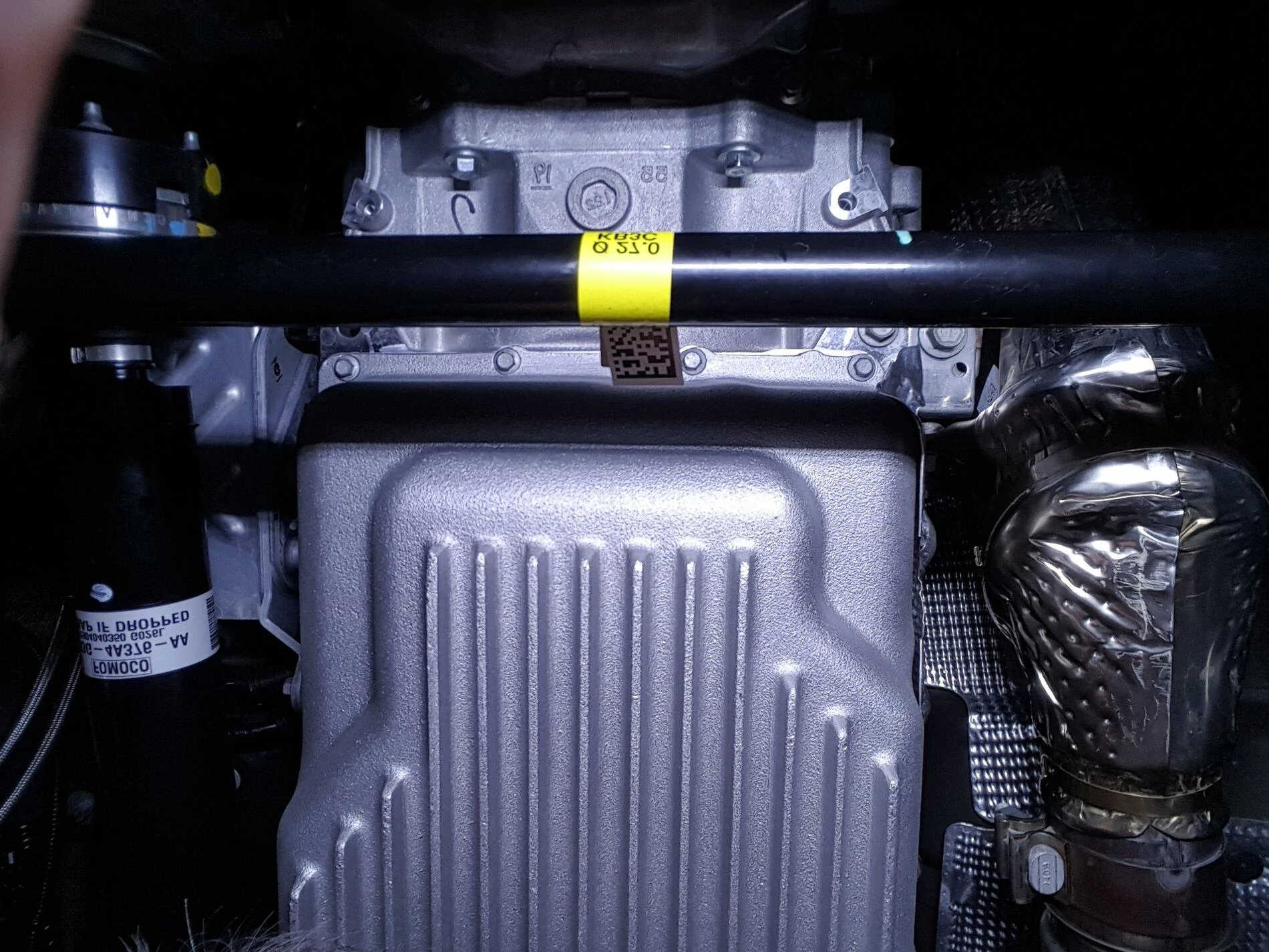

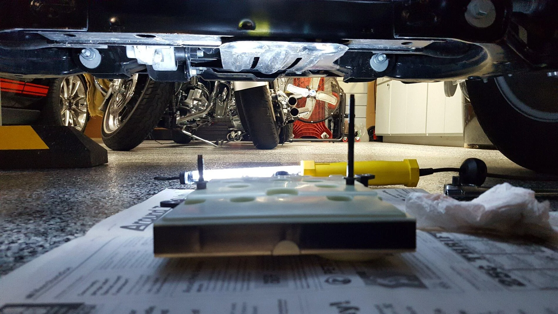

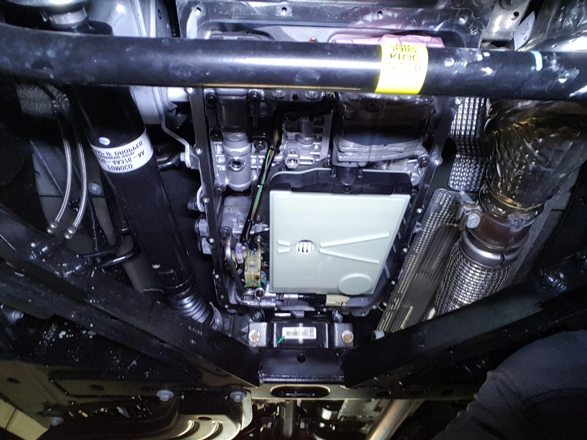

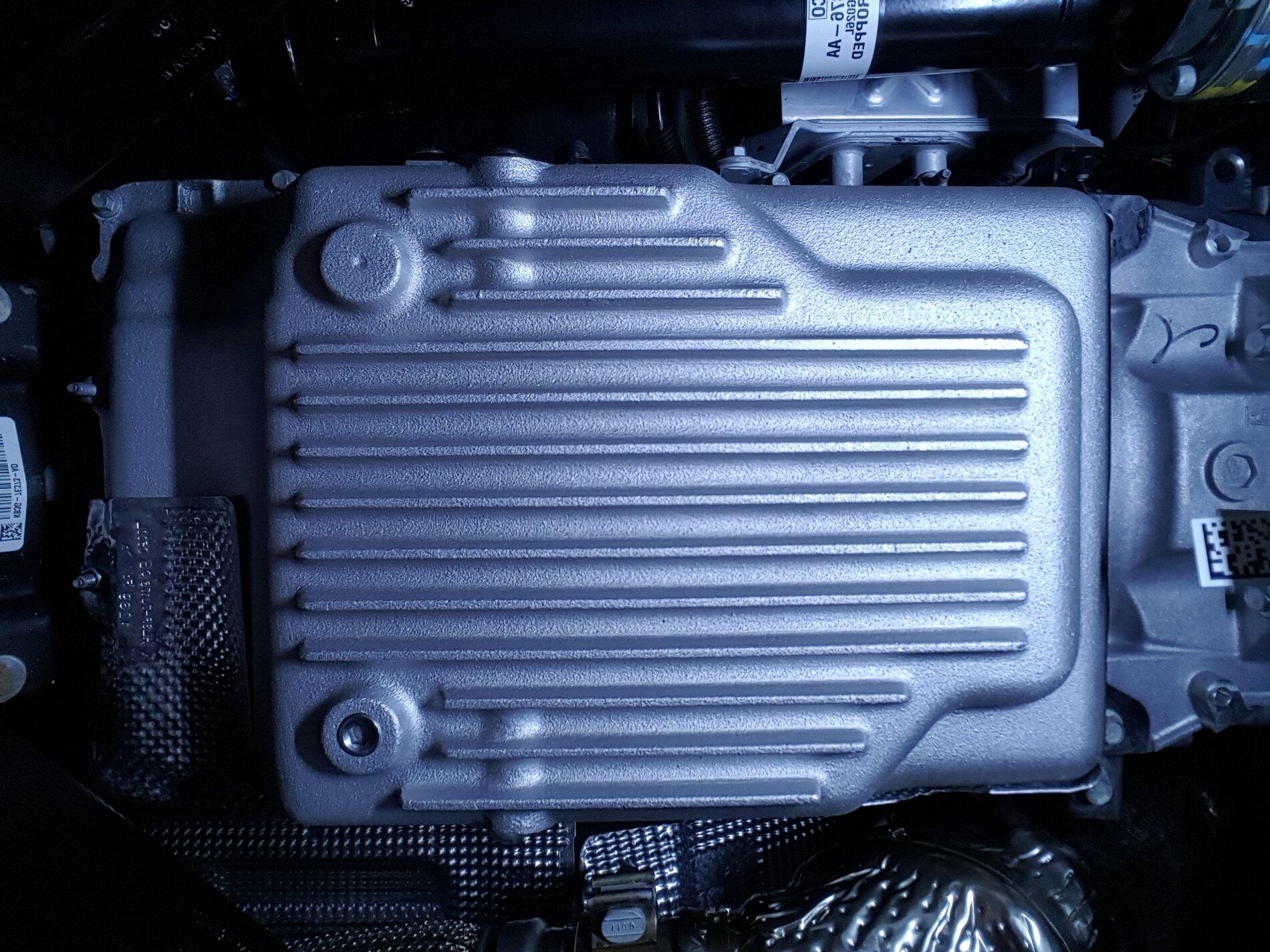

OK here is my new tranny pan from PML and install. This is what I used to VAC out as much fluid as possible. I vac out 7.3/4 quart's, next drop the pan and filter. There was about 3/4 of a quart in the pan an filter. Total removed 8.1/4 quart's. Next new filter install, make sure the long bolt goes on the passenger side. New filter an o ring installed ready for the pan, you can reuses your pan gasket if not damaged. Checked the heatshield perfect fit no modification needed. Pan goes on no problem. Tighten bolts in crisscross pattern, there are 6 stud bolts and 12 regular bolts. Torque the stud bolts to 106 in.lb [12Nm] Torque the regular to 89in.lb [10Nm]. Put on heatshield double check everything and ready for fluid with the new dipstick filler tube. The new pan holds 1.9 extra quart's. I added 9 quart's, started it up let warm up an circulate. I shifted it from drive to reverse a number of times and added another quart a little at a time. 10 quart's added back to normal operating level. Check for leaks test drive everything works fine, check fluid again idling in park perfect. Check for leaks all is good.

So when are you going to start selling that cool mounting bracket?

Probably won't. That's a very simple fab 1" wide 12 gauge flat steel. You can get a 3' piece for about 8 Bucks at Home Depot, Lowe's, Ace. Cut and bend.
