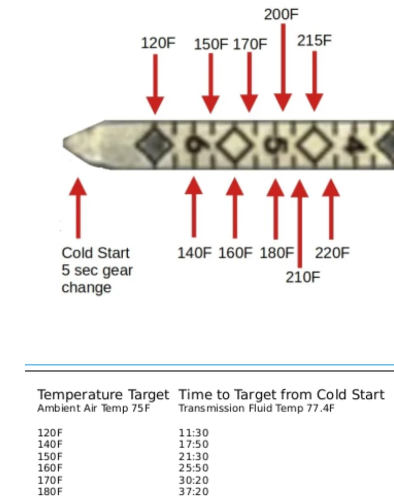

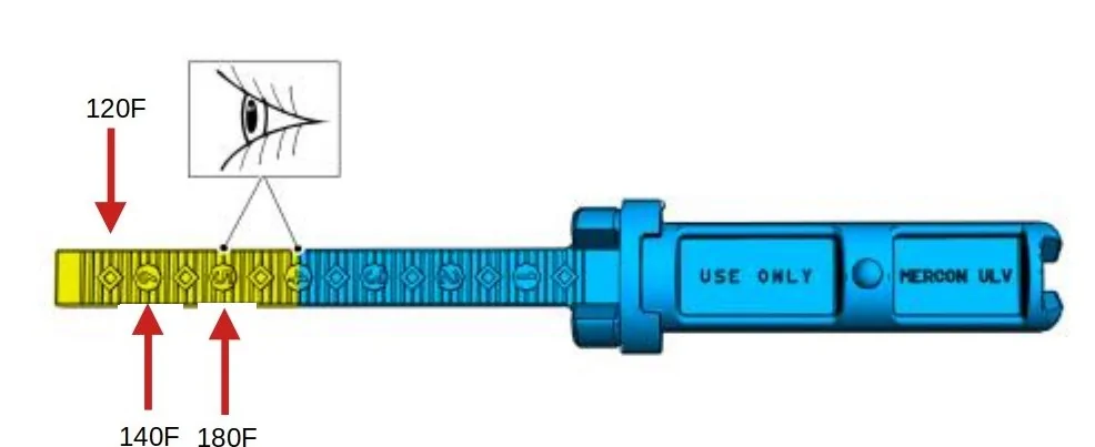

I don't believe the stock dipstick is long enough to check the fluid cold. And if you are following the Ford steps to measure the fluid, it is critical to have fluid in the 206F-215F range and that is not easy to achieve without a gauge.
One Ford mechanic says to start the truck and let it warm up and the fluid to the 5-6 block instead of the 4-5 block. This assumes fluid temp is between 140F-180F. I tested from a cold start and tracked fluid temperatures (see the chart below). On the day this check was performed It was 75F ambient air temp, with fluid measuring 77.4F. The truck has sat in my garage for 12 hours from shutoff.
Time Window for targeting the 5-6 window is 17:50 - 37:20. 160F was hit at the 25:50 mark. Or you can wait 11: 30 minutes and fill to the first diamond (120F)
Here is the Ford Dipstick with the temp indicators on it.
Wait 11:30 to check and fill to the 120F point (the first diamond).
Or 17:50 to fill to the 6.
Or 37:20 to fill to the 5
