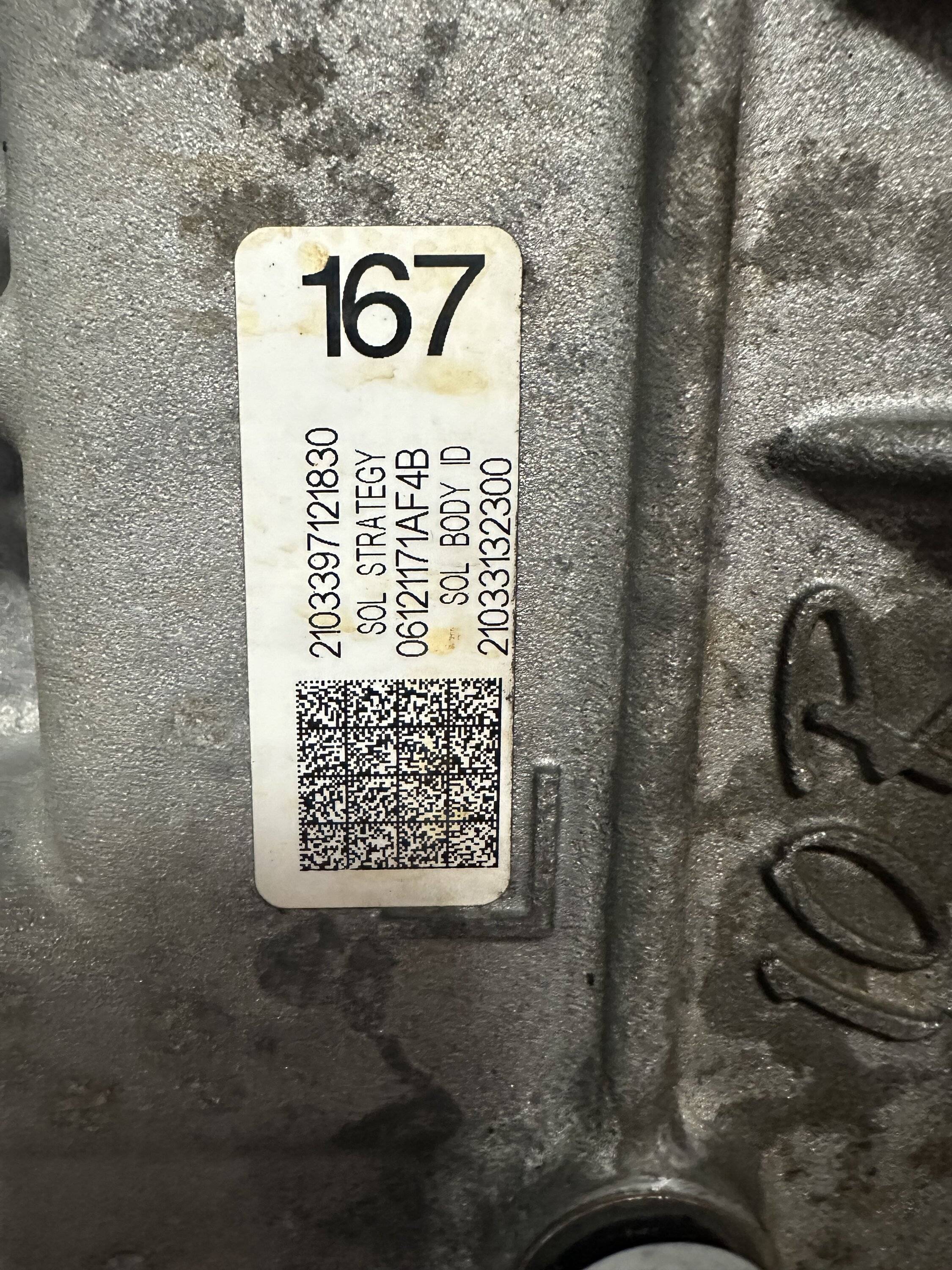

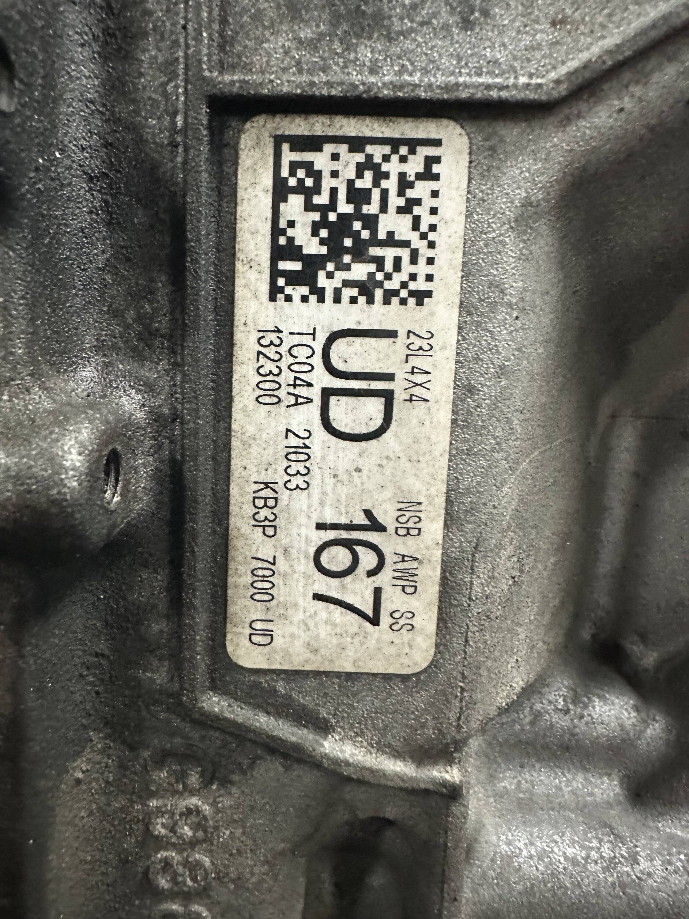

Do you happen to have the part number of the Transmission you removed?Here’s the part number I just installed in my 21
That’s the two stickers on the original.Do you happen to have the part number of the Transmission you removed?
