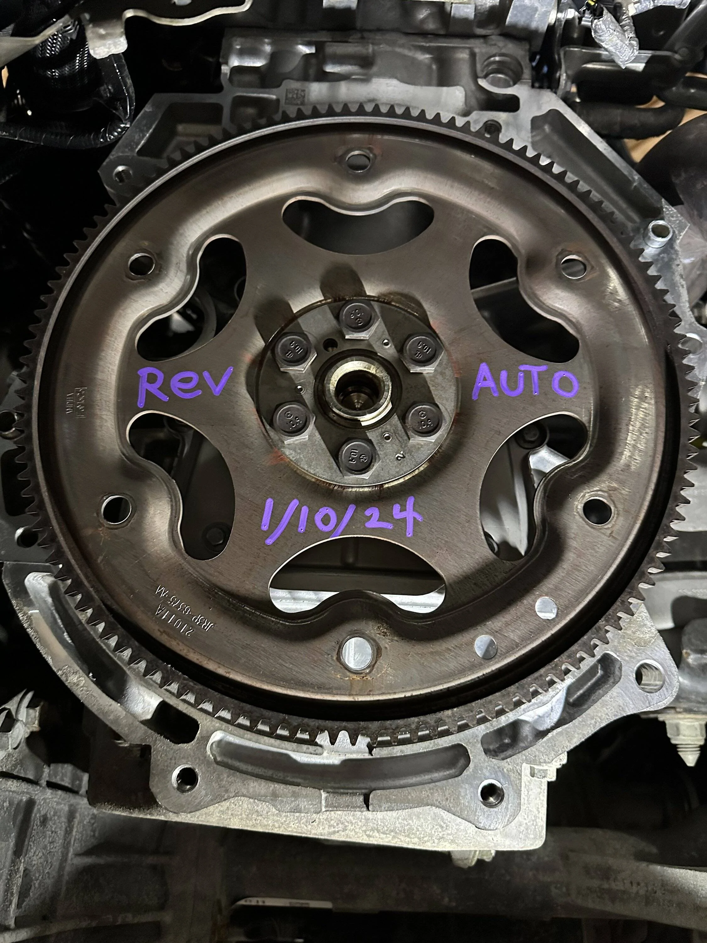

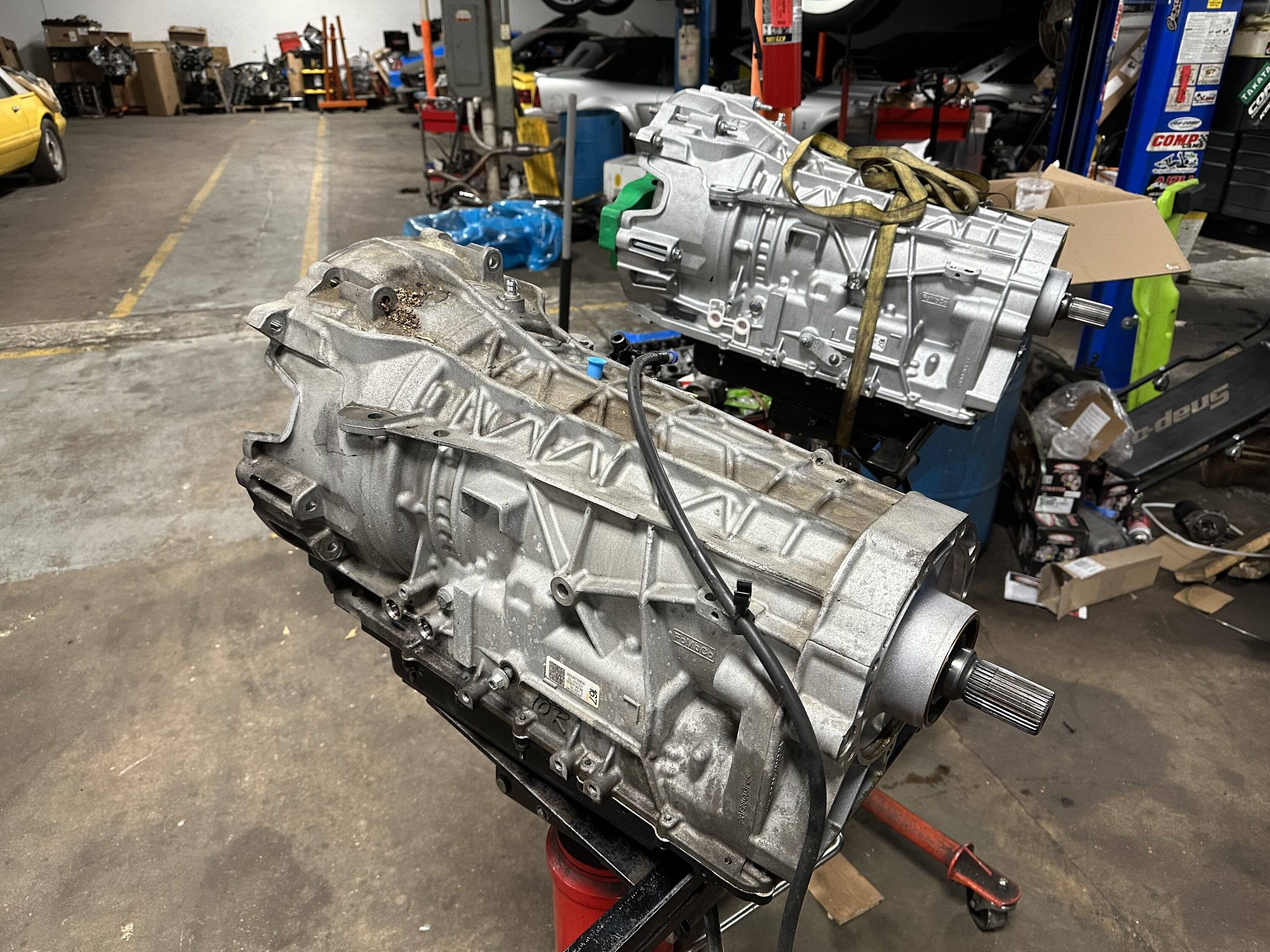

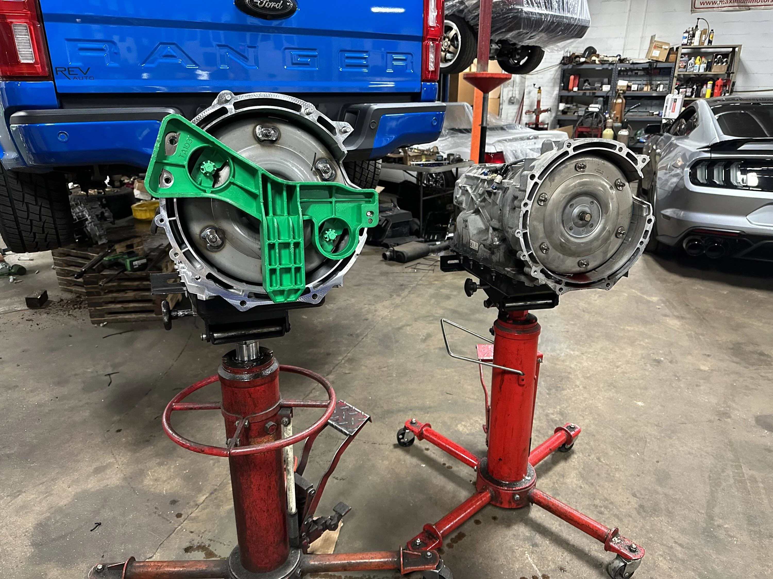

I just replaced mine for pretty much the same reason. Second would flare to the limiter cold and fifth would do it warm. Many other odd shift characteristics were happening too. I bought a new unit from Ford and replaced it Wednesday night, now everything is so nice and smooth!
