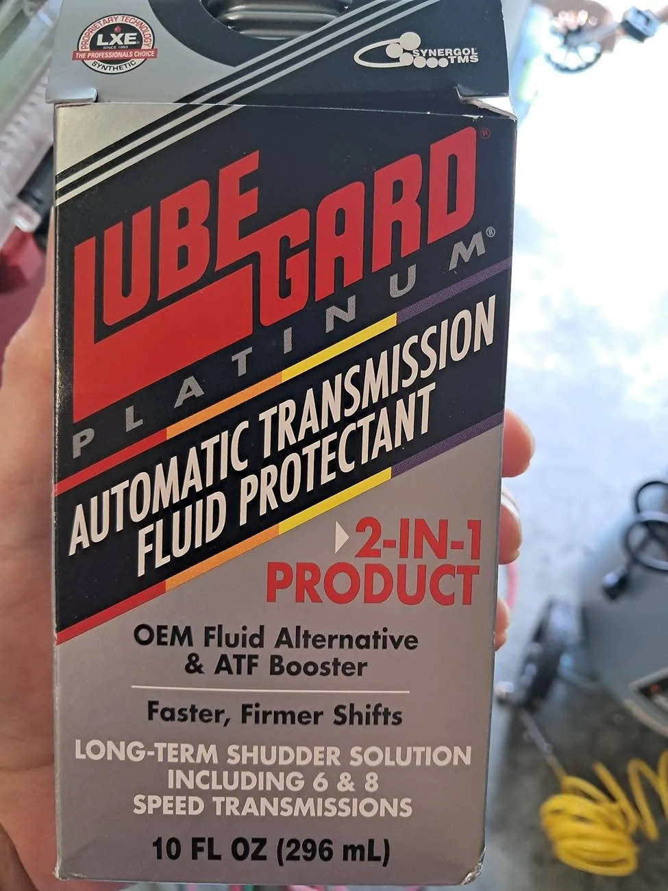

Maybe this has been covered but reading the box:
'OEM Fluid Alternative' implies you could replace the ULV completely with this stuff which would be ungodly expensive.
But it also suggests 12 ounces in our trucks is a minimum since the full volume is 12 quarts.
I already put in a 15 ounce bottle, this is a spare.
Not what they mean by that.
In certain cars you can use it with a generic Dexron fluid and 'convert' it to whatever spec your car calls for.
I'm not a huge proponent of that. As a supplement, sure, but using a non-spec fluid and relying on it to make it work in a specific trans, notsomuch.
ULV is still somewhat of a unique beast being as thin as it is. There's not really anything you could add to it to 'convert' a thick fluid into a thin one.
