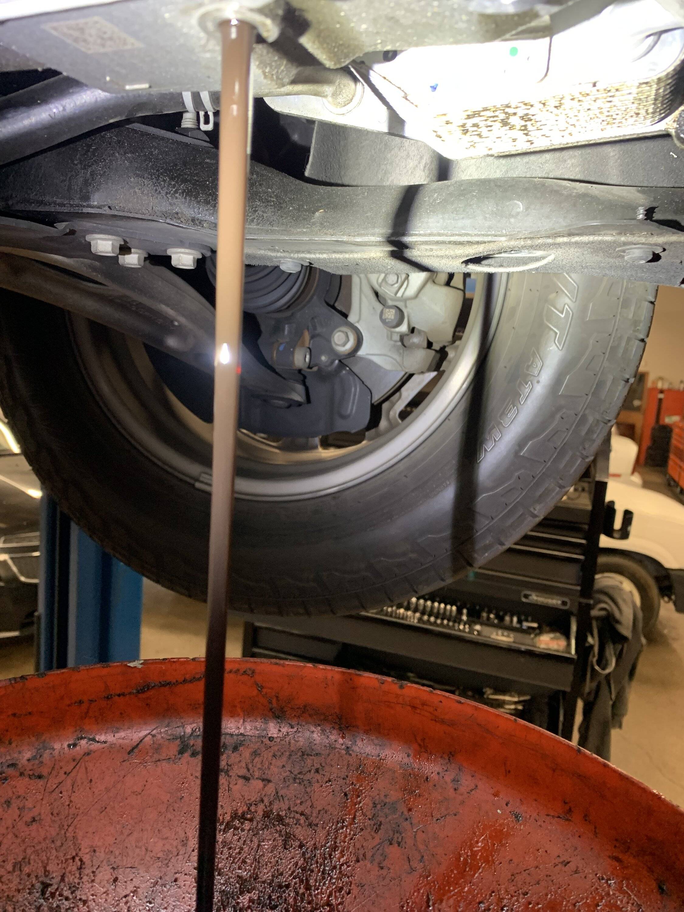

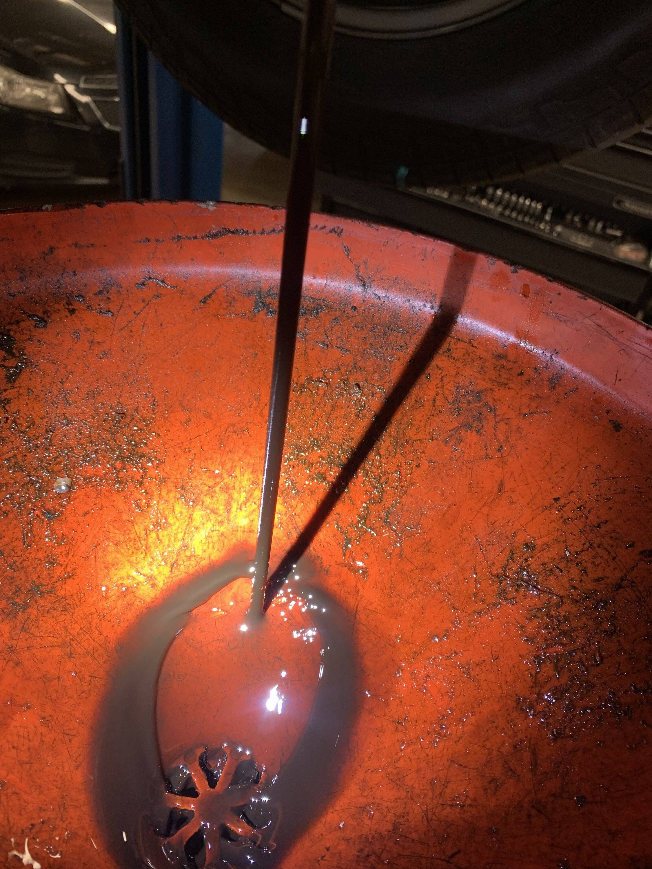

Cup of water I drank this morning
VS cup of Pee I vacated tonight
Its all relative until we see an actual chemical analysis of what's going on with it.
For all we know, the darkness is friction disk material. My wheels take on a dusty rusty appearance days after washing because the brake lining wears. Doesn't mean our brakes are toast.
I look forward to Stic-o posting his results. It will tip the scales one way or another for me.
Take a chemical analysis of your cup of water vs your pee. I'll bet you see a significant difference in the chemical composition. Your body is flushing it for a reason....getting rid of waste.
Do your transmission a favor and get rid of the waste!:)
