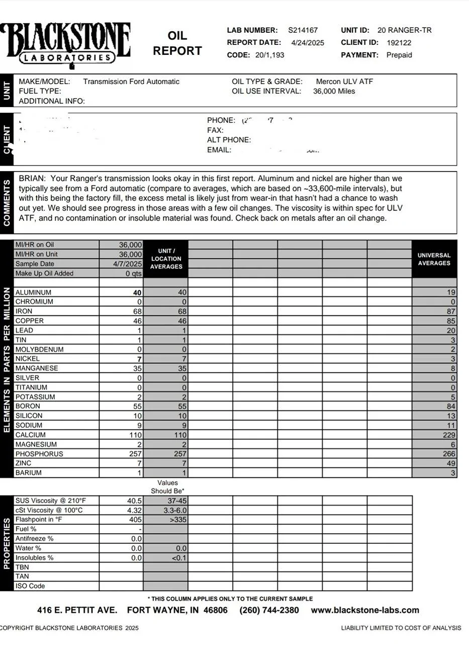

Blackstone used Oil Analysis of my transmission fluid at 36k.

No issues with the transmissionn just was more to get a baseline for the next change/test at 75k. Pumped out 4.5 quarts 3 times through my Mike's Build shop dipstick. Will do the filter at 75k at the next fluid change.
Definitely was worth doing based off the report with the elevated wear metals. I noticed a slight shift improvement with the new fluid as well.

Lots of clutches, steels, and valves making lots of debris in these transmissions. Best to keep them clean. I don't worry about the fluid degrading as much as I do about getting that material out of the trans(IE Valve Body).

Iron, aluminum and copper show up prominently of course. I wonder how those quantities would change after using Lubeguard? And if other elements would go up/down?
