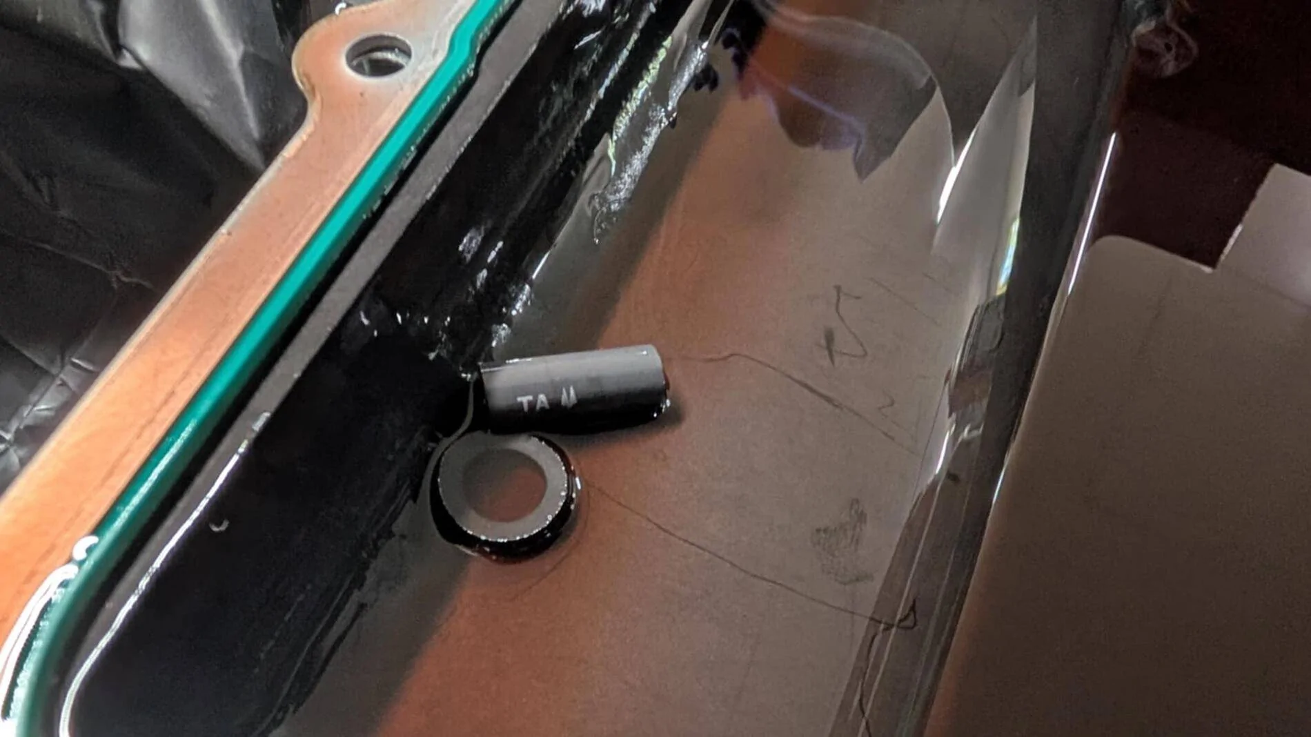

I drained and changed my filter on mine at 10k miles and let it drain for a couple days. I also added a standard depth PPE transmission pan so I can easily drain later.
I also found a piece of hose in my OEM pan.
