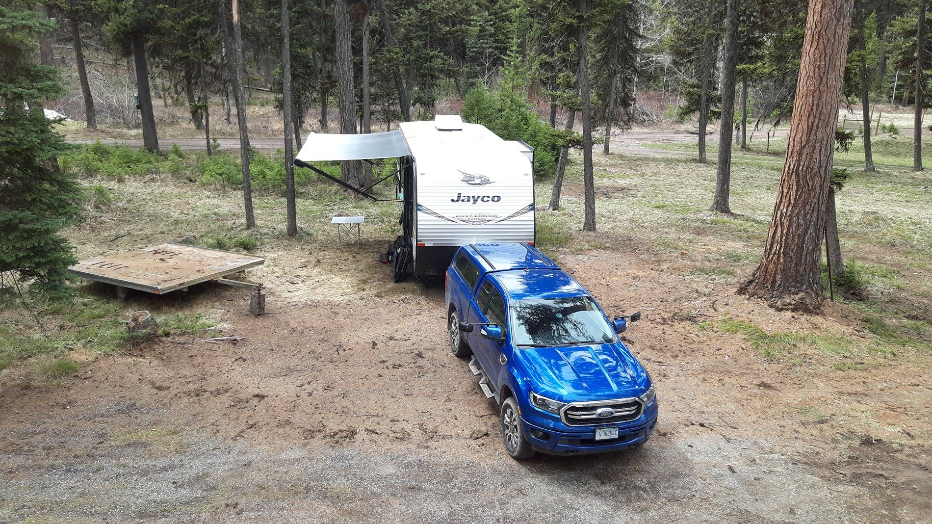

We purchased our Ranger to tow our <7,000 lbs travel trailer. Power has never been an issue. We do avoid driving in windy conditions. And you don't get a lot of downhill braking help from the 2.3.

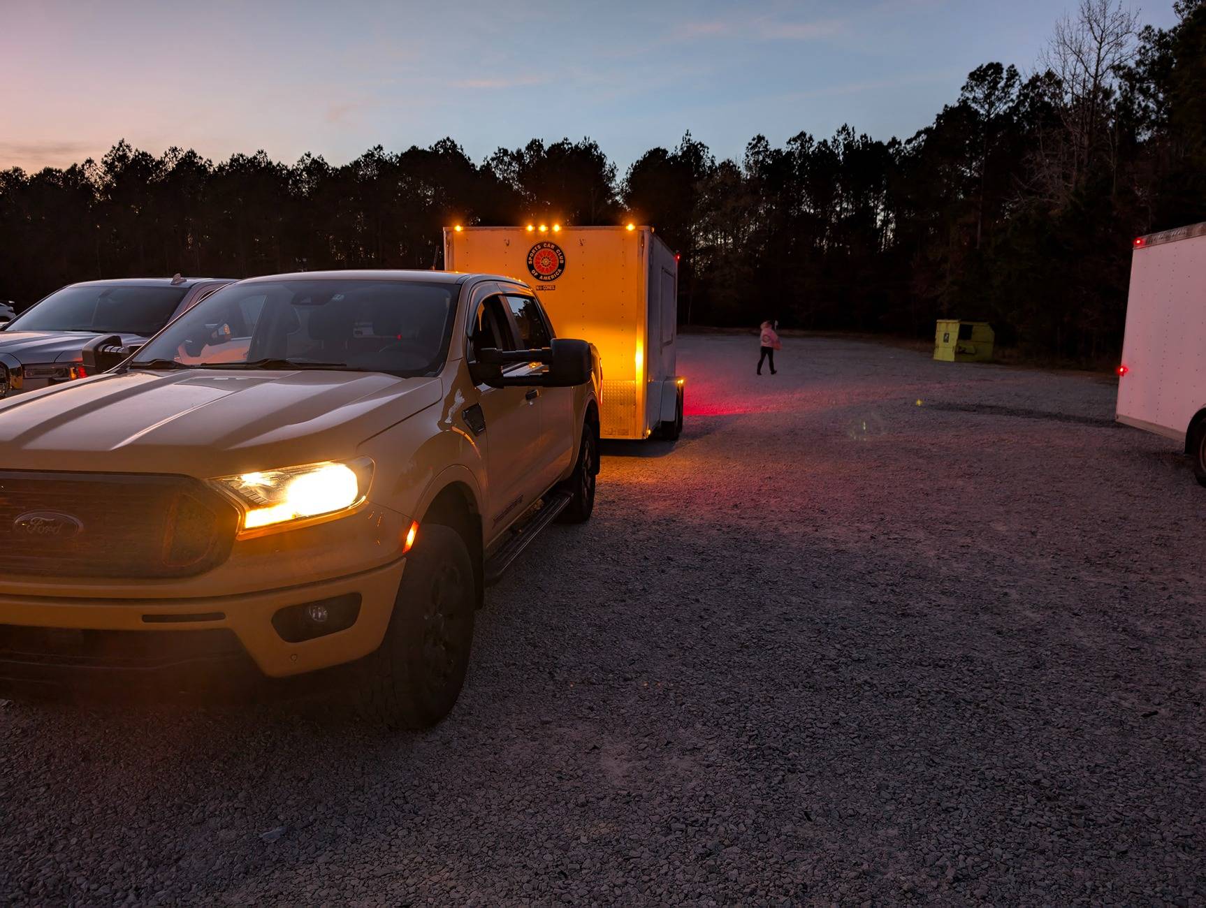

This is a 6,100 lb trailer I pull 3-4 times a year and the mirrors extended.

Well unfortunately I will not be able to use the enclosed trailer for this trip so it looks like I will be using an 18 foot 2023 non enclosed car trailer now. I do like those mirrors but you are definitely right, just a little pricey. I’ll have to do some researching down the road and maybe I can find a pair that meets the budget.

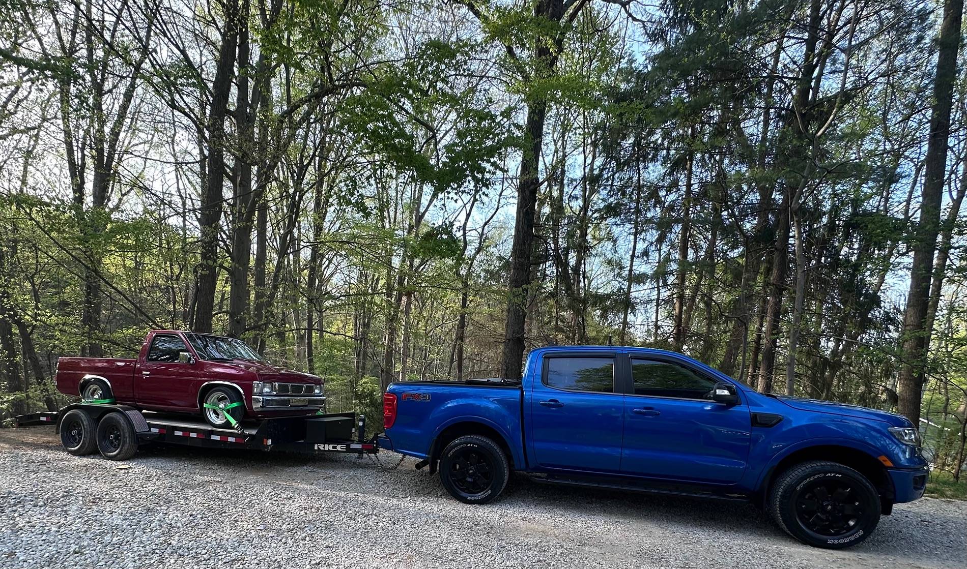

UPDATE: The Ranger did great. We pulled a 18 foot open car trailer and my mini truck with it. We had 4 passengers and the bed was packed with items for the trip.
We also went through the Jellico mountains and stopped traffic. We averaged 14-15 mpg.., for the round trip of about 1,000 miles. I also installed the Red Arc Liberty brake controller prior to leaving, and it did great as well. The Ranger pulling my mini truck surprised a lot of people for sure but what do you expect? It’s a Ford!..lol. Thanks for everyone’s input prior to me making this trip. All went smooth and now back to work.

Probably better its a flat bed. Its the frontal area our trucks don't like. They still pull like a diesel tho. Glad everything worked out.
I agree. I get around 15mpg pulling my sxs on my open trailer and about 11mpg towing my enclosed trailer.
