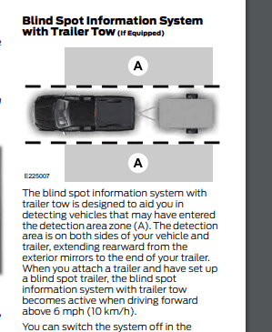

It's a bit disappointing that documentation make it seem as if the entire length of the trailer should be covered, but it makes sense that a trailer can simply block the sensors. I think the issue is that it could work for longer trailers depending on the style of trailer. A long flatbed trailer for example, would probably have its entire length covered, while an RV trailer would block the sensors. Wish it was more clear in the writing somewhere.
I also tow a motorcycle on a flatbed trailer. The sensors work fine with that but, as you mentioned, it's a flat, open trailer unlike a big box travel trailer. Clearly that makes a difference.

I have an 18.5 ft that's 8' wide and it seems to work fine. I wonder if it has to do with the spacing between the truck and trailer box? Mine has a fairly long tongue and the E2 hitch puts the ball about a foot back from the bumper.

Now that I'm thinking of it - I've noticed that my blindspot detection works differently on each side of my trailer.
On the right side it works as-expected. If a vehicle gets anywhere near the trailer on that side, the light turns on.
On the left side it works as described by OP. The vehicle has to be a lot closer to the front of the trailer before it lights up.
I thought maybe it could be that the arms for the awning that are adding a few extra inches to the trailer's width on the left side.. but the awning is on the right side. Weird.
