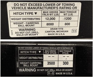

From what I read, you should onlly use a weight distributing hitch if the sepc decall shows a tongue weight without a WDH and with a WDH.

I looked at a WDH and that's when I found out about the Sway Control issue. In no way can I afford to violate/void my warrranty. So far, no issues using sway control. I pull a 26' tandem axle travel trailer, so, I'm hoping to continue for the same results.

the ranger is rated the same with and without WDH, it does not say to not use one

This info is from ETrailer. I woud think it's in thei interest to sell as many WDH's as possible.
https://www.etrailer.com/faq-weightdistribution.aspx
If your hitch is rated for use with weight distribution, the weight distribution system will allow you to tow at the maximum capacity of the hitch. Weight distribution doesn't "increase" your hitch's capacity so much as it allows the hitch to be used at its maximum capacity. Check the hitch's ratings to determine your towing capacity with and without weight distribution. Note that only designated Class III, IV, or V hitches may be used with weight distribution systems.You should also note that a weight distribution system does not increase the towing capacity of your vehicle. Your towing system will only be as strong as its lowest-rated component. You should always abide by the stated towing capacities of your vehicle and towing equipment. Failure to do so can result in equipment damage or failure.Keep in mind that not all hitches are designed for use with weight distribution systems. Always check the trailer hitch's weight rating label for a weight distribution towing capacity. If there is no such capacity listed, then a weight distribution system cannot be used.
