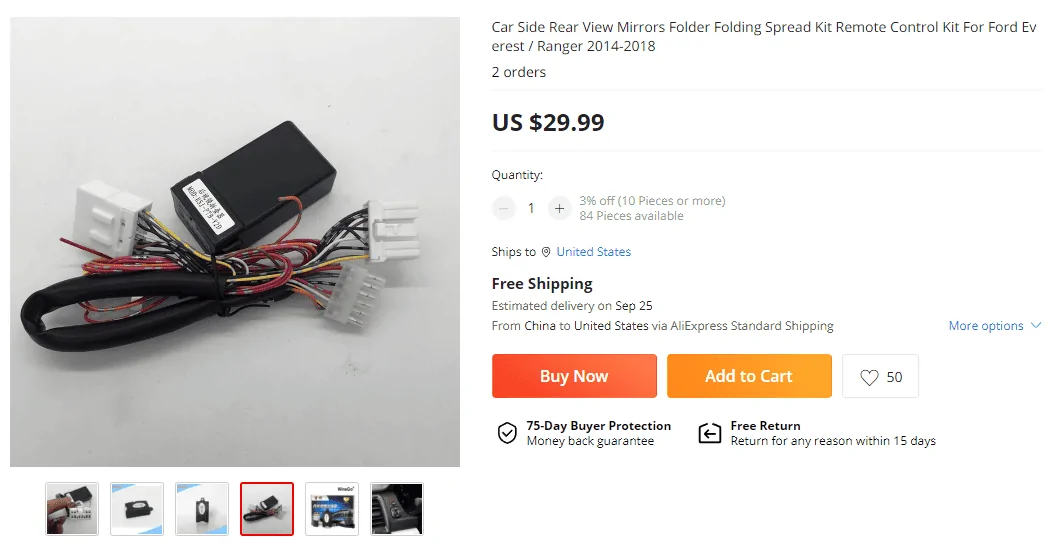

2 wire install. $29.99 from Aliexpress. Make the mirrors function as they should.
Plug in harness, old button still works as intended. 1 wire to constant power, 2nd wire to power door lock wire.

Are we not allowed to link items like this on Aliexpress? Would be nice for a link if you found a working one.
Looks like the one in the OP's link is from "GZ WinsGo Store" on Aliexpress, if anyone else is trying to track it down.

Yeah I actually bought that back in April of 2021 and just now got around to installing it.

I have the module but decided to do a quick test with with my Power Probe before I cut the factory wires and toggle each fold/unfold function.
I'm unable to get the module to work.
Did you have to have all the lock and power wires hooked up and the module's just that smart and maybe that's my problem?
With the module plugged and the one wire connected to constant power, my folding mirrors won't even function normally.

I cut no wires. recalling from memory I wired 1 wire to fold them when my doors lock. The unfold when I start the truck. I had the option of running the unfold wire to unfold upon unlocking. This is such a great CHEAP mod, it's silly that Ford doesn't do this from the factory, and even the Lariat F150's you have to push that silly fold/unfold button.
Just looked at the wiring diagram. You unplug the OEM connector to the mirror fold/unfold button and plug in the hardness which goes to each connector. You then run a HOT wire to the battery and the signal wire to FOLD them (I believe this wire is blue) and the unfold is green. I didn't connect the unfold wire at all. When the truck starts it will trip the relay and unfold. The fold wire I believe is on a factory connected @ the knee panel (You just use a wiretap, but probe it to find it) to the left of the fuse block but under that panel. But touching that wire to power should fold the mirrors up.
