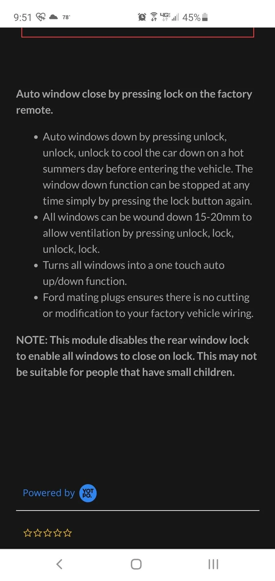

I have had this module installed for sometime and just noticed something odd about it. When the rear window switch is locked, the front controls for the rear windows no longer operate the window but the back switches still do.
couldn’t figure out how my dog kept rolling the window down.
Also, I just experienced that with the windows locked, when the truck stops (auto s/s) and upon restarting, the left rear window goes down by itself.
I'm going to try what you described before I contact the manufacturer for troubleshooting. Maybe I can get a resolution for both issues.
Edit: just checked their website...
