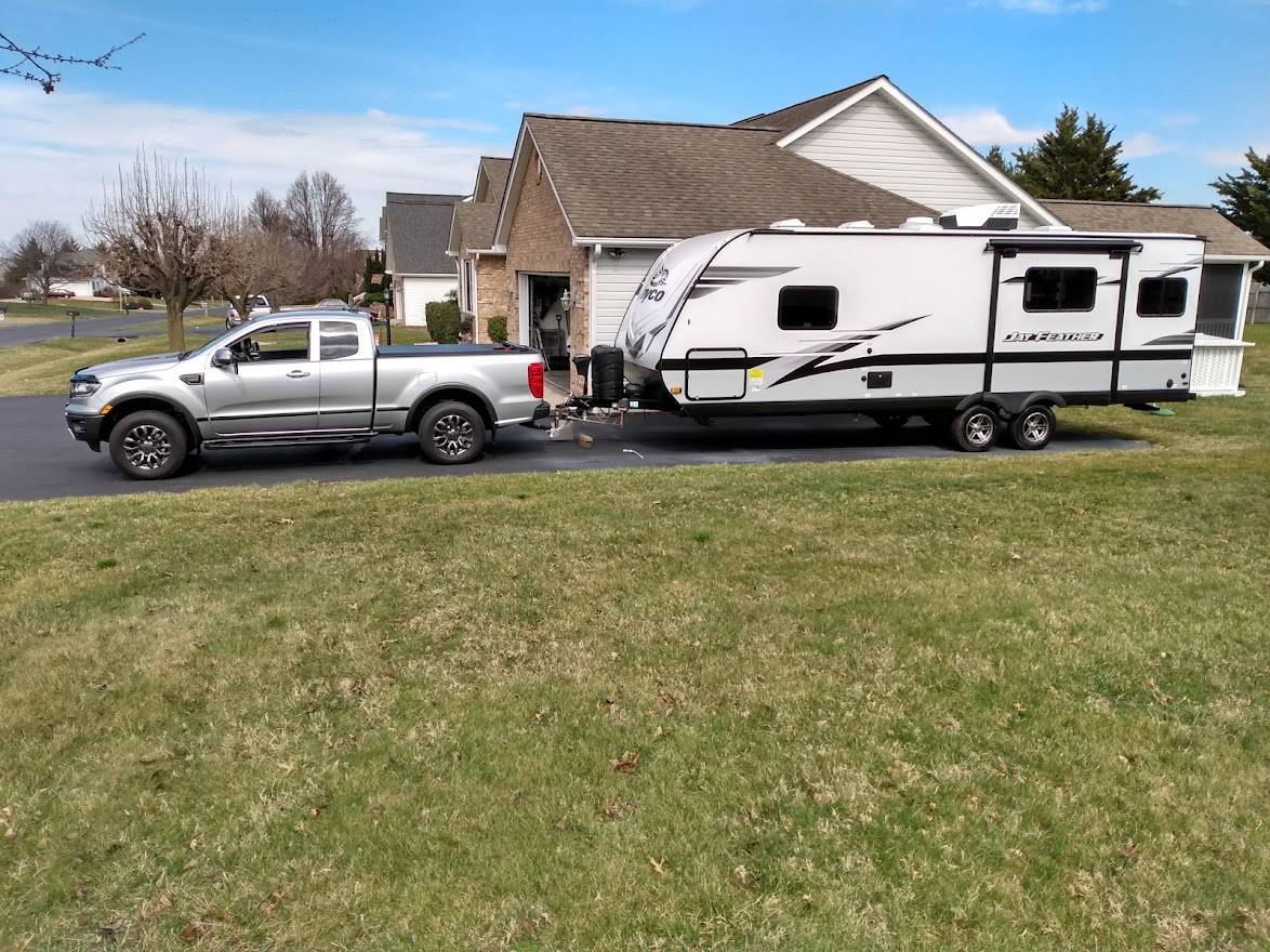

OK...not trying to be picky, but is that the dry hitch weight as posted by Forrest River ?
By dry, try to figure out if that included battery an full propane tanks....most manufacturers ship their units without batteries and propane tanks.
If that 550 is without, you need to add the following approximate weights directly to the tongue, depending on how the trailer is outfitted...
Battery, about 45 lbs each.
20 lb propane tank, filled to 80% weighs around 30 lbs.
30 lb propane tank, filled to 80% weighs around 50 lbs.
It becomes very easy to approach or get to the 750 advertised maximum tongue weight.
Your experience/ability does come into play. It is very easy to tow a small, light weight trailer, even for a novice. Getting into a larger rig with more weight takes some experience.
The Ranger is up to the task, IF you set it up right, know what it's limits are, and what your limits are.
As it comes stock, the Ranger, in my opinion is not set up to tow a maximum weight travel trailer.
It needs some suspension up-grades...shocks, some better springs or a Roadmaster Active Suspension set up. some higher rated load class "D" tires.
Your weight distributing hitch must be set up properly....guess work is a big NO-NO.
And, yes, I know what I'm speaking about from long experience. Myself and several others here tow large travel trailers and haven't had any problems that have been posted.
My rig.....
