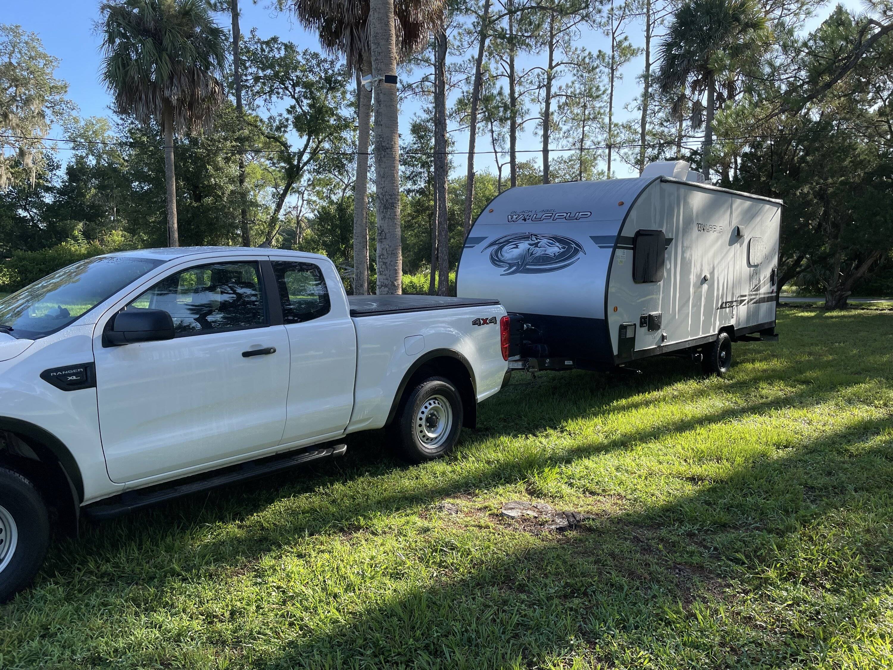

OP - What kind of tires on the trailer? Please post pic. Are they ST tires?
6,060
30,267
I went to their web site for the specs....
Tires are listed as "premium" but no brand. I would imagine their ST rated, and they are 15 inch which is good for that small a rig.
Can't imagine any reputable RV trailer maker NOT using ST rated tires.

Try driving with some weight in the bed of the truck at about 40psi rear and see if it helps before spending $$ on some WDH, seems to be the go-to
My FX4 came with those same Hankook tires. Ford recommended 30 psi. I now have the Tremor tires and wheels on my tuck, but when I had the Hankooks on my truck, they rode well at @ 30 psi. IMO, 40 psi would be overinflated. A test similar to the chalk test would tell if the tread is riding flat on the road.
Also, it looks like he has the 18" wheels. That would mean he has less sidewall area to flex.

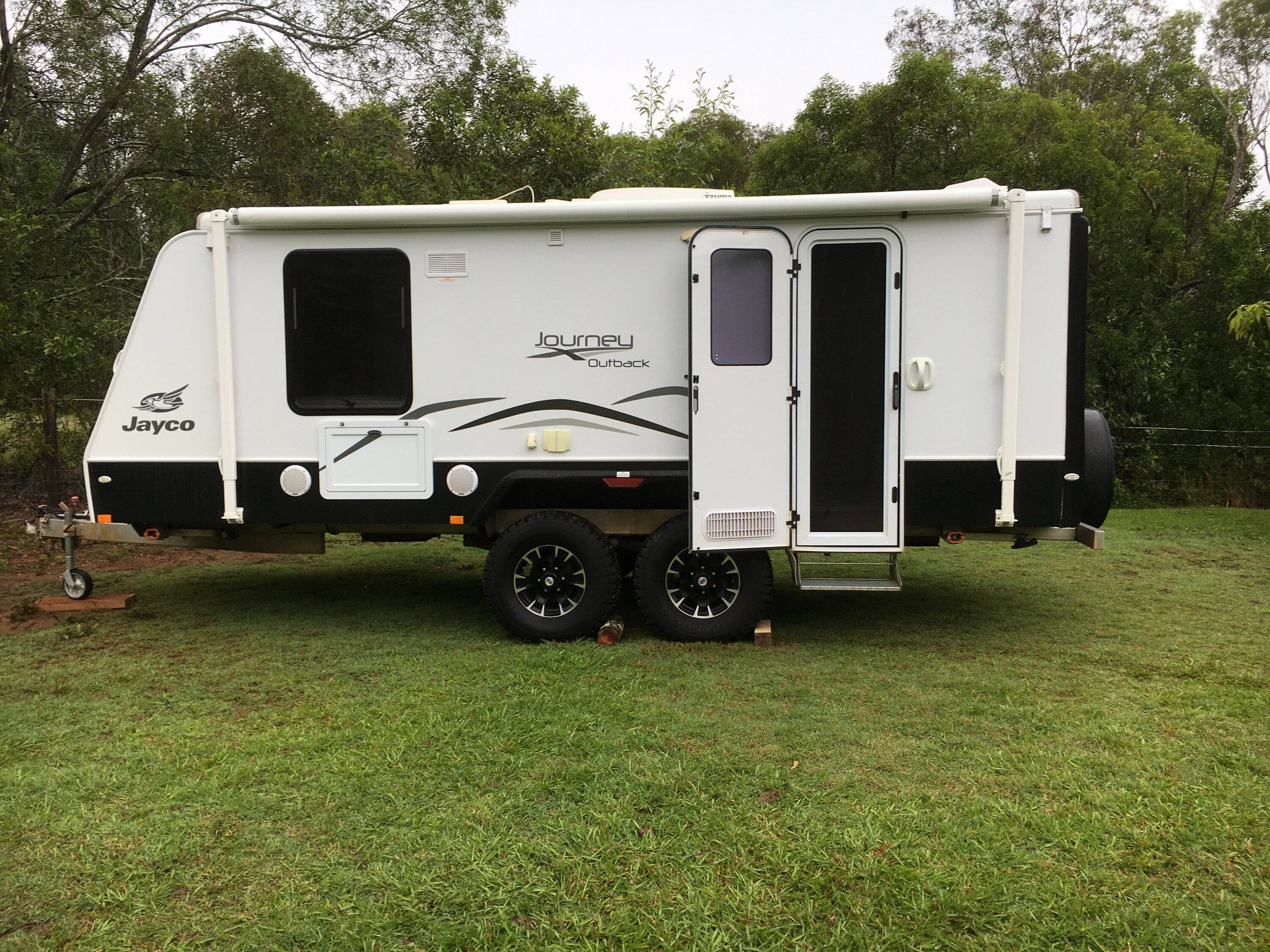

I tow a 2400 Kg ~ 5300 Lb double axle -Jayco Journey outback ( off road version) caravan (trailer) with my global, and have never felt the need for a weight distribution hitch, however I did have quite a bit of sway and wobble from passing trucks until I learned how to best pack it and got the tyre pressures right.
I have LT AT's on my truck so can run fairly high rear pressures, I found around 40 PSI to be good, and about 45 in the Caravan for on road use safely, at 80-110 Km/Hr. For gravel /dirt outback roads I found dropping back to about 30-35 was kinder on the truck and caravan and less prone to punctures from sharp rocks. My caravan also has two water tanks one in front and one behind the axles, I found it tows much better with the front tank full, and rear empty, unless I was going somewhere with no water and didn't have a choice.
