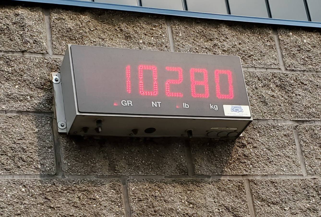

I tow a lot all over NY/PA and big loads too, the truck is a Damn work horse and I am on the upper end of that, one of my businesses is Scrap Metal, I have had Loads of over 1000 Lbs (In The Bed) it didnt squat but 1/2" and didnt know it was back there (Work Horse)
how ever ... your load will weigh more than your truck, things in motion tend to stay in motion, do it on a dry day and if its lightly snowing Stay Home!
a lot of us tow so much its second nature and there are things we do that we just dont even think about any more, and not just on a hill, in a city even going slow things fall off other trucks people step off curbs in front of you, never take your mind off what you are doing and what you have behind you.....
my truck, 1/2 tank of gas, Me and a 100 lbs GSD k9 weighs "Out" at the scrap yard at 5120
So, if that is no trailer as you indicated, I think that is over 4,000lb over-loaded. GVWR on these is only about 6,050lb, so that is 170% of what the truck is rated for. You really need to get a trailer with brakes for pulling that much scrap around. That rear axle was likely more than twice its rated load, some people may talk about built in margins beyond the ratings, but if that was all in the truck, it was way beyond any assumed margins. Loads are not just about what the springs can carry, it's about the loads impact on bearings and how much they can dissipate the heat before being overwhelmed and damaged from excessive heat, braking system limits, and so on. Truck is a work horse, but an abused work horse will live a short life.
Where did you get 170% of the truck capacity from? I want to see where you got your math done

I'm gonna "guess" that if that 10,280 is a weight scale, for his rig, that it also includes his trailer.
His 5120 truck weight and a 5000 lb trailer would bring it right to that weight.
It's basic math 10,280/6,050 = 1.69918 = 170% (rounded).
In his post he never mentioned a trailer, even mention over 1,000lbs in the bed. Granted, 1,000lb is very different than 4,000lb so perhaps a trailer was involved. But it didn't read like that included having a trailer. When he mentioned the weighs out of the yard and didn't list a trailer I'm assuming (I know that can be dangerous to assume, but I did put IF in my statement to cover that I could have misunderstood) that he didn't scrap the trailer he brought the haul in on and I've never heard on the weigh out not including the trailer, my scrap runs my weigh out has always included the trailer.
In his post he never mentioned a trailer, even mention over 1,000lbs in the bed. Granted, 1,000lb is very different than 4,000lb so perhaps a trailer was involved. But it didn't read like that included having a trailer. When he mentioned the weighs out of the yard and didn't list a trailer I'm assuming (I know that can be dangerous to assume, but I did out IF in my statement to cover that I could have misunderstood) that he didn't scrap the trailer he brought the haul in on and I've never heard on the weigh out not including the trailer, my scrap runs my weigh out has always included the trailer.
His post is kind of a gray area...
I can just envision my Ranger with a fully equipped F-150 (weight wise) in the bed...doubt if it would be able to move under it's own power. :crazy:
