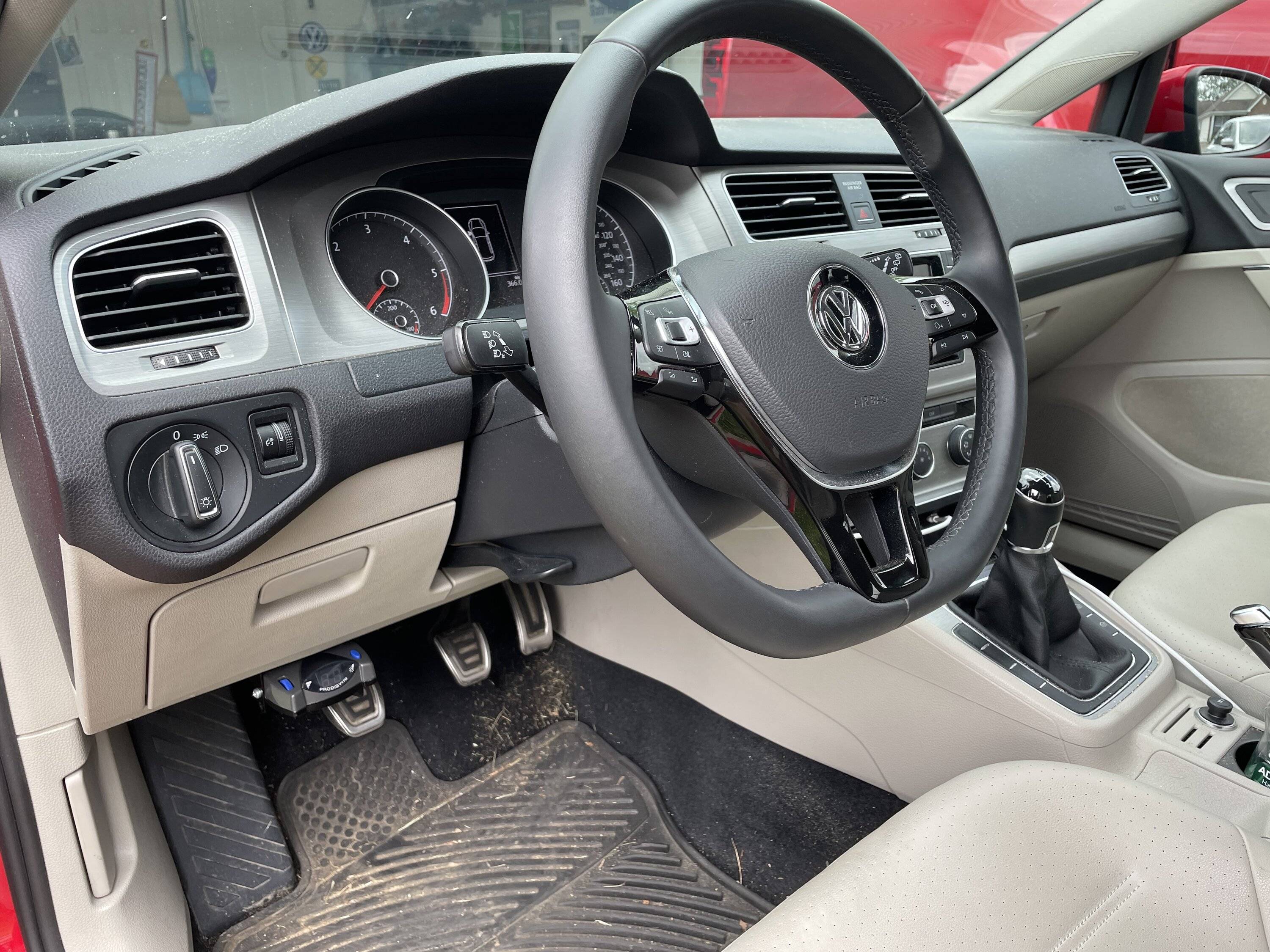

I've never towed a camper, but had a Prodigy P2 installed in my Previous Golf TDI. I have a Redarc Liberty in my Ranger. Both have identical capabilities: i.e they use an accelerometer and you can manually turn on the brakes. I never used the lever on the P2 other than to test trailer brakes, but manually activating the brakes it is clearly better on the Prodigy. It's got a lever with some heft and it feels like you are doing something. The Redarc just has the button, which while a con as far as activation, is a big pro for placement.
I would have probably used the P2 in my Ranger, but I didn't want to see it and couldn't figure out where I could put it and still operate it easily. I didn't;t want to drill into the front of any panels. In daily operation, both work just as well.
The Golf's brakes were fine unloaded, but you could feel a loaded trailer, which the brakes solved.

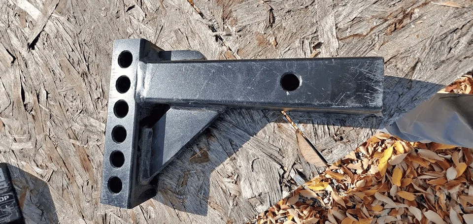

That is probably the best way for you to go. The hitch shanks, even from different manufacturers, will have the same hole spacing...it's an industry standard. So, you can buy a shank and then buy a head and bars separately. Several manufacturers do sell the head and bars separately, and you buy the shank.

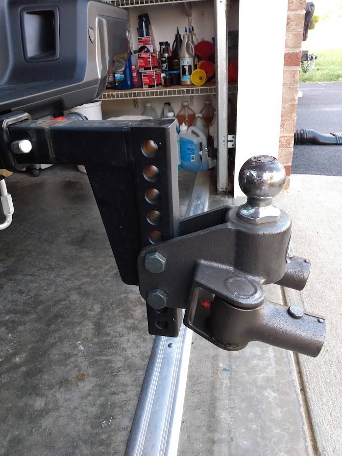

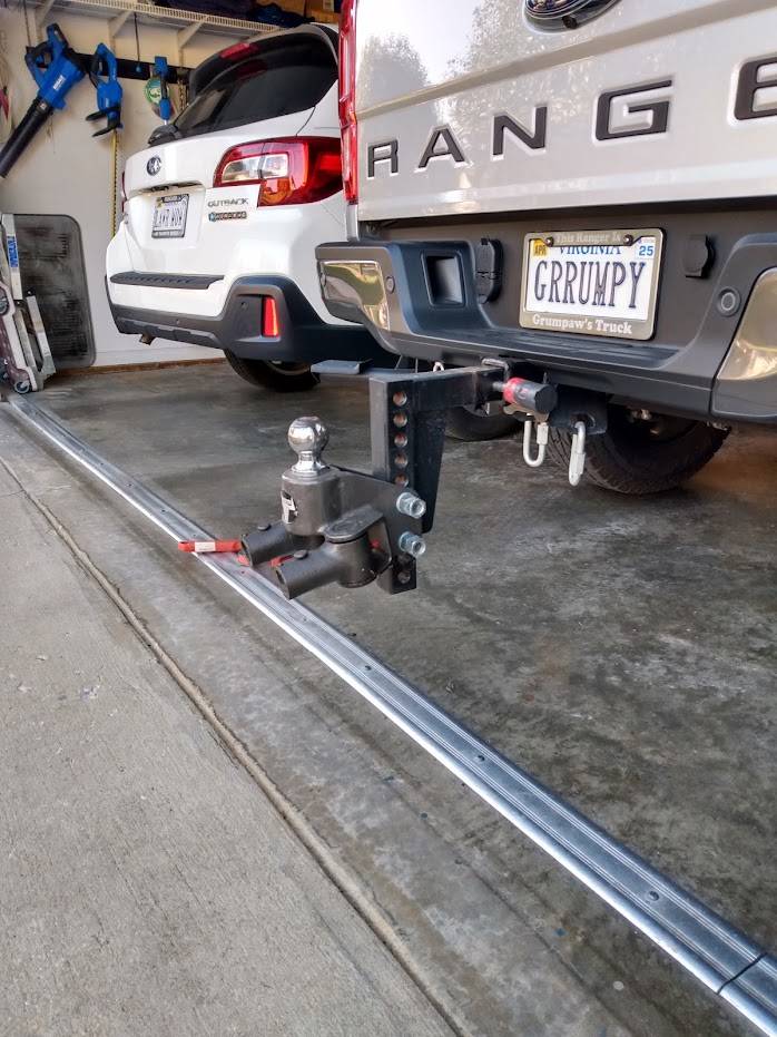

The 3 photos show my hitch head and the 10 hole shank I had to buy to get the head low enough...it also shows what a proper well made head looks like.

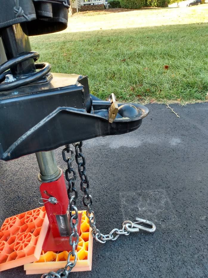

the 3rd pic is of my trailer coupler, which is on a Jayco. It is called an "underslung" coupler cause it's welded to the bottom of the frame rails....the reason for my having to get a bigger "drop" shank. A regular coupler, on about 90% of trailers, including Forrest River, have standard couplers, welded to the top of the frame.
Thus, you might not need such a deep drop shank. It will also depend on the height of the trucks rear, stock, lifted, ect.
I still would advise you to get a larger drop from the start, will save you from buying one to short. The one I have from Amazon is a Curt 17123...$95 bucks...Curt is top of the line quality.
