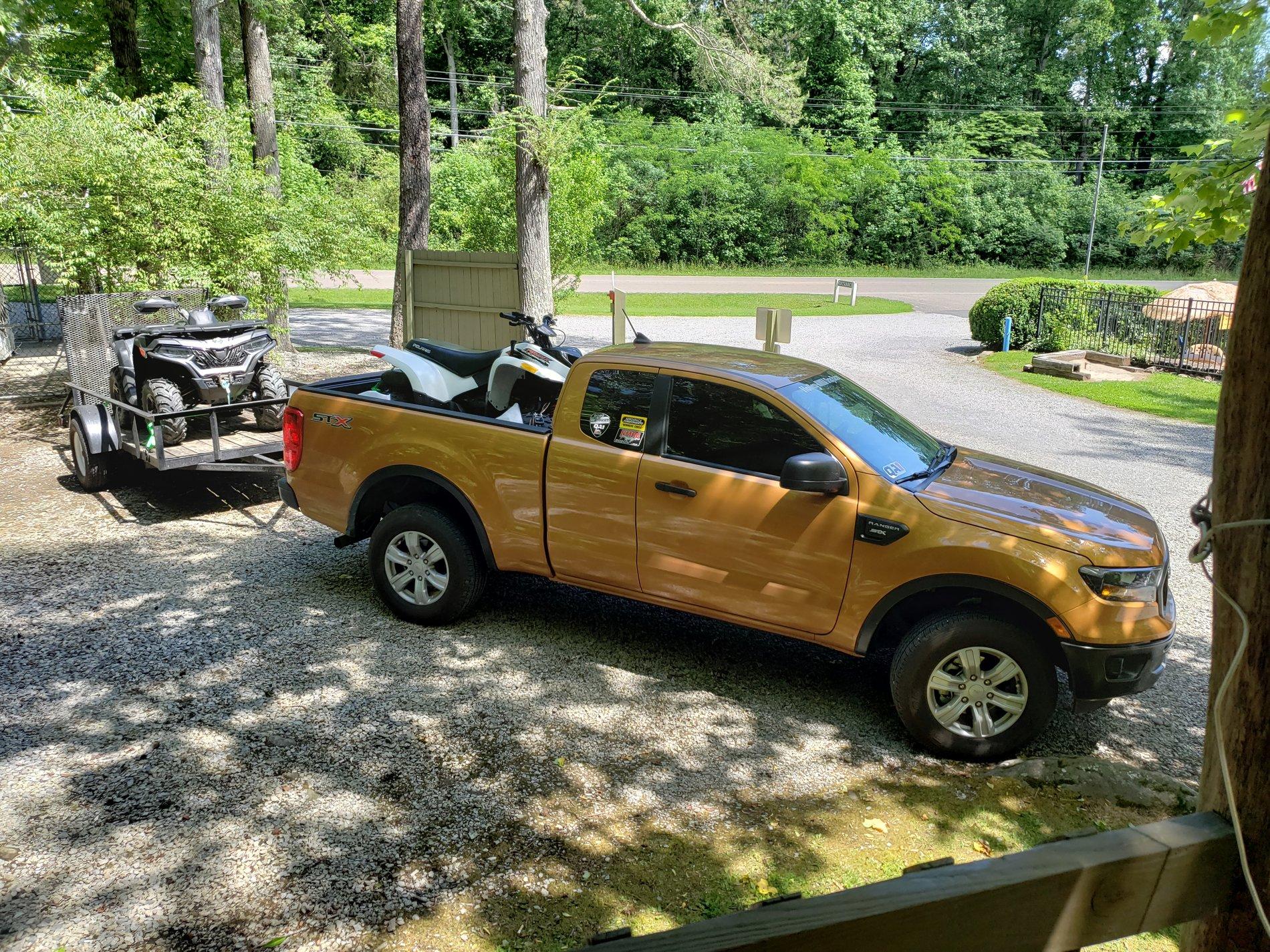

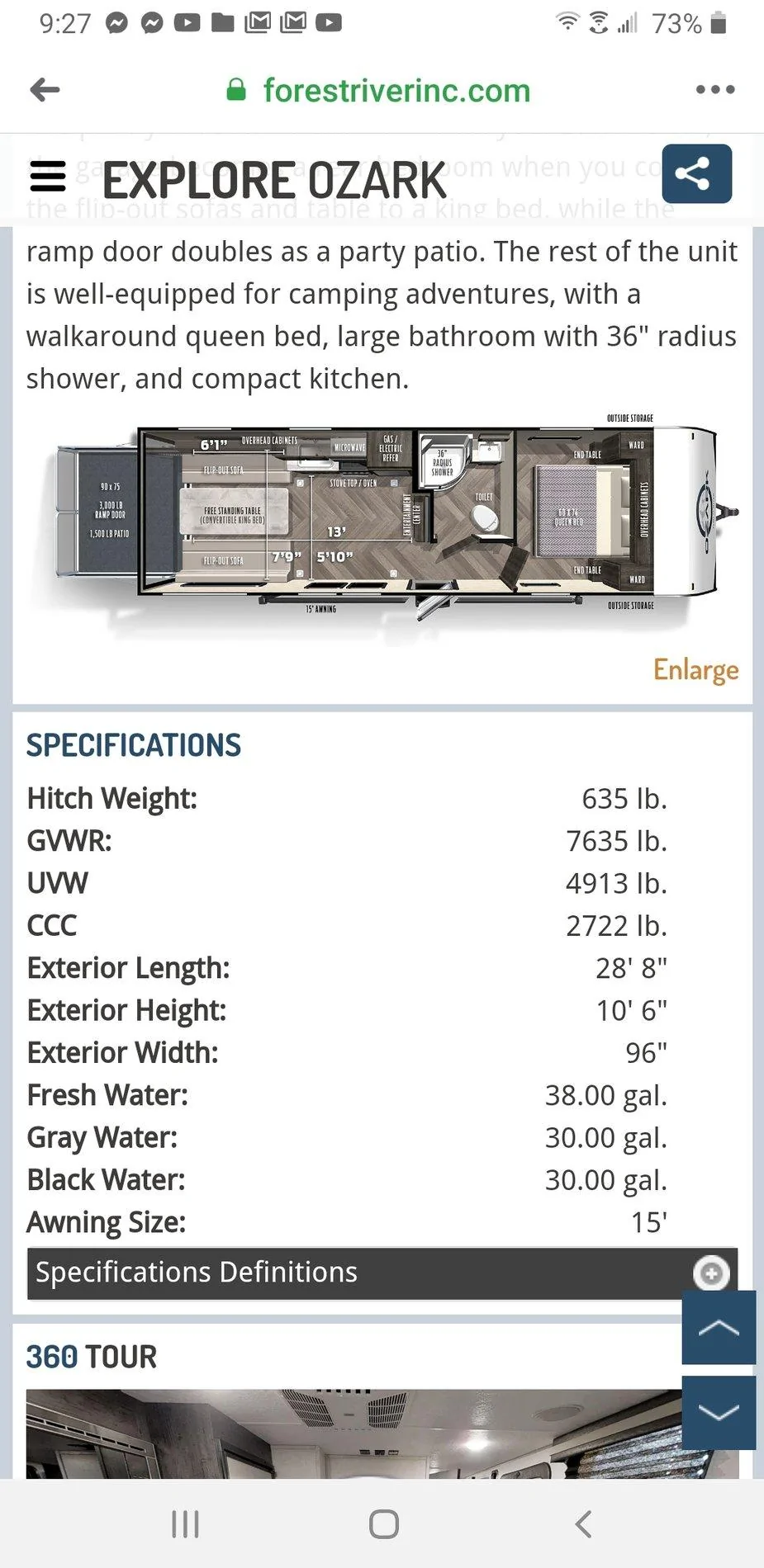

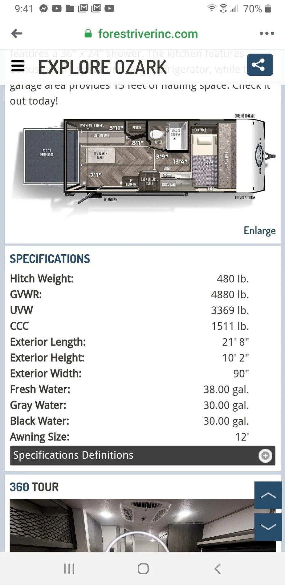

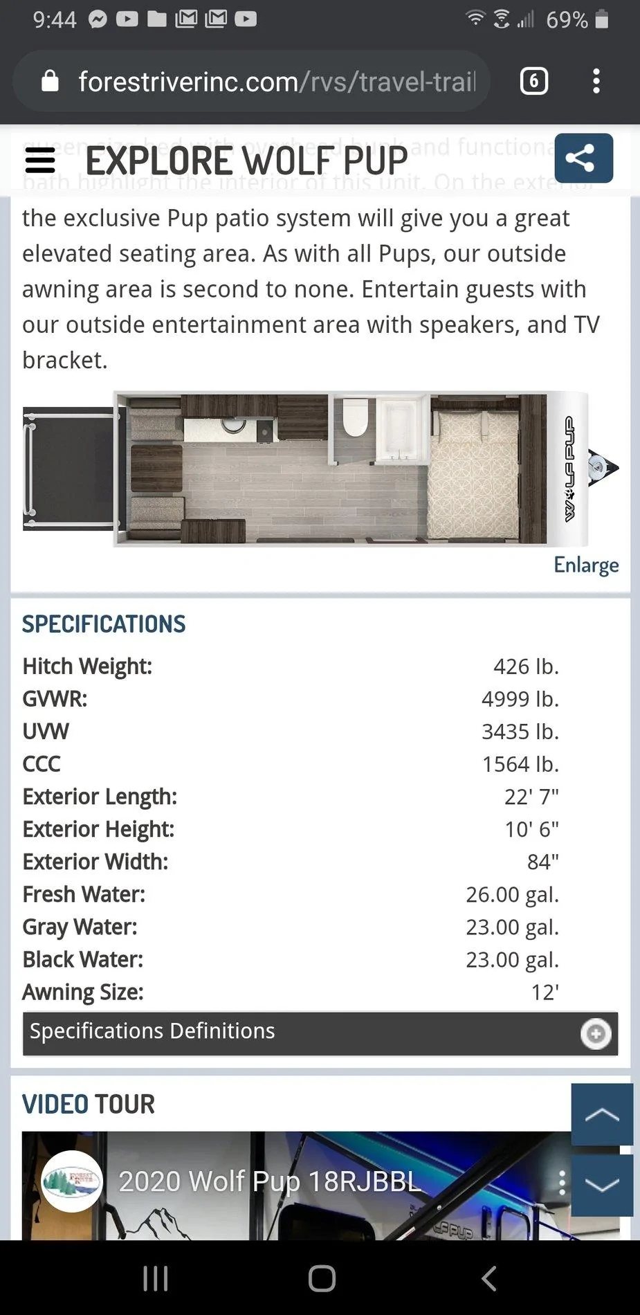

Hey guys. The wife and i are looking to purchase a small bumper pull toy hauler. Were a family of 2 so we travel light but like to bring our atvs. Looking at small toy haulers between 17 to 25 ft. Currently carry my atv on a small trailer and wifes in the bed. If we got a smaller hauler we would still be putting an atv in bed as 17 and 18 footers will only fit one. My atvs weight 830lbs and 370 lbs. Let me know that you think of the weight specs of the campers attached thanks.

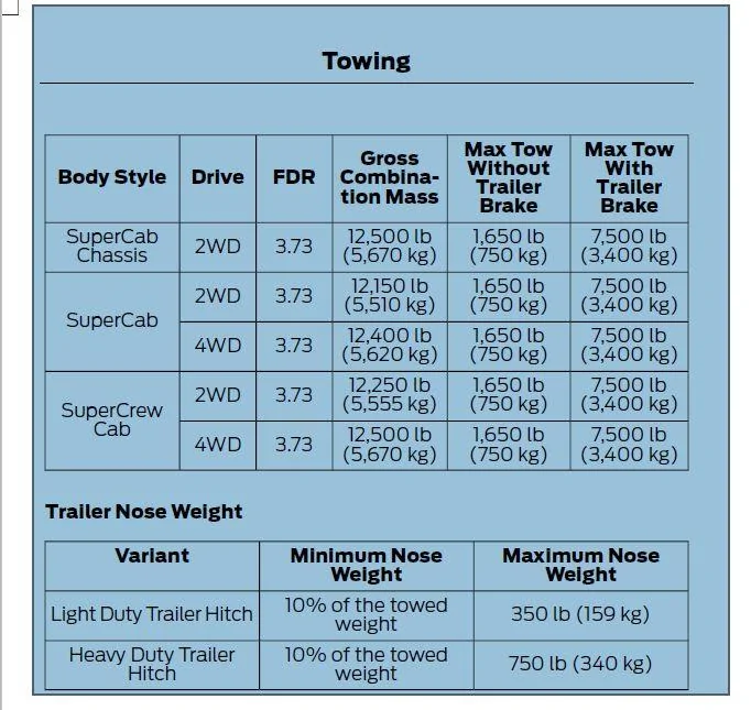

Hi Michael
Does the trailer fit within the owner's manual specs for your vehicle...particular GCW (GCM)
Gives you about 7,000 for the vehicle at GVW, so it looks like a good fit to me, but I do not know how much your vehicle weighs.

I believe its about 4200lbs 2wd stx supercab
