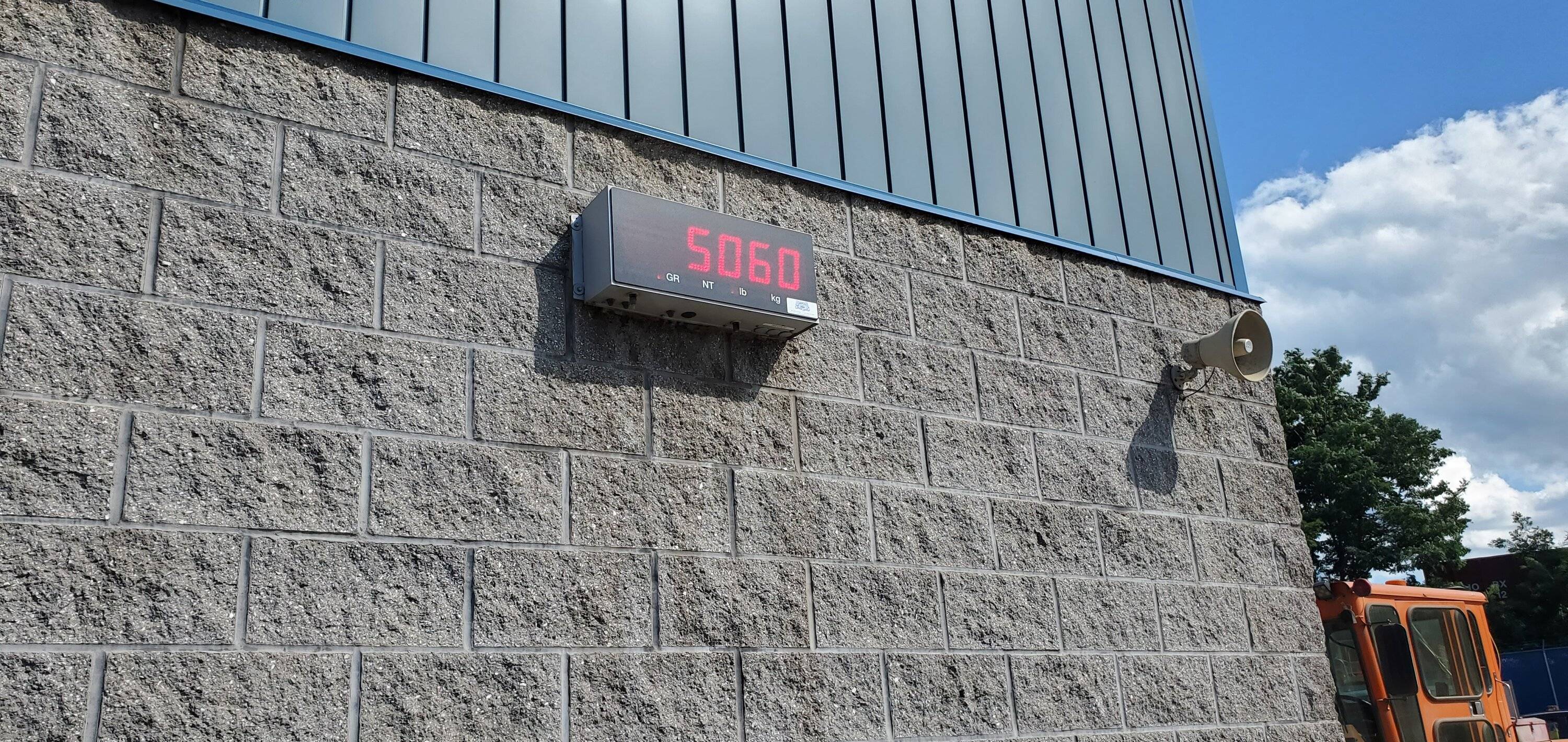

that "weigh in" was a truck on the car dolly with scrap in it, that truck was about 5200 lbs, so far the most I have had in the Bed was 1100 lbs, it only made the bed go down 1/2 inch
this is weigh out of my empty truck without trailer
OK, thank for the clarification, the 10,280lb was GCW while towing, not in the bed (GVW). As I said, not where was that post was it mentioned that that was towed. Did you have any brakes on the dolly or a way to activate the brakes of the truck that was on the dolly? Unbraked tow limit with the Ranger is only about 1,650lb based on the manual and towing guides from Ford.
