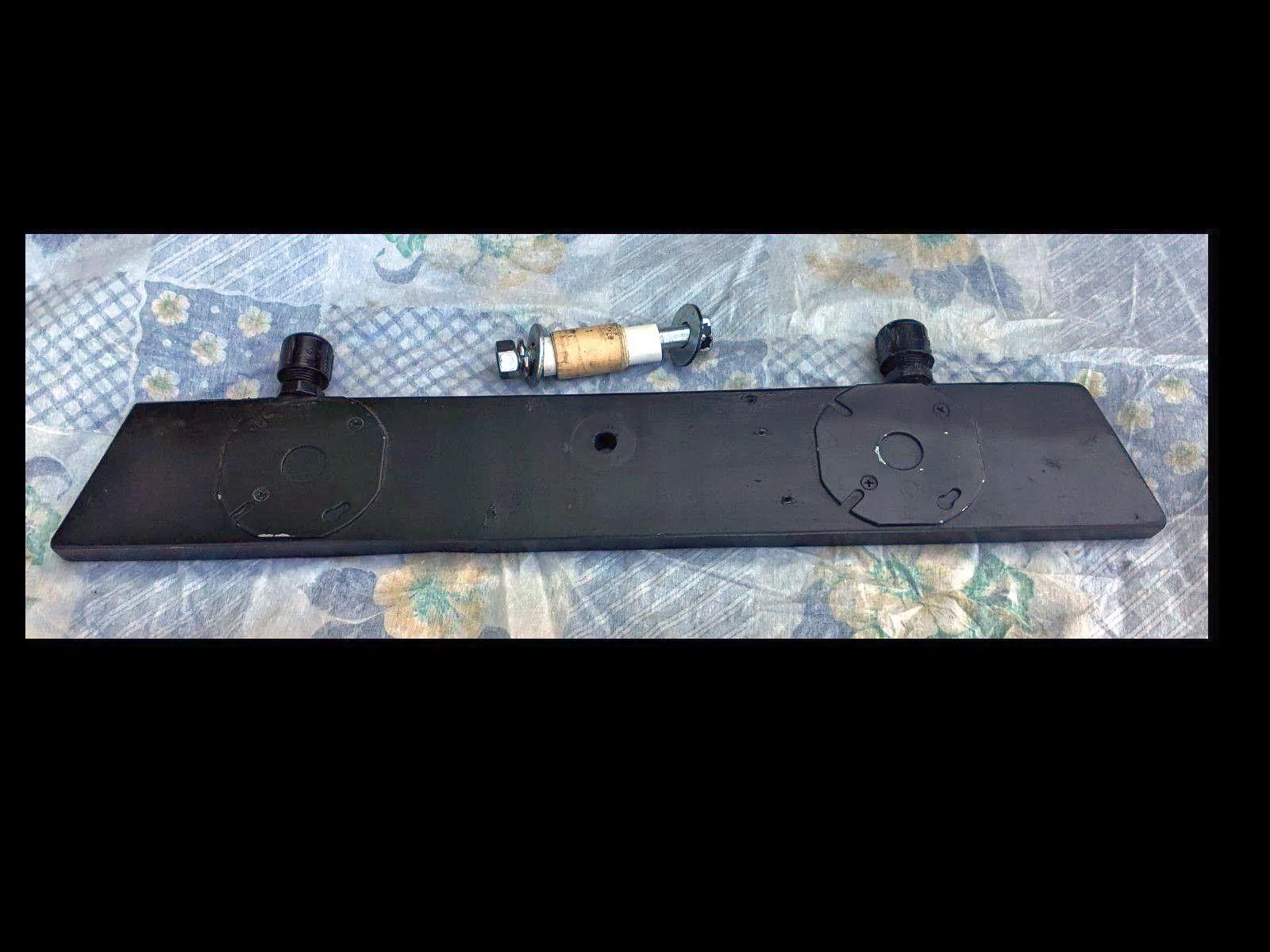

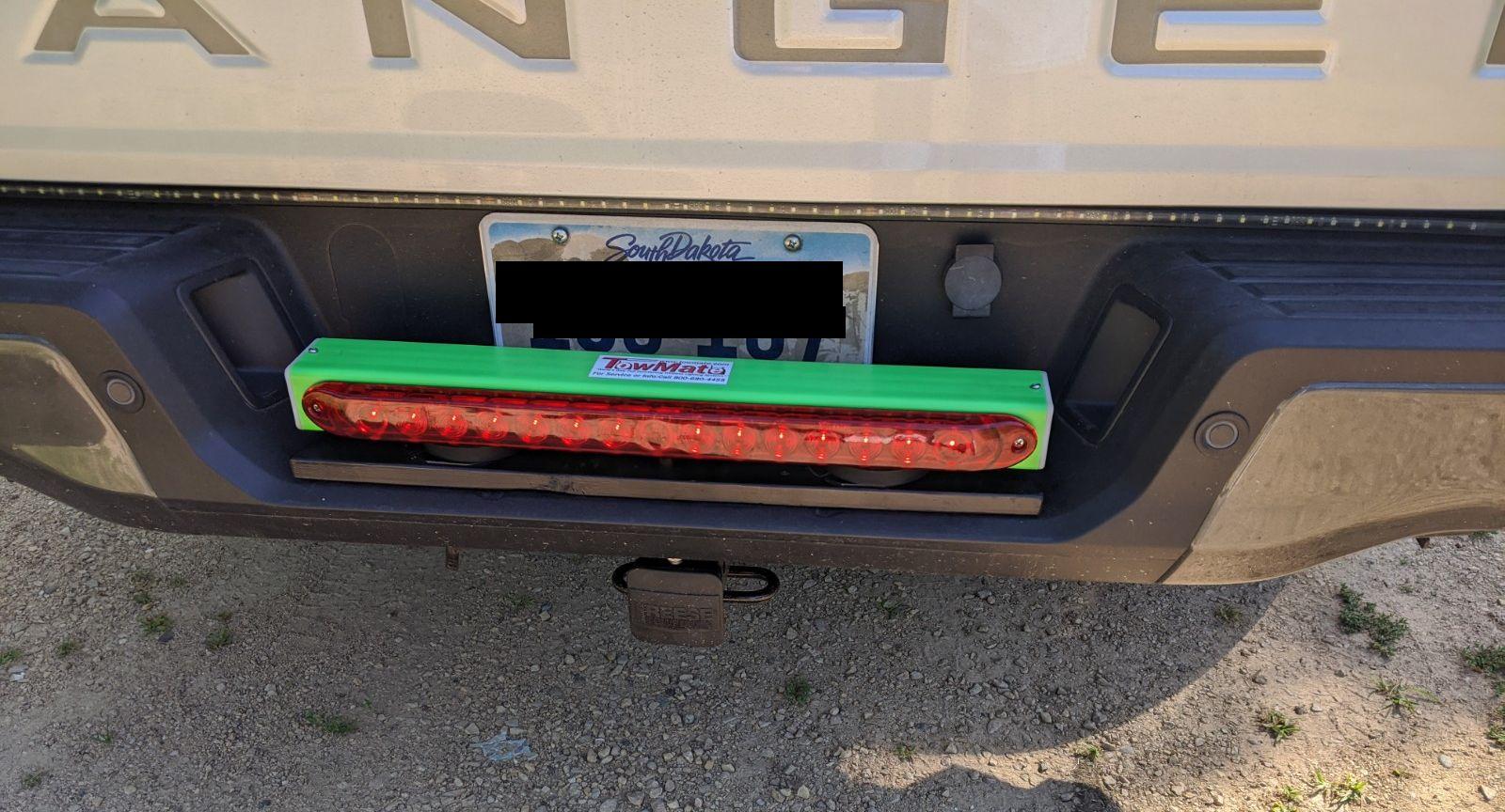

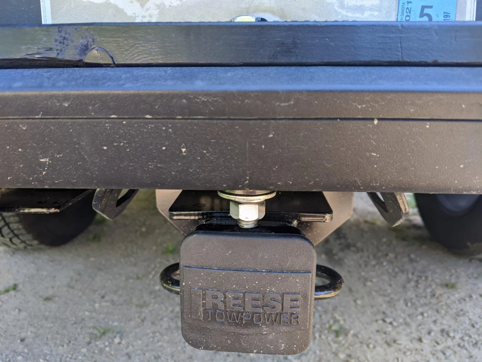

There is no place on the rear end of my Ranger to attach a magnetic light. I fabricated a mounting board that fits on the bumper so there is no contact with a painted surface.
I cut a 1 x 4 length of wood about 22 inches long to fit between the cut down portion of the rear bumper. Then attached. two electrical box covers for a magnetic attachment surface. Drilled a 1/2" hole in the board to take a 1/2" bolt cut down to 4-1/4" to go through the board and allow a fender washer, lock washer and nut to be attached from below. The head of the bolt with a washer on top of the board does not interfere with the bottom of the towmate.
The 1/2" bolt goes through a piece of pvc pipe wrapped with masking tape to fit the inside of the tube under the bumper. I didn't have a piece of 1 x 6 for the board so I added pvc pipe fittings to the back side of the board to keep it from twisting side to side.

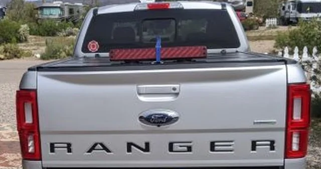

I mounted a wireless light on the tonneau cover and it works well. A couple of 6 inch round steel plates were attached to the cover with screws and nuts. I like that it is high enough to be easily seen.

Pvsaint. I would have preferred that type of mounting but my cover is soft and won't support the light bar. All of my brake lights on the truck come on when I apply the brakes in the motor home so I don't worry about not having enough visibility for the brake lights. My mounting does reduce the visibility for the turn signals.

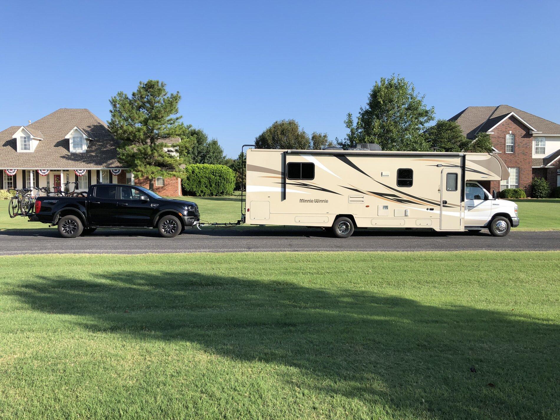

Above is my setup. Just returned from my first 1250 mile trip. No problems. Tows behind my 32 foot v10 like a dream. I weighed it with my tools, a full yetti cooler and a few other items. 4640 lbs. Well below my 5000 lb legal tow weight. I am using a Brake Buddy with a Blue Ox tow bar, a cheater charge wire to the battery and every night after a long day on the road, I always hook up a battery tender. Over doing it but it works.
