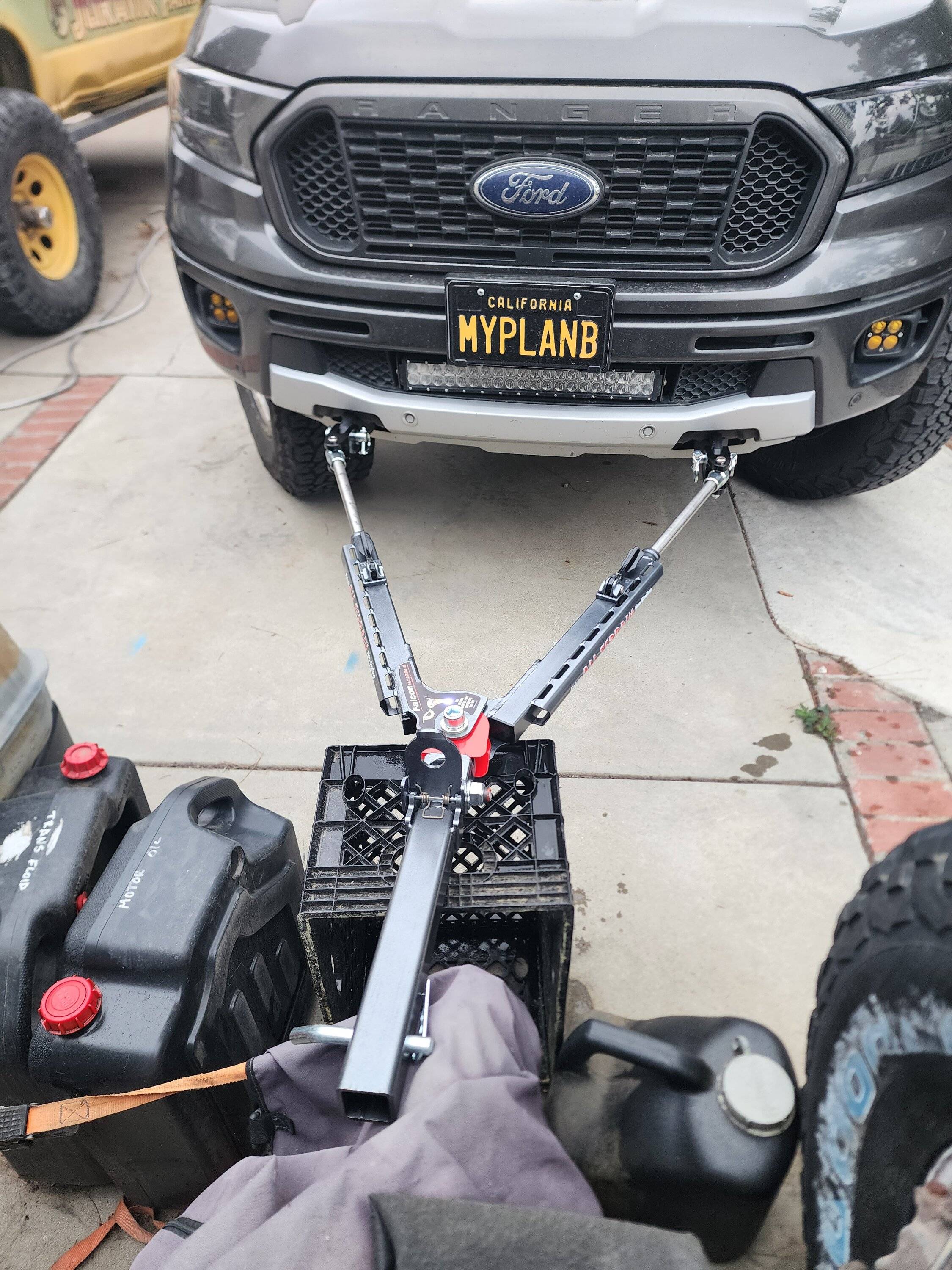

No Base Plate needed ?
Prepping for a coast to coast trip, and came up with this stealth set up.
  • Rough Country Shackle Mount
  • Blue Ox Shackle Adapter
No ugly base plate, D-Rings in place when not being towed.
More to come on this stealth set up. ?

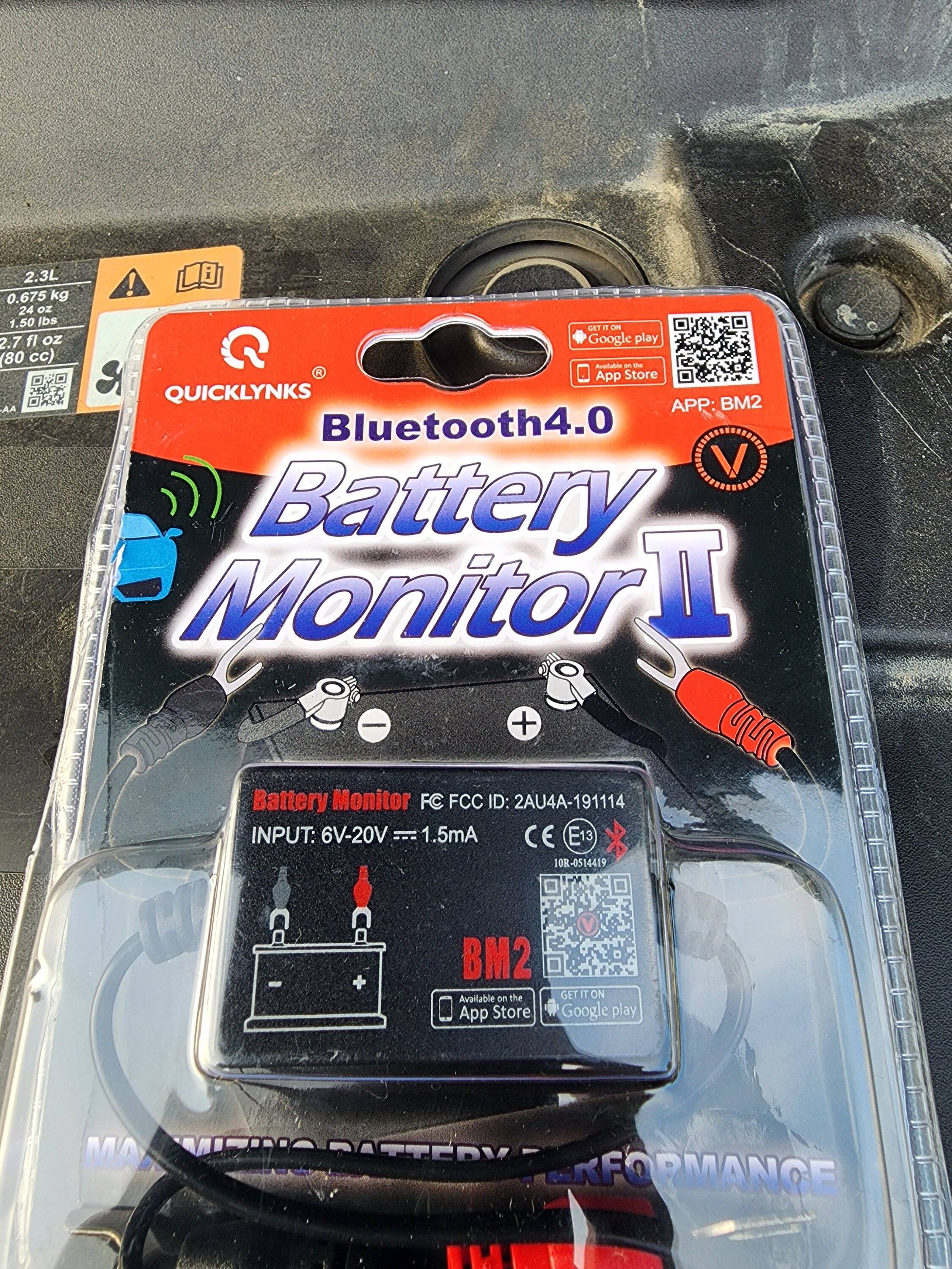

Just picked this up . Remote battery monitor. https://a.co/d/7Ipefwq
Keeps track of battery, has test and alerts. Pretty cool, and great for making sure the battery doesn't die, or at least without you not knowing.
