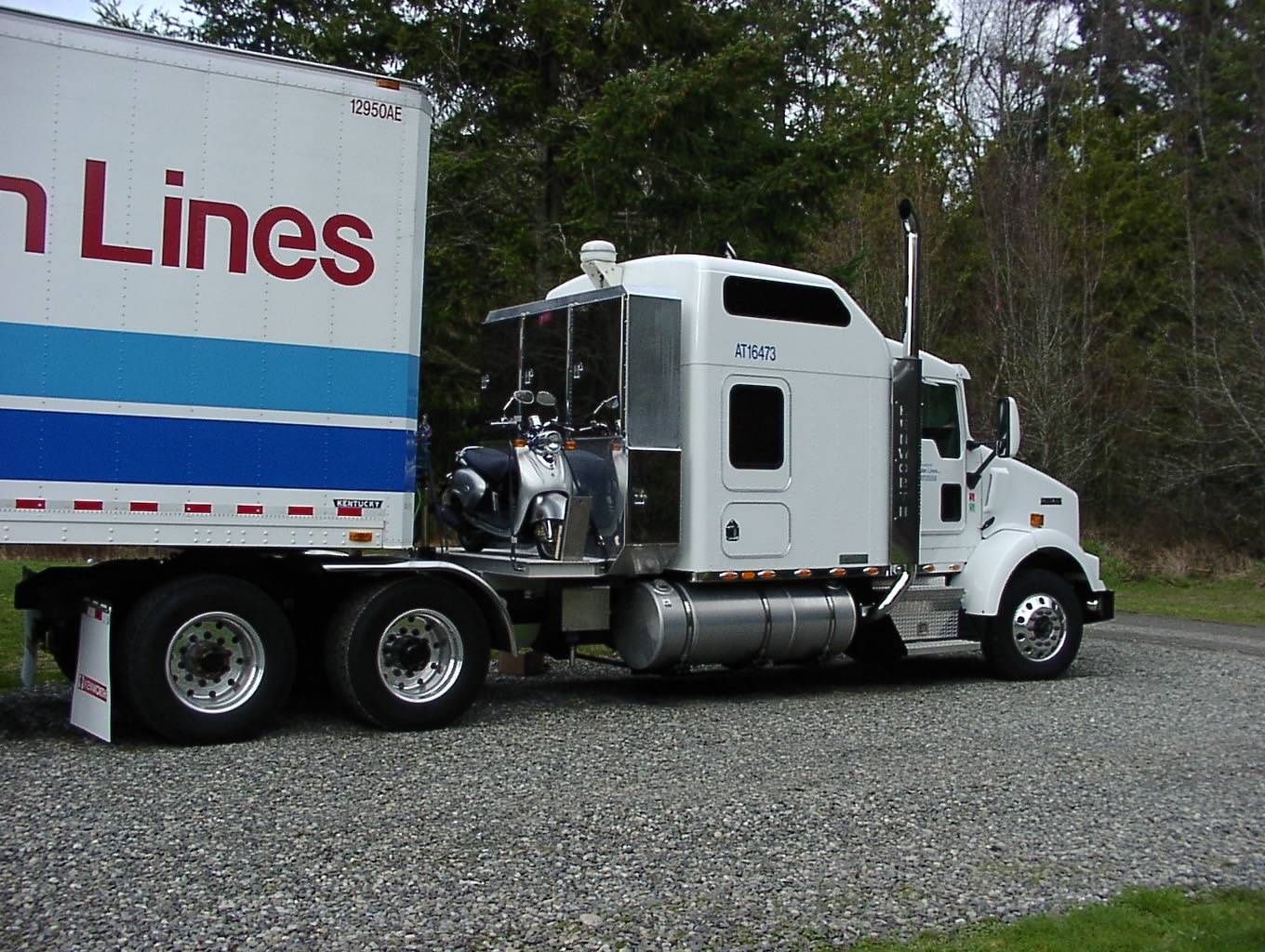

Ranger has a great engine IMHO. I'm a real fan of it.
But physics is physics. If you want stellar engine braking you need displacement. In which case I'd recommend a KW with a 15L Cummins. :like:
Yep. We used to go down 6% grades at 45-50 without ever touching our service brakes....
Was my younger years. But yes sir, been there. Done that.
