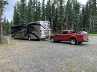

Finished my first extended tow a couple of weeks ago and all went well.
My setup is the Ready Brute Elite Tow Bar with the integrated Ready Brake surge brake system. Also have the Roadmaster diode kit for the lights and have a charge line to the Ranger. Towing behind a class A motorhome on a 2019 Ford F53 26K GVWR chassis.
Tow was 1,000 miles where I unhooked the Ranger in the middle of the trip and again at the end. I did have one unusual indication each time exiting Neutral Tow. When exiting Neutral Tow I get a “Check Brakes” warning message in the dash display. I select OK, the message clears and no other message or warning is displayed. I have seen one other report of this on the irv2.com forum. Has anyone one on here seen this?
