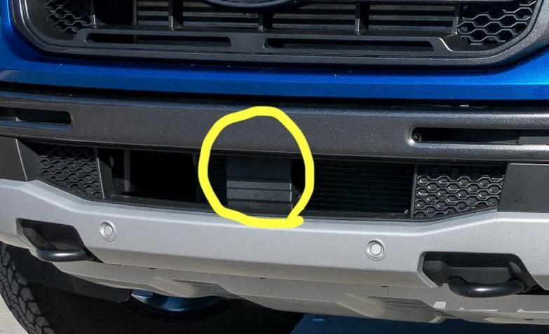

Question for you towers. I'm starting my (Blue Ox) components installation tomorrow. I've got to find a front bumper location for both the 6-pin socket and the breakaway module. But, right in the center of the bumper is the Adaptive Cruise and the Pre-collision radar sensor. It's a black 6" x 6" block mounted vertically. I'm worried about putting my tow pieces near that sensor and interfering with its operation. For those of you who have mounted items in that area, how did you work around that radar sensor? I could mount these pieces under the bumper, but that gets them much closer to the road surface.

Hi John,
I packaged my connectors and wiring to fit my Alfa Diesel Pusher anywhere I needed for a clean in stall. Breakaway swith is left and above the ACC module...Have towed with this set up for about 2000 miles...no issues with the tow or with the Ranger on its own with the stowed wiring.

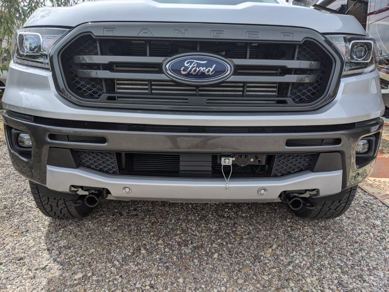

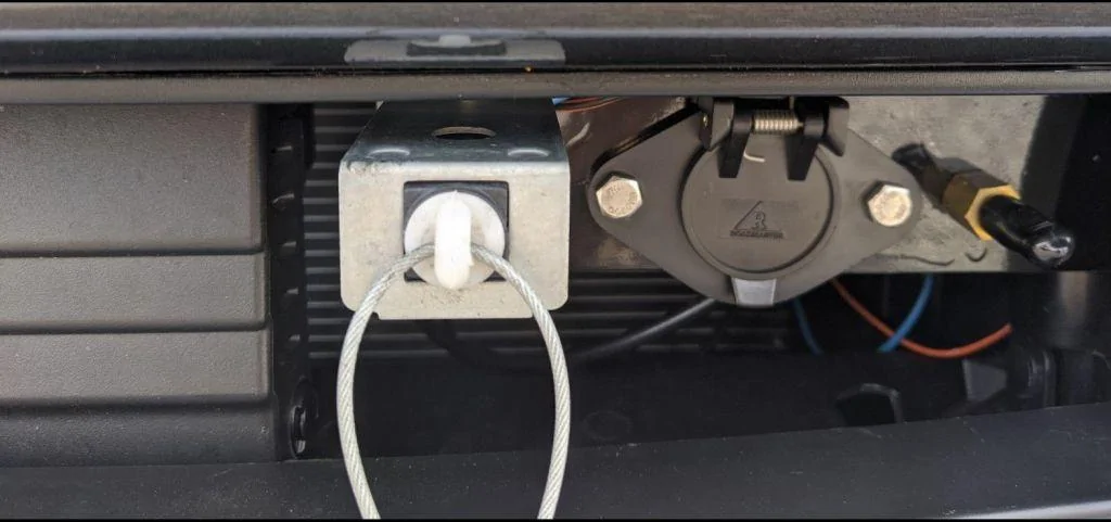

I used a piece of aluminum angle iron and attached it to the bolt that holds the bumper.

Wow. You're right next to that sensor. Any issues with the operation or performance of your adaptive cruise functions? Thanks for the photos of your setup.
No problems with the ACC. I use it regularly really like it.

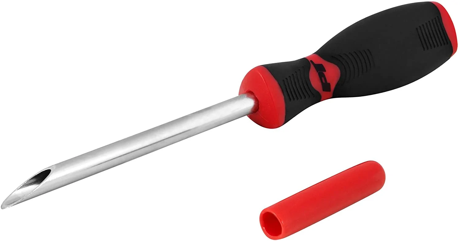

For going through the fire wall I use this tool to go through the rubber grommet on the side of the wiring harness.
Wire Insertion Tool - Piercing
