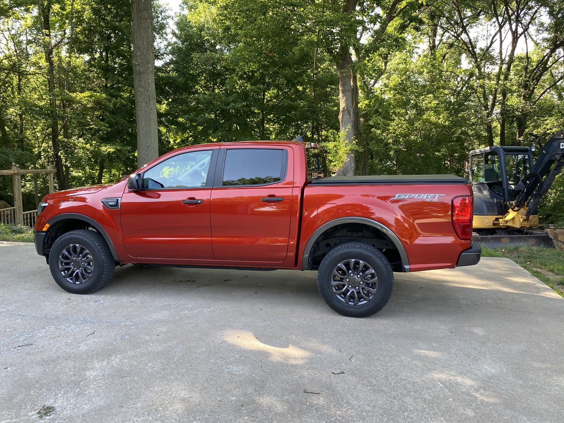

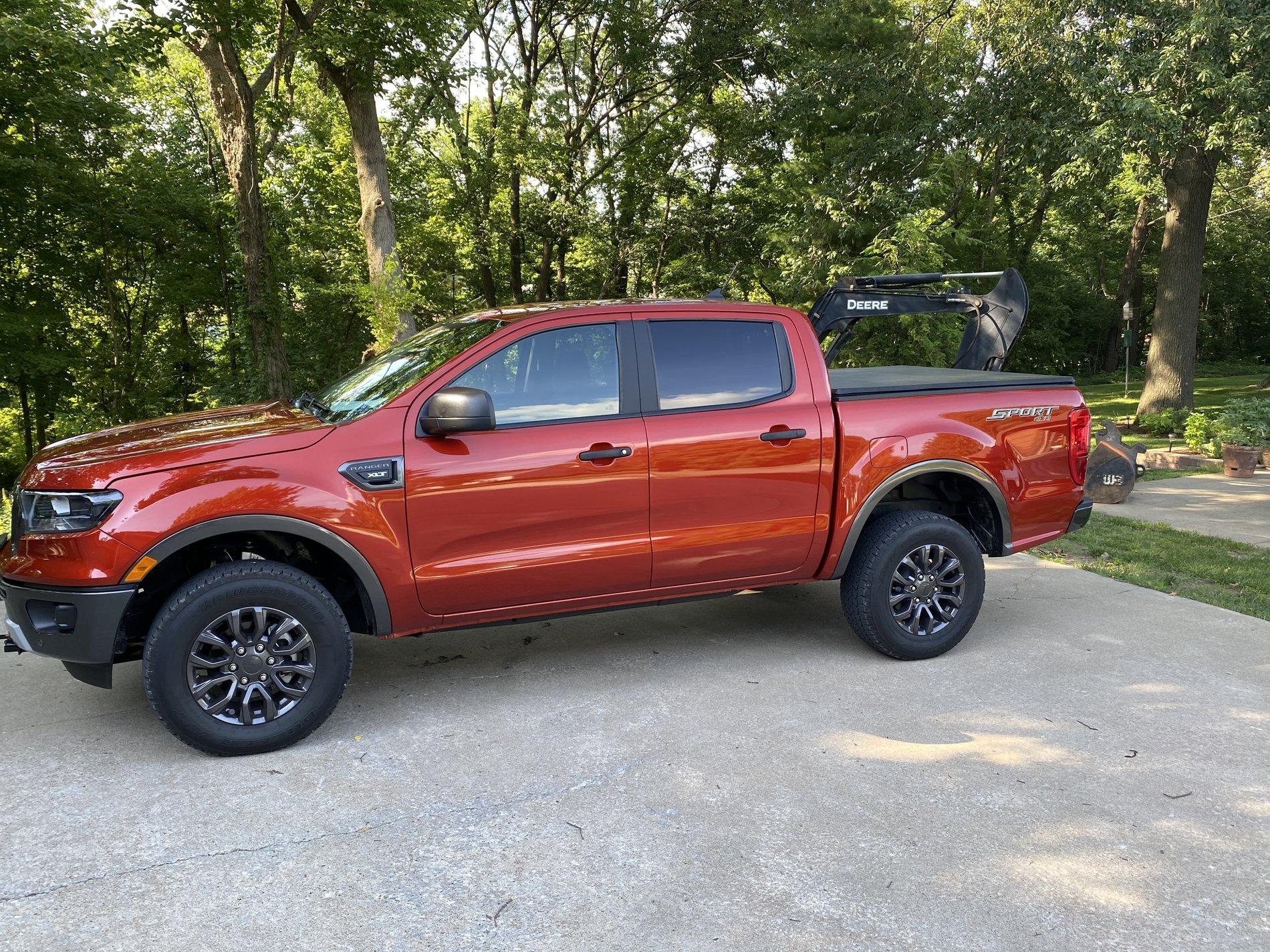

I picked up my new 19 ranger today from my Ford dealer. Part of the deal was he would install my stuff. New Blue Ox tow plate. New Brake away, New hot wire to keep the b attery charged. 12 volt plug for Brake Buddy. And diodes on the lights. I will try to hook up and give it a practice tow soon. But it looks good.

That's a pretty sweet deal. I paid close to $1200 for parts and labor to do the same thing. Looks like you have the same set-up as me. Good luck with it.

I’m curious how it tows? I will hook it up and do a trial run soon
