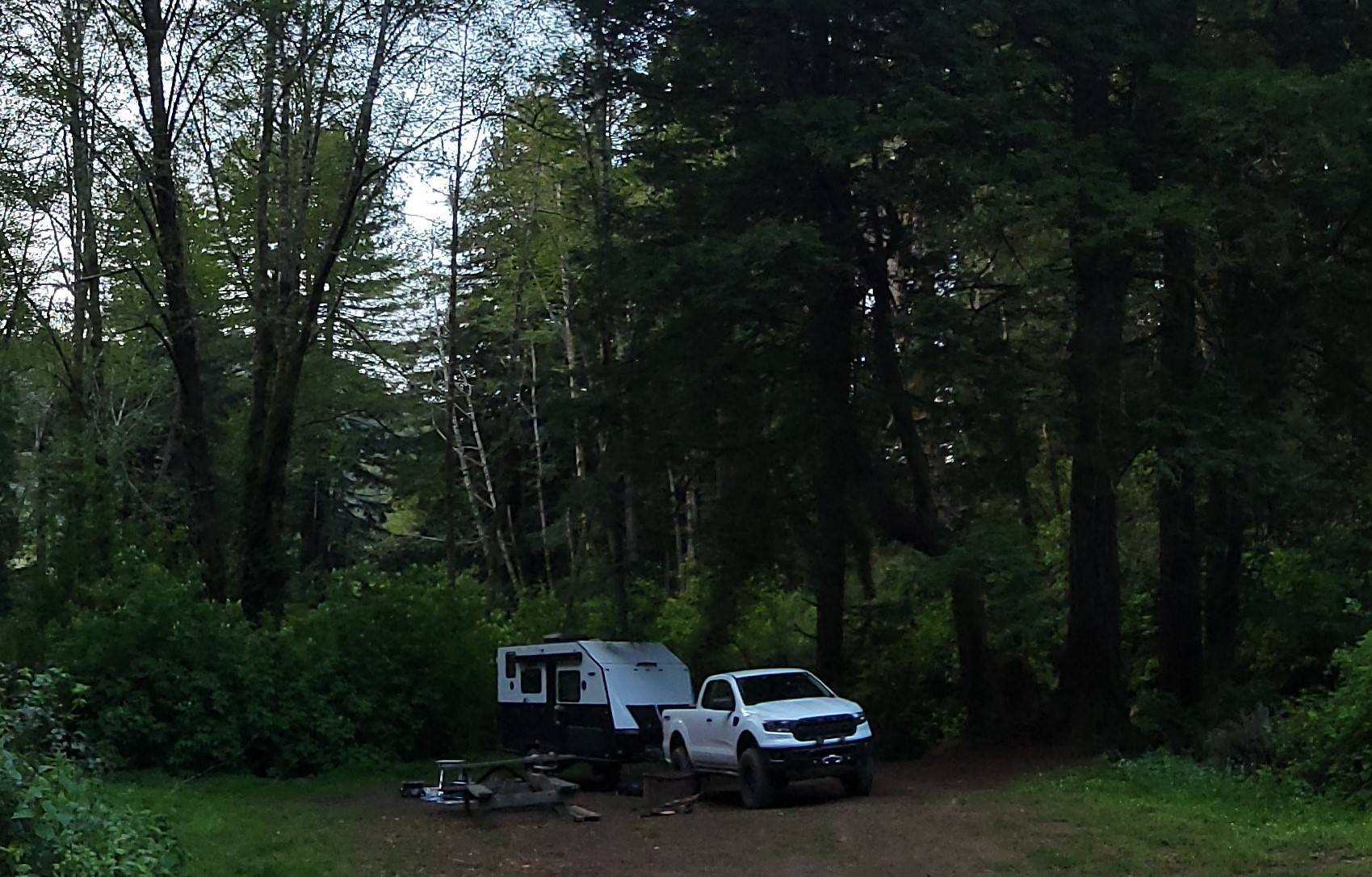

We've got almost 32K towing a Black Series HQ15 that weighs in around 6K lbs fully loaded. As much of that as we can manage is off-road or hard to get to places. We adhere to a 5K service interval and have beefed up the suspension. The only problem encountered so far was "hot spots" at around 15K miles on our rotors due to the trailer brakes not being adequate. We upgraded the trailer from the crappy China sourced drum brakes to electric-hydraulic disc and have been fine ever since.
To be honest, we didn't buy the truck intending to tow a 6K trailer, but the possibility of doing so was on the filter list, and when it turned out that towing the trailer is the way to go we never had second thoughts and have been quite pleased. We're headed to Mohave/Death Valley shortly, and then Alaska for the summer. We'll get another 15-20K miles this year if all continues well.
Here we are tucked in for the night under some redwoods about 5 miles off of Highway 1 in northern CA.
