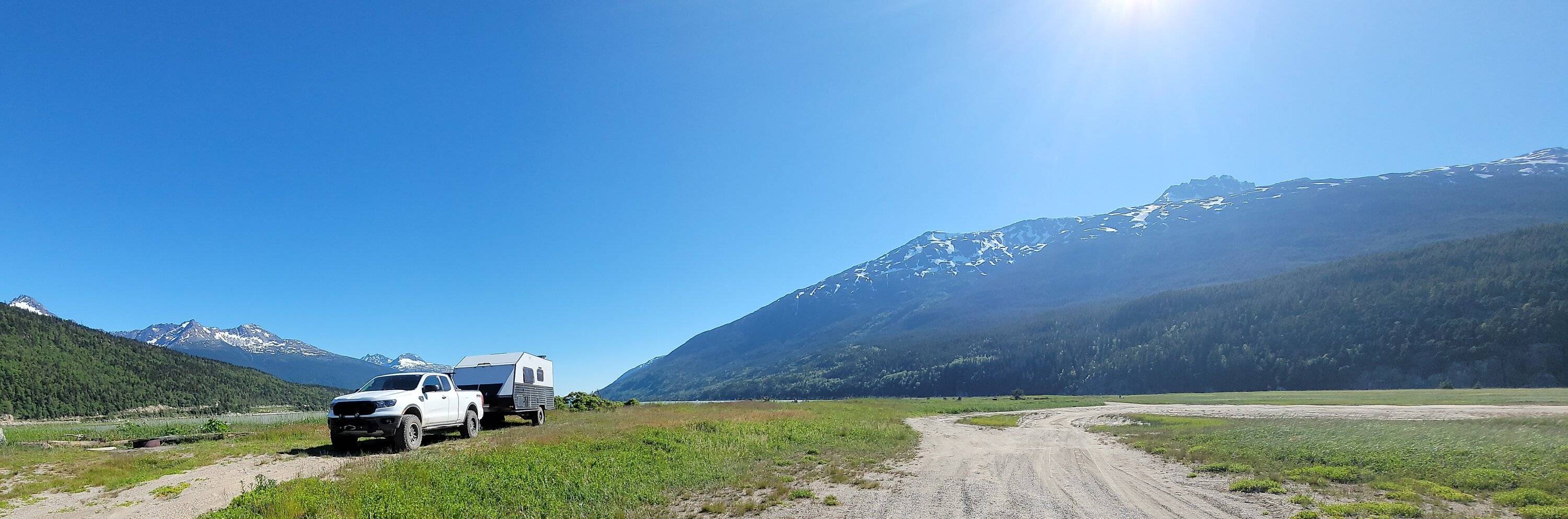

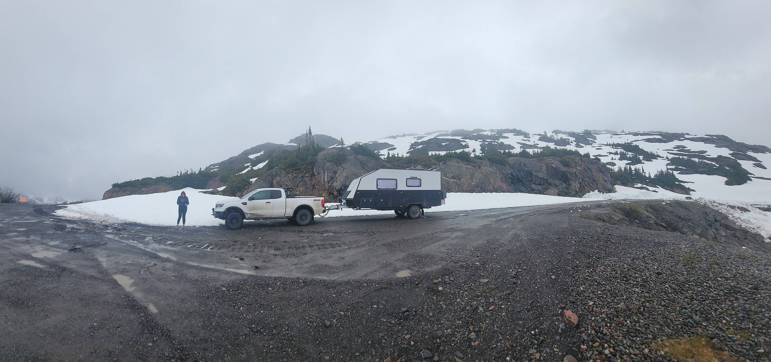

Just chiming in to note that we've now towed our 6,000 lbs trailer (fully loaded) for 45K miles with no issues. 1,150 of that was the Dempster Highway, which is not steep, but definitely takes a toll on the suspension and underside of the truck (and trailer). Non "Fn Ranger" people continue to bag on this truck....I just continue to be impressed. Just had a discussion yesterday with a friend who tows his 8,000lb trailer with a 250 Tremor. We get about the same fuel mileage at 10-11 miles per gallon between 55-62, but agreed that I can get my rig (shorter truck and shorter trailer) into way tighter spots. He doesn't use a WDH, I do, but remove once we go off-road. Here we are at the summit of Salmon Glacier in BC and on the tidal flat in Dyea AK.

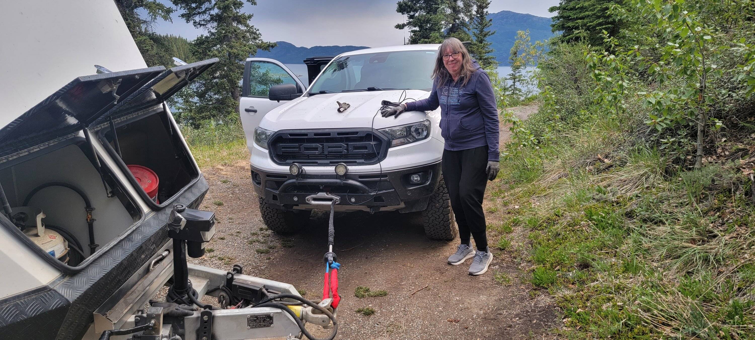

We always carry two 5 gallon harbor freight cans on the back of the trailer, plus I have a 2.5g that I use to fill the generator. Of that, while we did use fuel from the jerry-type cans from time to time for convenience in the north, the only time we really needed it was, as you expected, the run between the start of the Dempster (two fuel stations there) and Eagle Plains, which is about 230 miles. After Eagle Plains the fuel stations are close enough for our 18-19g tank to make it with the trailer.
Re towability - even with the excellent turning radius that the Ranger provides, we do occasionally get into someplace where we have to unhitch and spin the trailer. Here we are just south of Destruction Bay on Kluane Lake.

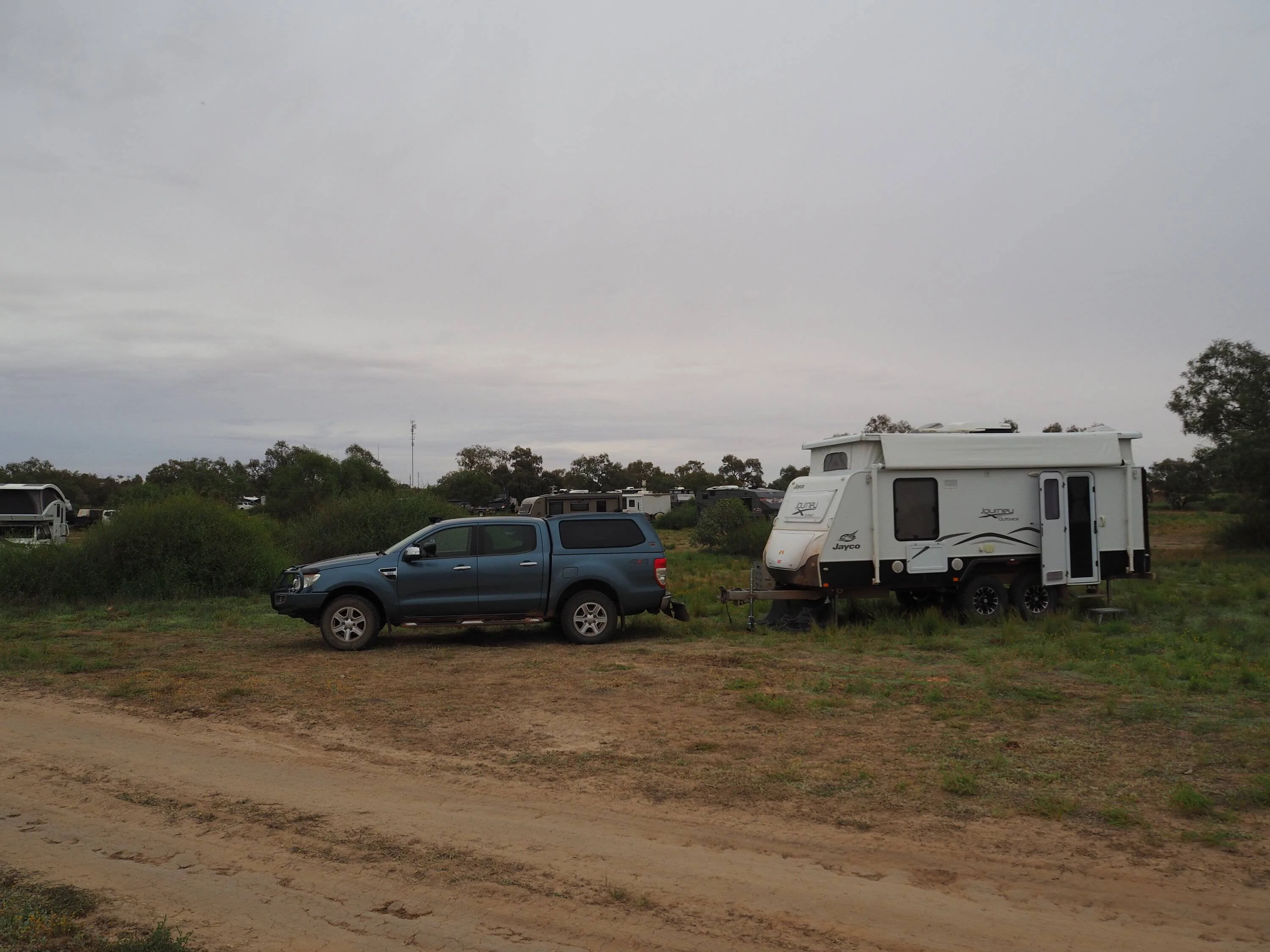

How about a photo of your "down under" rig.....
Happy to oblige you sir! This is us parked up in the Birdsville common on the way out to the Big Red Bash music festival at the edge of the Simpson Desert- proudly promoted as the World's most remote music festival. This was BEFORE it got dirty.
