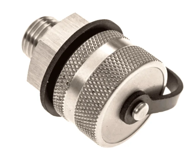

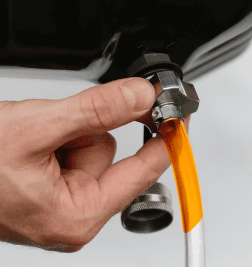

I installed the valvomax so It wouldn't be necessary to remove the skid plate! No wrenches or tools required and oil flows through the clear hose straight into whatever you wish. Very little cleanup.
Installation is fast, simply remove the drain bolt and install the Valvomax. To use, you simply remove the captured stainless steel cap and screw on the drain knob with hose. I route the hose through a hole in the skid plate and tighten the drain knob. Oil will not begin flowing until the knob is fully seated and sealed. It takes a little longer to drain the oil, but I move to the filter as soon as the flow starts.
By the time I have the filter primed with oil and installed, it's time to remove the drain knob/hose and put the captured cap back on. All done.
I don't remove the tire to change the filter, just turn the tire fully to the right for easy access.
I liked this product so much I have added them to my 2005 Ranger, my 93 Miata LE, and my CX-5.

Who still takes the skid plate off to change oil? Put a Valvomax or Fumato valve on with a hose and do it with the plate in place. No need for cardboard deflectors either. Just put the hose in your pan and open valve.
You still need to take off the skid plate first to drain oil and install the valve, correct?
True! But, that's the last time for an oil change. Be prepared that first time can be a messy one. 6 quarts of oil comes spraying out pretty fast, definitely need a deflector of some kind.
Call me what ever I need to be called, but I just see something that can fail. When I install the drain plug & washer I am pretty confident it will not leak. Paranoid will work I guess. Just me. :cool:
