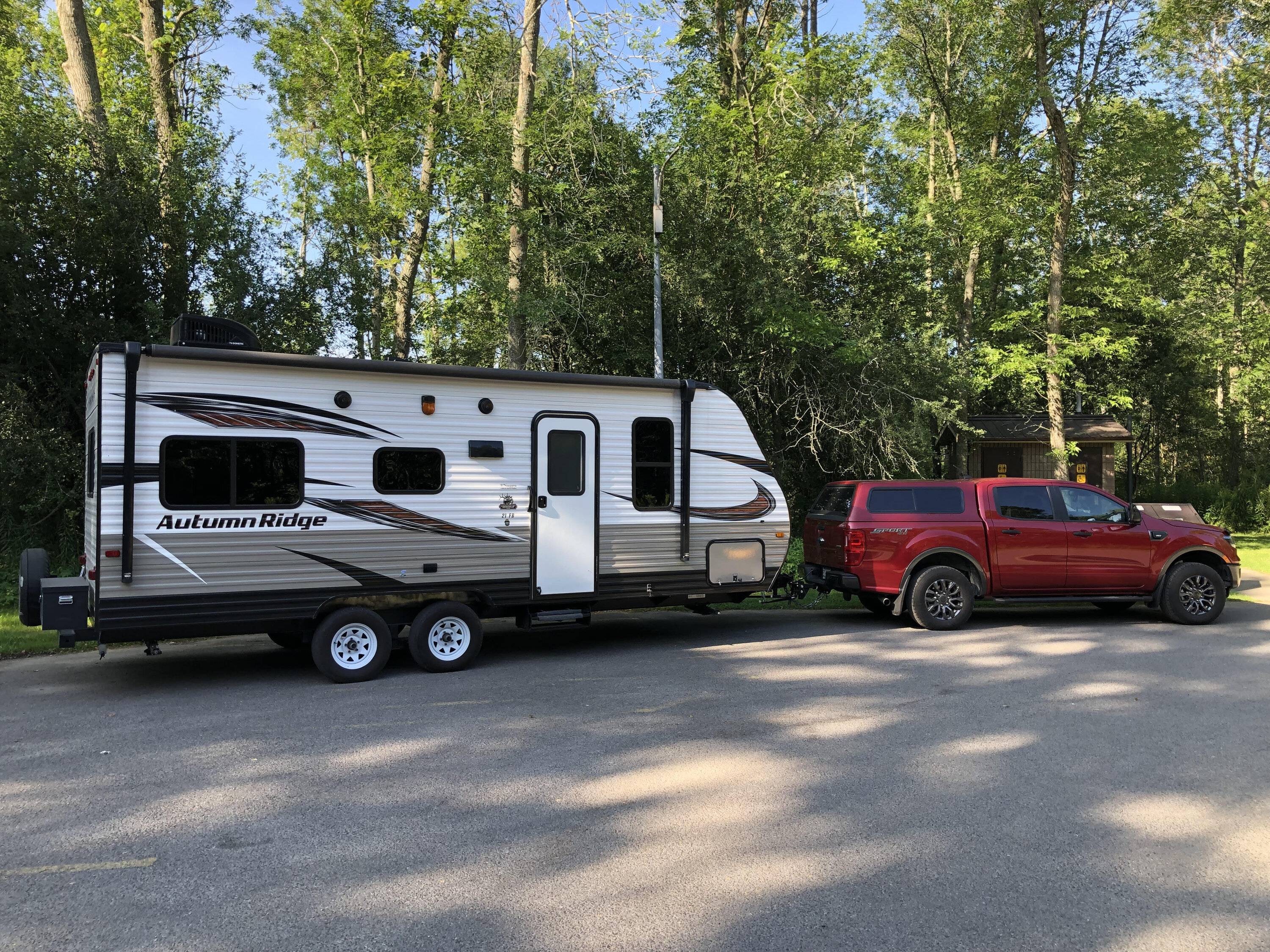

To date my truck (2020 XLT Sport) has 90,000 kms on it and 30,000 are pulling my TT. It is a 21 ft trailer and fully loaded is just over 6000 lbs and 650 lbs on the tongue. I use a Husky round bar WDH with 800-1200 lb bars. I have a Tekonsha brake controller and it works great. With the trailer on I do not exceed 65 mph. If I could offer any advise, make sure set up is done properly, learn off Interstate roads and leave lots of space in front of you. You won't stop on a dime, ever.
