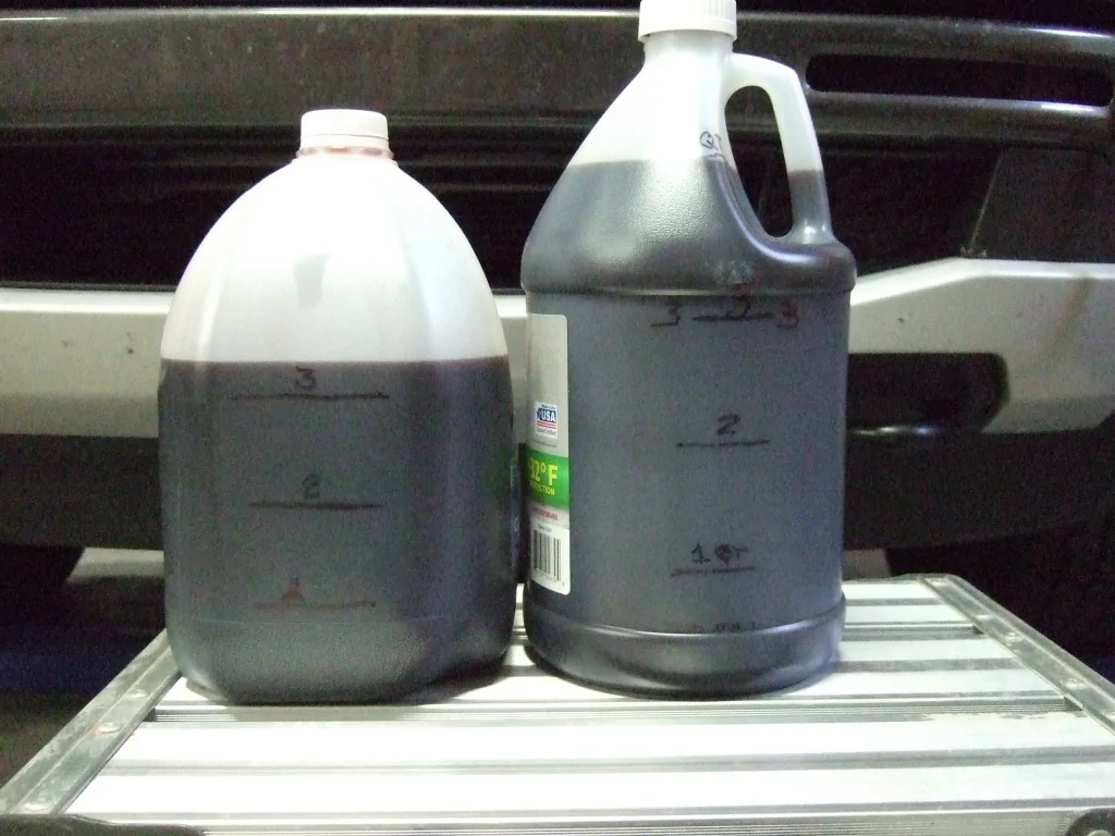

I doubt those modifications will void your warranty. This is what you are up against.
This is the used Mercon ULV fluid that I pumped out of my 10R80 transmission at 18,000 miles! It is as black as coal! Looks like diesel engine oil!
When new, this fluid new is a cherry red translucent oil. My transmission was acting crazy, so much so that I let it sit for 8 months while I investigated what was going on and how to limit further damage. I changed the fluid 3 times in 1,000 miles and added LubeGard Platinum, then ran the "The 10R80 Adaptive Learning Drive Cycle Perform after any reset or fluid change" procedure. All the craziness ceased.
However, to prevent a recurrence, I put together an action plan and have implemented the steps that I believe will eliminate any further issues with the 10R80 transmission.
Steps I am doing to insure my 10R80 Transmission has a long life
  1. Install a MBS Dipstick - Done
    - This allows easy fluid level check and with a $15 transfer pump you can remove 60% of the fluid and replace with clean without the need to crawl under and drop the pan. 3 cycles of fluid change over 1,000 miles will give you 95%-98% clean fluid. I get 7.5 qts out each cycle.
  2. Install a high quality aluminum pan - Done
    - Drops fluid temps by 10F-15F
  3. Install a ScanGauge - Done
    - Set it to monitor transmission fluid temperature. The try to keep it below 200F.
  4. Add the performance tune of of your choice - Done
    - And before you buy makes sure they have modified the transmission shift points to remove the low speed lugging. This will further eliminate heat build up
  5. Add an external transmission cooler - Purchased, and in modification process to install
    - This one is the hardest to accomplish, but has the biggest payback. Target fluid temps to be 150F - 165F, and set cooling fan accordingly. Fluid temps at this heat range will insure the ULV will last for 100K miles.
    If you can't or will not cool the fluid to this level, expect to need fluid changes every 20K-30K miles. Plan and execute unless you like paying Ford for a new transmission.
  6. Reset transmission every 30K miles or at the first hint of transmission shift changes. - Done
    It's quick and can be done in 30 minutes simply following the driving procedure below.
