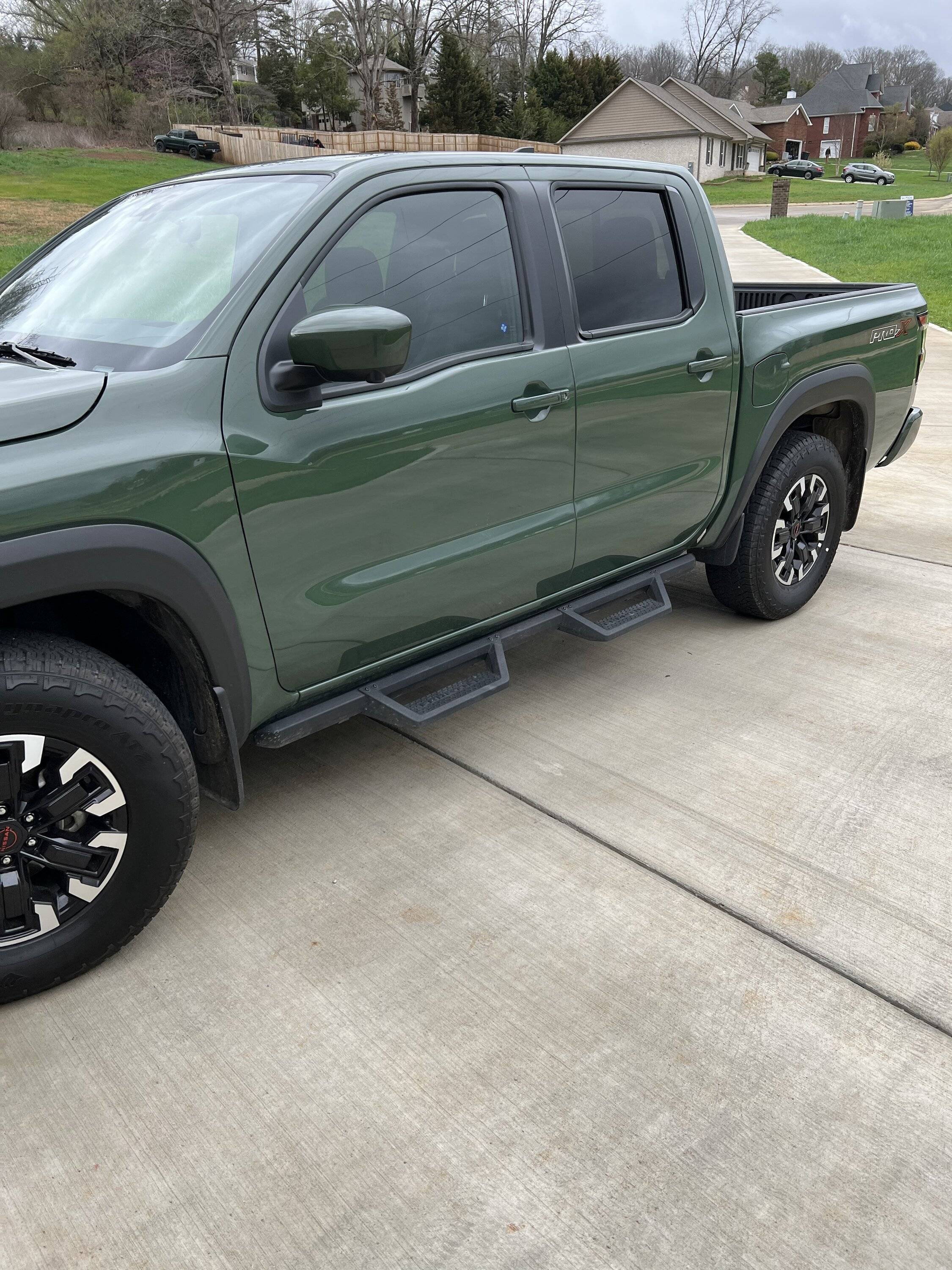

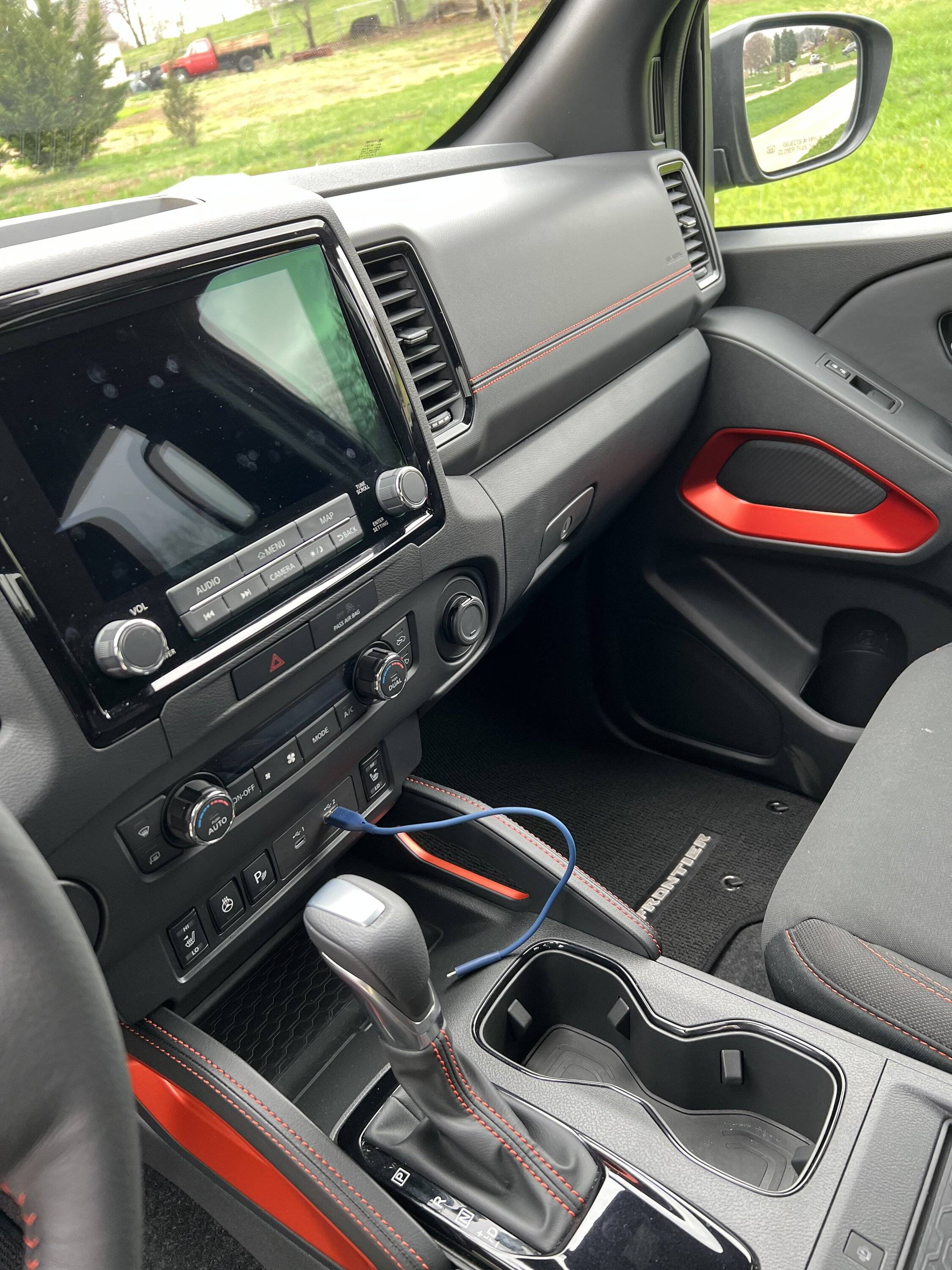

So honestly it’s hard for me to believe what they’re charging for these Frontiers. I mean definitely not bad but lacks a lot of the things the ranger has. Steering wheel is very hard to turn and I’ve never said that about any vehicle. Some weird vibrations in the pedal when accelerating quickly. Reminds me more of my 02’ Tacoma. Interior is much better though out with more storage. Rear cab space feels more cramped. I like the black ceiling in the truck though. Bedrails are really neat. Overall not a bad truck but for what they charge I’d be tempted to go up to a full sized. This is just first impressions but with my obsessive nature I can also pick apart every minor detail. Was my job to do that for years. ?
