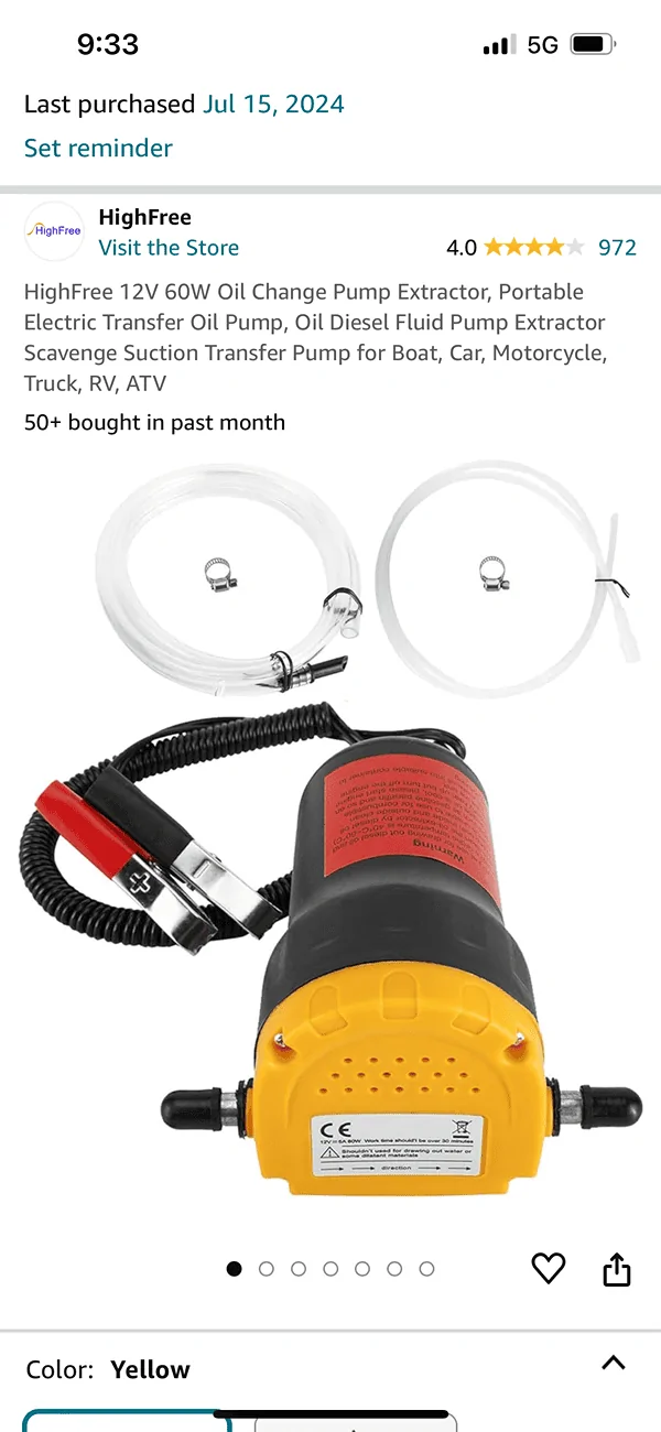

What extractor did you get?Look to change my fluid soon and get the Fitzstick.

Update: Did the Lubeguard swap today with 650 miles on the new transmission. 4 heavy tows and it’s performing flawlessly. Very pleased with the outcome so far. Fluid swap went great, the only issue was feeding the suction hose past the Fitzstick fitting in the transmission. Had connected both hose’s to the pump before feeding it down the dipstick tube. After fussing with it for a few minutes I disconnected the suction hose from the pump and was able to feed it fully into the transmission.
How many quarts did you suck out and how long did it take to get the fluid out?Thanx
Sucked out 10oz . Probably about a minute. Just took enough out to substitute it with the 10oz Lubeguard bottle. The transmission is brand new so only 650 miles on the fluid.
