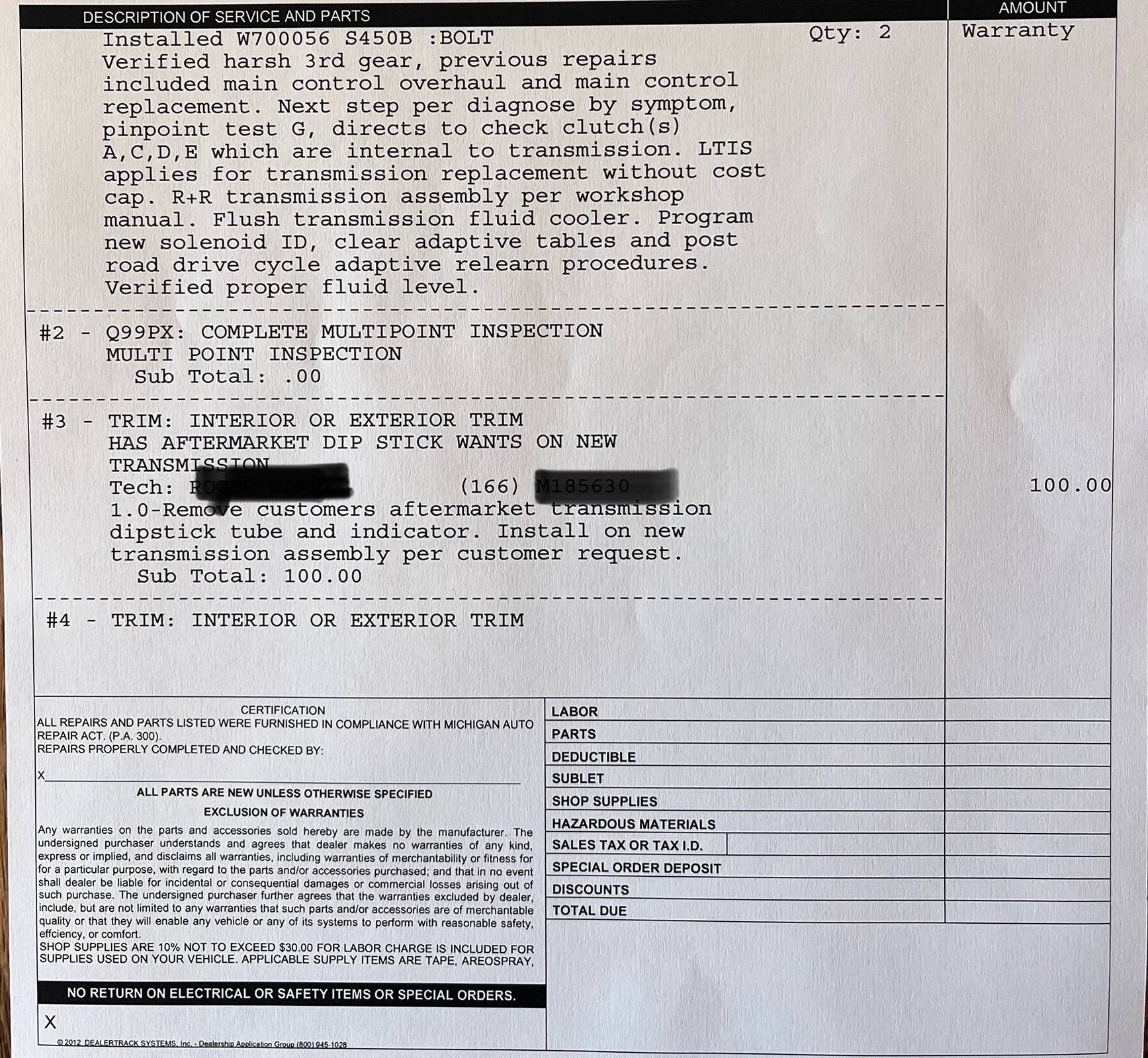

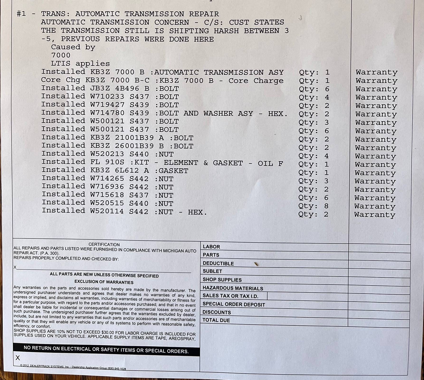

New transmission at 17750 miles
Stevedbvik1
Stevedbvik1
Oct 4, 2021
2,865
8,657
2022 Ranger Tremor XLT
How's the whole trans toast at 17k on a vehicle barely a year old?!
THAT is crazy. ? I'm glad they're doing it for you. Just so odd. You should have the updated drum. You'd think it would only require, at worse... a new valve body to be up and running again.
Why's the whole thing toast. That's nuts. Not confidence inspiring.
It’s a 2022. Took delivery 03/31/22 so it’s two years and 3 months old. It didn’t have the updated drum because it was built before 08/16/22.

Ok, I have my Ranger back ?. Just a 3 mile drive home on side streets so nothing to report yet. Besides I have to put some miles on it to do it’s learn thing. In the shop just short of 3 days. Had them check the slip yoke while they had the d/shaft out and all good there. They had no problem swapping my Fitzstick onto the new transmission. Just billed me an hour to do it. Wasn’t going to argue with them. Again it’s been a really good and smooth process for me. I’m lucky to have a good dealership.
Ugh. Sorry man. I guess it's faster to swap in a new one than tear down and replace the drum.
Probably cheaper in the long run for them. By the time that bushing moves, the trans has been slamming and slipping shifts to some extent, so it has probably chewed through some of the frictions. No sense tearing the thing down to replace the drum and not replacing the frictions, so now you're starting to stack a bunch of labor on to the tab. You've also now shed all that material into the trans, which is also not great.
Better to just swap in a unit, get the other one back as a core, do the failure analysis, and start up your remanufacturing program.
