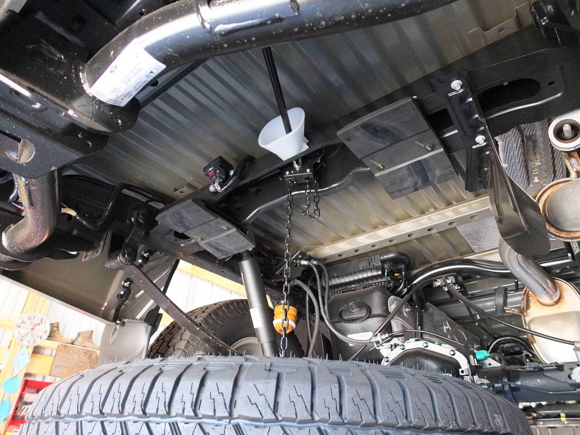

BTW, the user manual is really unclear on where to insert the rod to crank it down. Where it looks like where you put it, there is what looks like a key hole.

You pop that piece out by unlocking it with your key. Look in and slightly to the left, there’s a cone there that the rod goes in to lower it down.

This, plus having to drop it is the perfect time to clean and lubricate the hoist and cable.
It's a painted chain... not a cable.

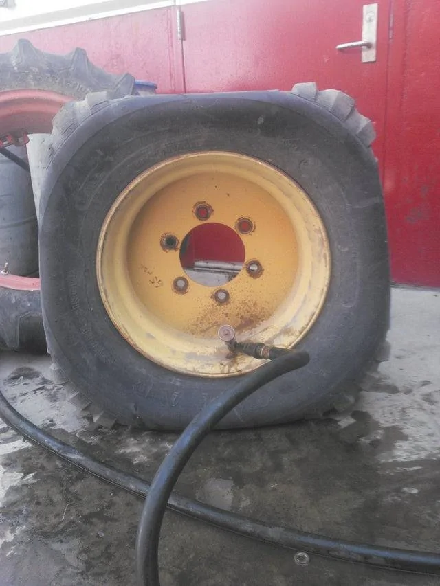

Also gives you a chance to make sure it is still round, and not deteriorated to something like this....

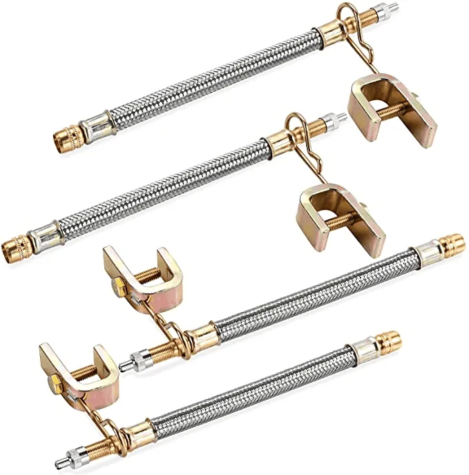

I used something like this. Whenever I take it in to my dealer for "The Works", I ask them to check the spare and it's never been an issue for them.
OK, I like that approach... Amazon ( Flexible Valve Stem Extenders Stainless Steel )has them for $13 at a length of 12" and $10 at a length of 7" (set of 2)
If you used this product, do you have a recommendation which length works best??
PS: LOL... ZD Valve (Chinese) makes these.. and if this is the same ZD Value... I am optimistic about durability...
