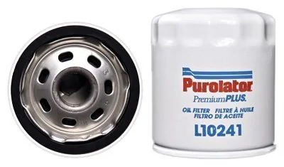

Agreed. Purolator makes Motorcraft filters in Fayetteville, NC.
I can't imagine using anything other than a FL-910S or L10241 for my Lariat. Full synthetic oil is a must IMO.
Champion Labs makes the OEM Motorcraft filters ( new production) and Purolator makes the Motorcraft aftermarket filters. Which makes me wonder which one you would get if ordered/purchased through Ford.

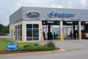

I've watched the local Ford Quick Lane service my Lariat. The driver's steer tire is the last one mounted AFTER rotation and the oil/filter are changed. I suspect this procedure helps somewhat. Stock Image.
