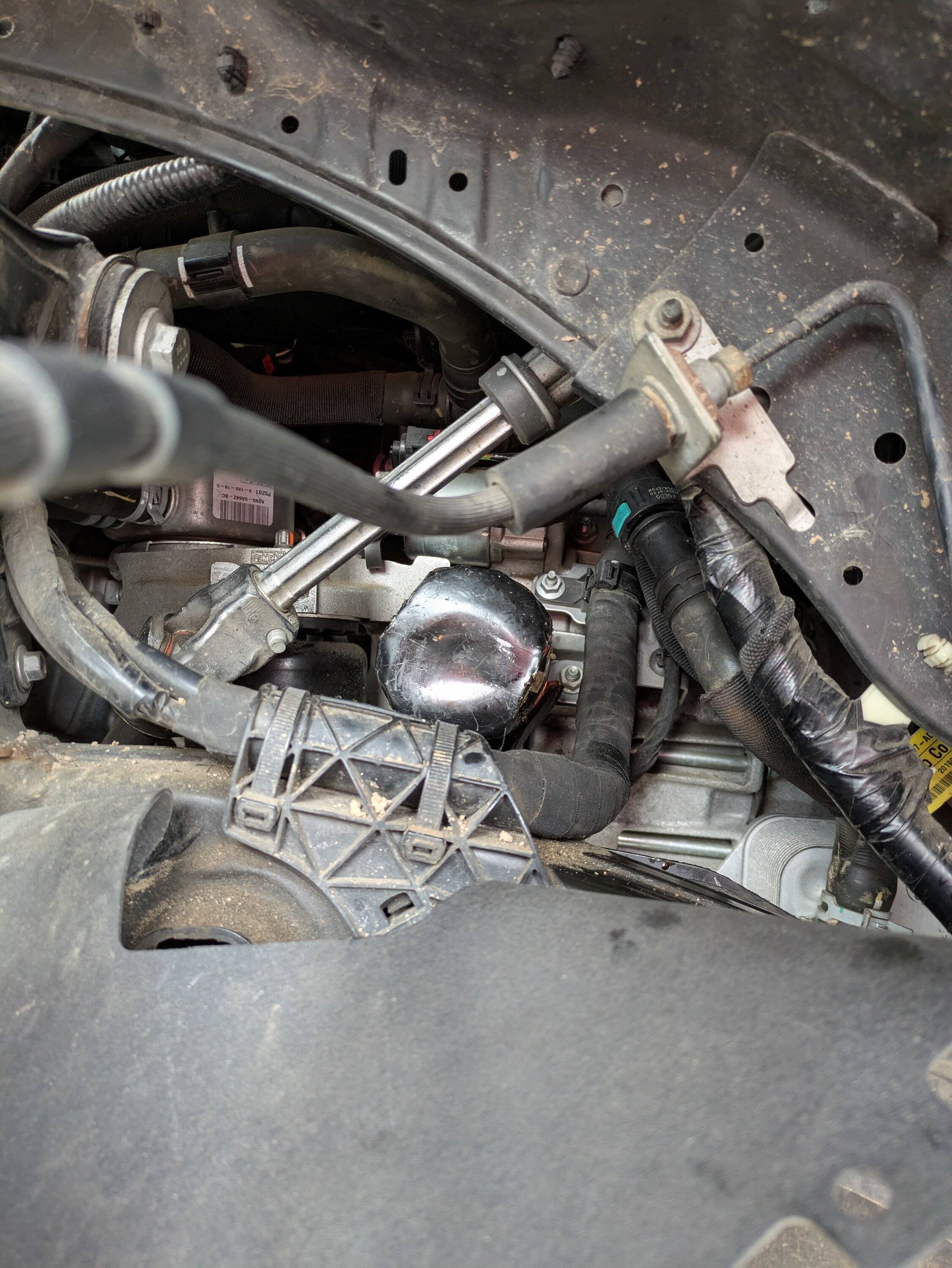

A couple of things I have noticed about these oil filters are the metal can has become a lot thinner. When I hand tighten a filter it will "dent" and then flex back. Never had that a few years ago and I know that I am not getting stronger with age.
Another is to be careful using a flute wrench. I have always used Wix filters but the flute number used to be 15 and now is 14 if I remember correctly on the 51348.
i have always oiled the gasket and did hand tight over 40 years. But I now snug and give about a quarter turn with the wrench. However snug is still ambiguous when describing a method.

This tool or equivalent and this issue you had op will be a thing of the past
Added to Amazon cart thank you. This probably would of helped once the strap wrench crushed the can .
An idea of how secured this sob was. I was rocking the motor in the mounts.

The Amazon wrench works well; if the filter is not tight. If the filter is tight, it simply won't grip it tight enough to spin it off. I had to put a hose clamp around the wrench/filter to get enough grip to spin off a tough filter. Just hand tighten the new filter; it won't leak and it will come off easy the next time.

The Motivx tool is better
