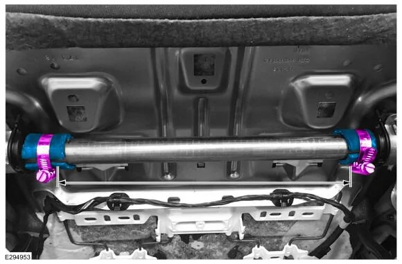

Wiggly front seat? That's a new one to me.
Look for TSB 22-2104. Don't know if there's a newer one, for a long time Ford updated it every year to add the current year (rather than fixing the actual problem).
"Some 2013-2018 c-max, 2013-2020 fusion/mkz, 2013-2022 escape, 2015-2018 focus, 2015-2019 mkc, 2015-2022 edge/f150/mustang, 2016-2018 mkx, 2016-2019 explorer, 2017-2022 f-super duty, 2018-2022 ecosport/expedition, 2019-2022 ranger/nautilus, 2021-2022 bronco/bronco sport/mustang mach-e, 2022 maverick vehicles may experience seat pan looseness, lateral movement, or a clunk/thump noise on turns. This may be due to the seat pan track. To correct the condition, follow the service procedure steps to install a reinforcement."
Note the problem goes back to 2013 and they brought out the new ranger with the same dodgy seats and then sold for years and simply updated the TSB to cover the new years. Then they brought out the new bronco and still didn't bother to solve the seat problem. Quality is not job 1.

This is one step up from coat hangers and duct tape...ironic Ford would come up with this low tech fix...
it's not the janky fix, it's that they've done it for a decade as a dealer TSB instead of just fixing it at the factory. that's just a lack of fucks to give at ford hq.

Some have complained of seat popping on turns, seat base moves side to side.
Ford issued a TSB, and this is the Fix.
Secure the Front Bar from movement with Heater Hose and Clamps as Base Replacement is a $850.00 dollar part, so a band-aid fix with $3.00 in parts
Good thing I've got both hose and hose clamps at work. I don't need to be spending no $3
