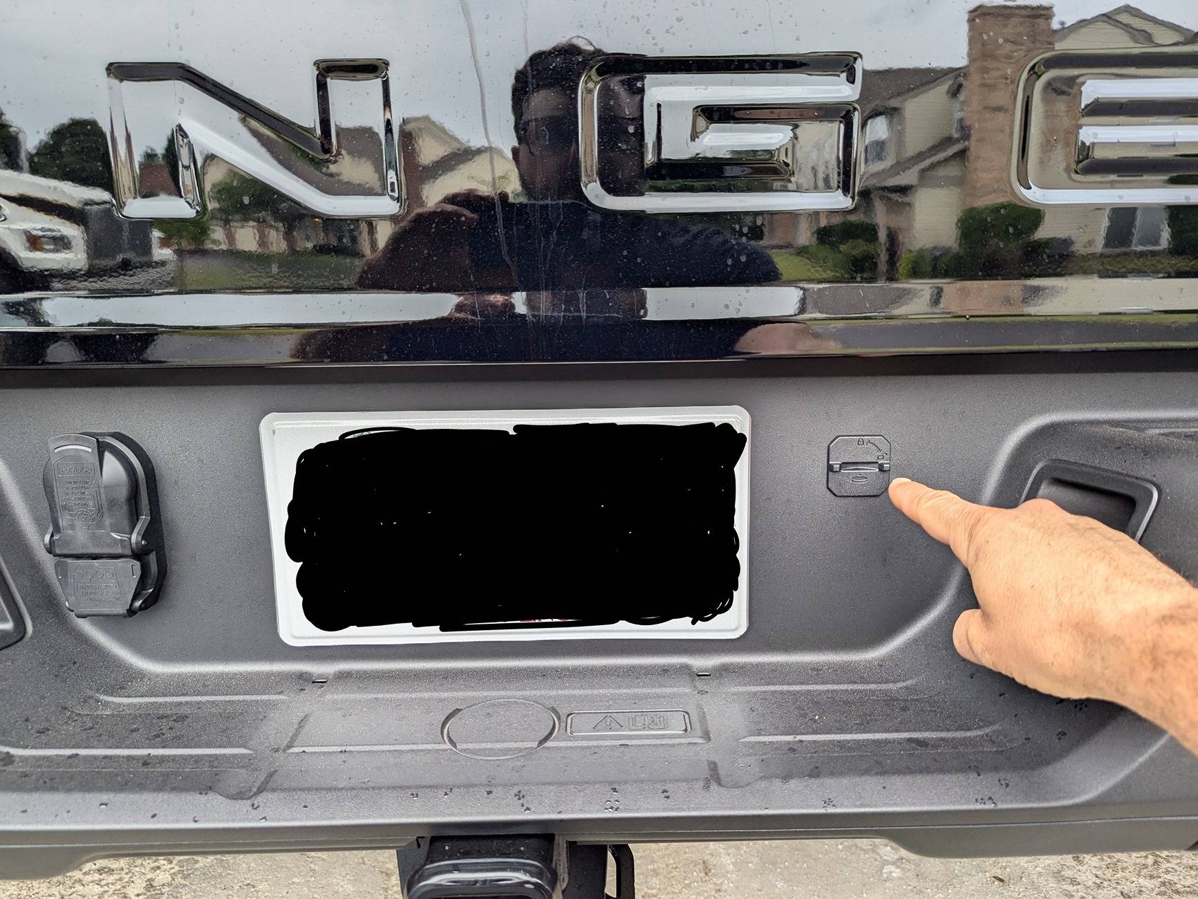

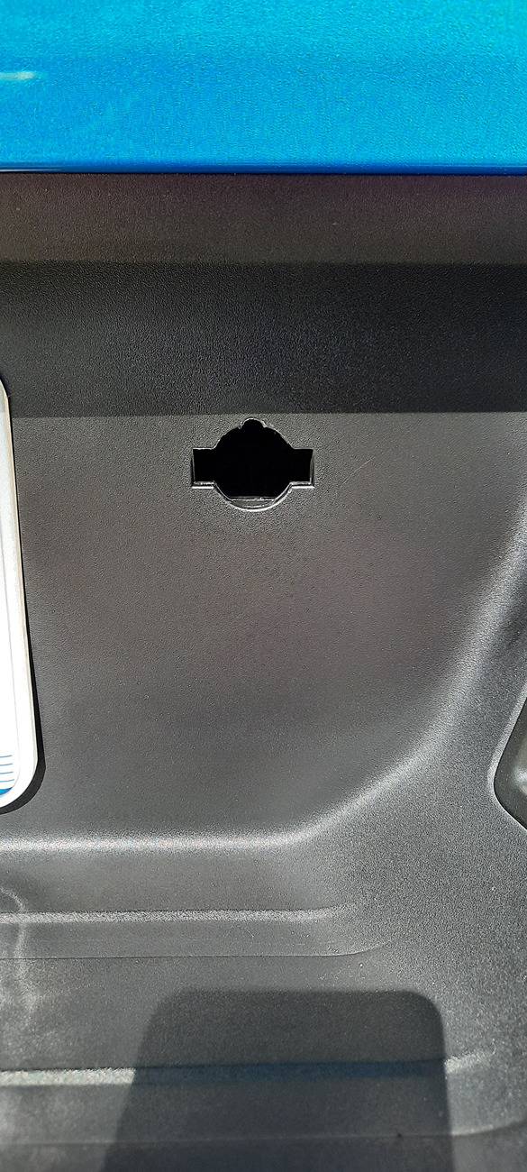

Had an act of stupid yesterday. Saw 5 squirrels come out from under the backside of the truck and decided to drop my spare to make sure they weren't trying to build a nest or store food on top of the tire. Well after raising the spare back into place and getting everything put away I left my lock on the bumper ?
Does anybody know if a 23 0r 24 plug will fit a 22 Ranger ?
And if I buy $30.00 kit from Ford can it be used without re-keying it, so it will act like a plug and not a lock.

It depends on the hole in the Step Pad, if it is the same as the 5G it should work.

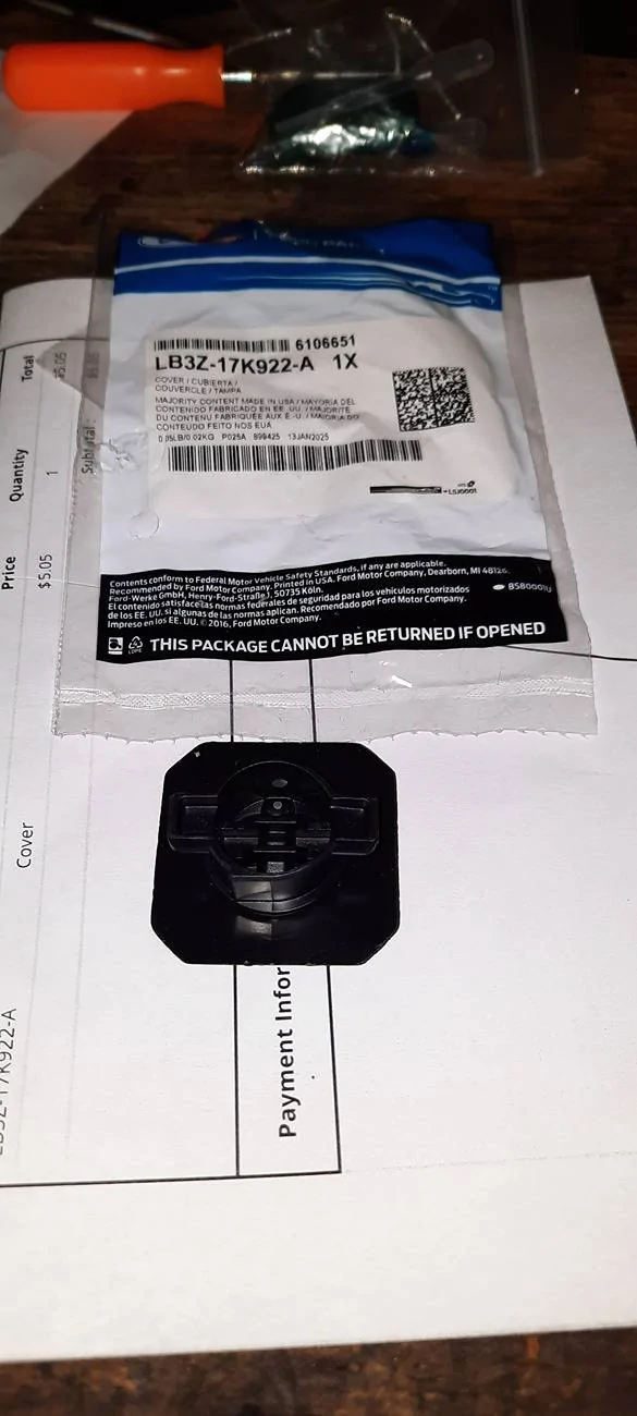

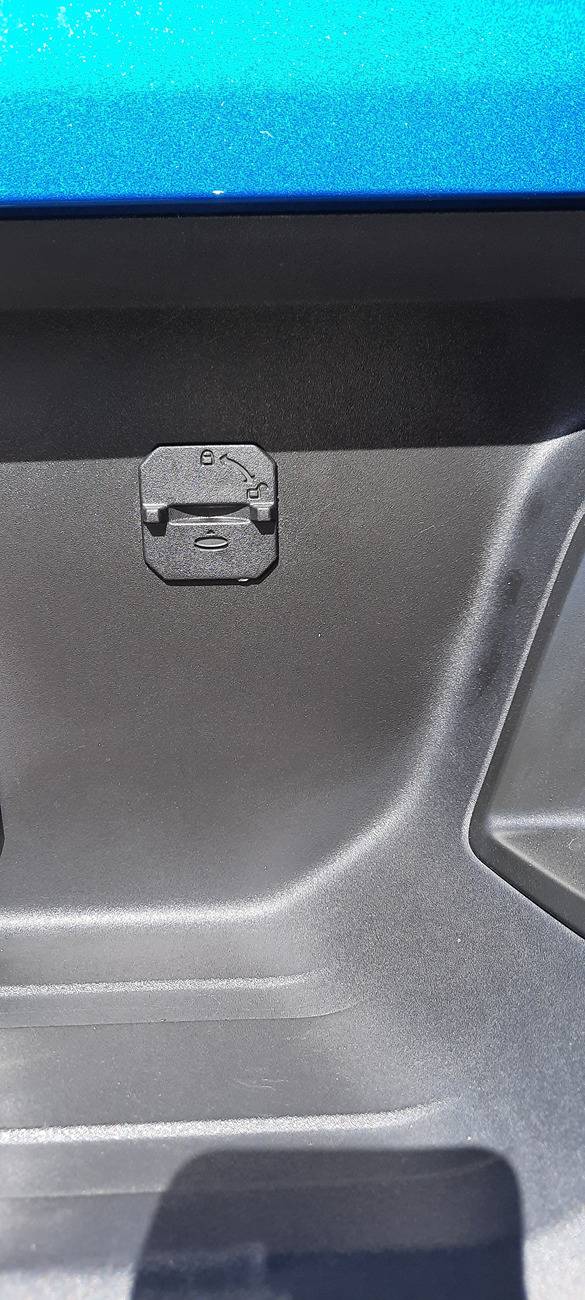

Looks like Sat. is by app. only, so I swung up North on my way to work today and picked up the cover.
Nobody likes a Dirty hole. 303 to the rescue
Went right on. Fit like it was made for it. Just turn it 90*
There is no stop so you'll have to center it up yourself.
