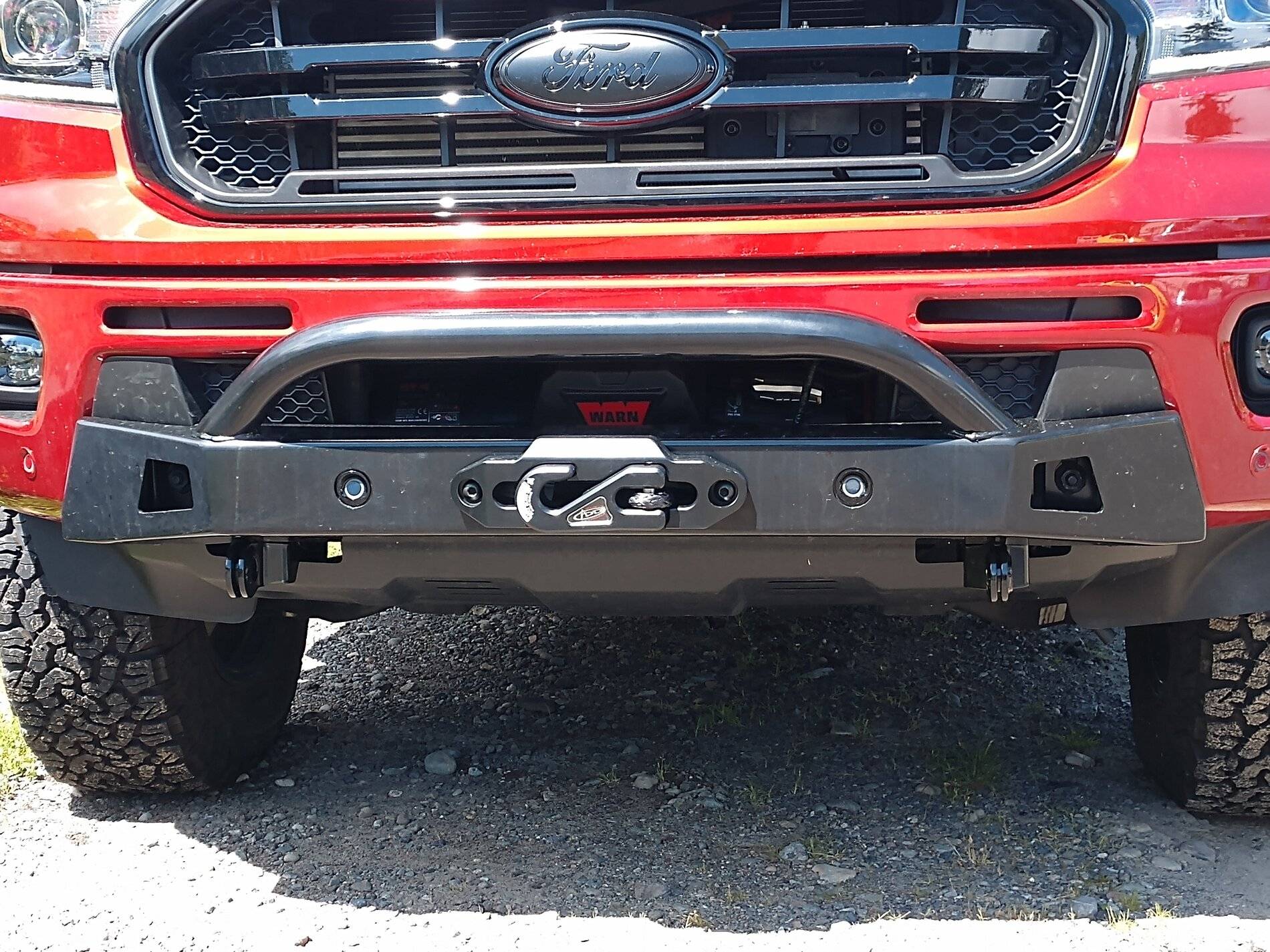

Thanks. Do you have room to switch the winch in to free spool?
Yep, probably even more room than on any of the ARB bumpers I've ever own. Just reach right through the front grill.

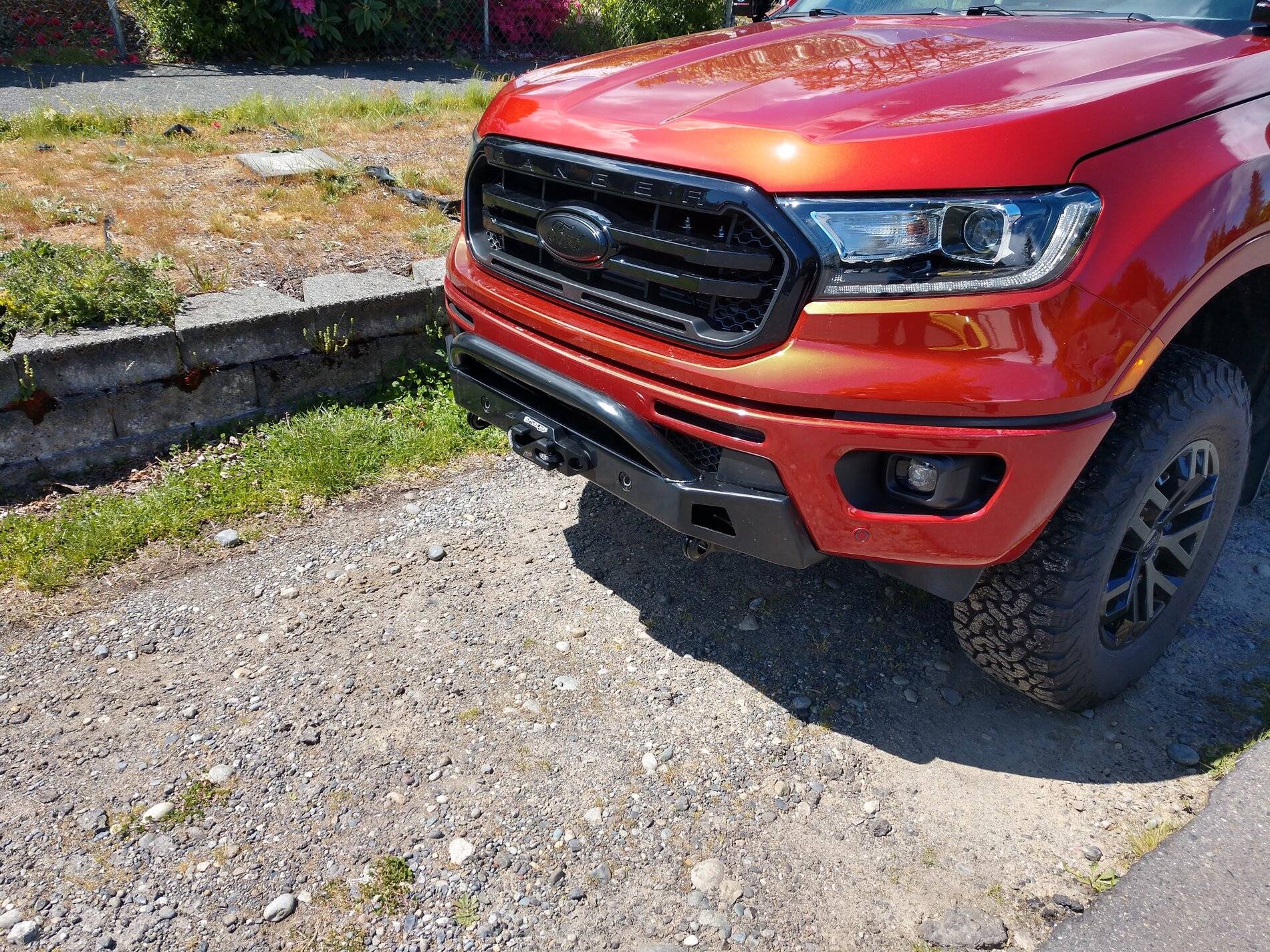

Finished the install of the Shrockworks winch mount bumper. Instructions are very vague. I was able to install without taking the bumper off. Used most of the OEM hardware. If you have the from parking sensors and adaptive cruise, you will have to either drill a hole in the top of the new piece or epoxy a retainer to keep the wire harness off the winch line. I used a WARN EVO 10S and it is very tight. The wires have to get protected against rubbing on the lower grill surround support brackets. The piece doesn't fit exactly flush, good enough

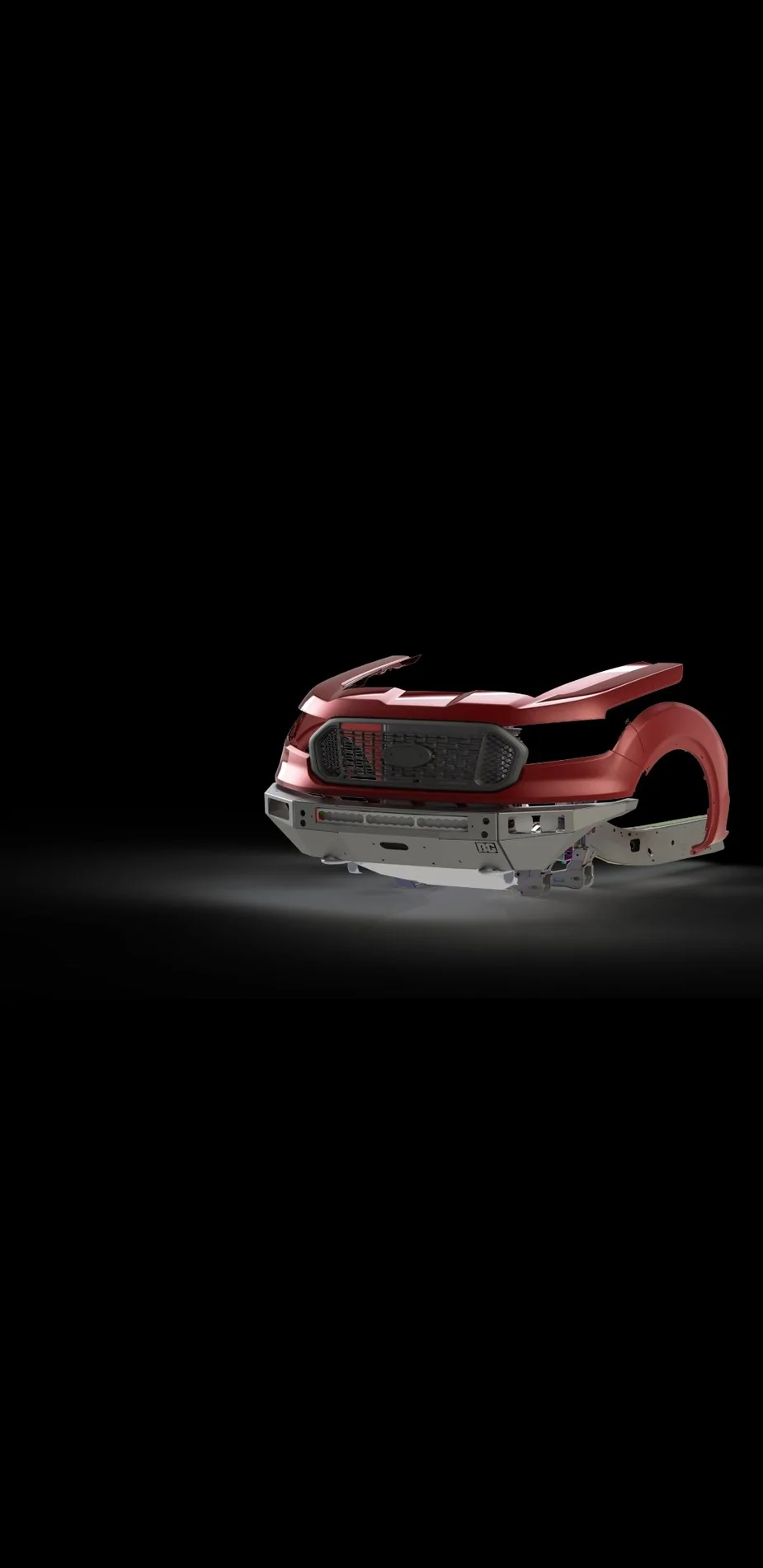

Coming soon. Prototype should be done in a week and a half, then mounting and some testing. Winch capable, wire management tabs/light mounting points included, modular 3 piece design, retains parking sensors and tow hooks, relocated ACC, gussets for strength. And that's just the stage 1.
Looks great!
Did you use the Shrockworks ACC relocation bracket or someone else's?

I used the ADD relocation bracket, but having a problem with it staying adjusted. The thin piece of plastic it mounts to is very flexible. Just came back from a trip, the trouble it is giving me is on curves, especially to the left. If passing another vehicle in the right lane next to you, it wants to pick up that vehicle. The dealership said the bracket may be too heavy for the location and may need to figure out a way to support it better.
