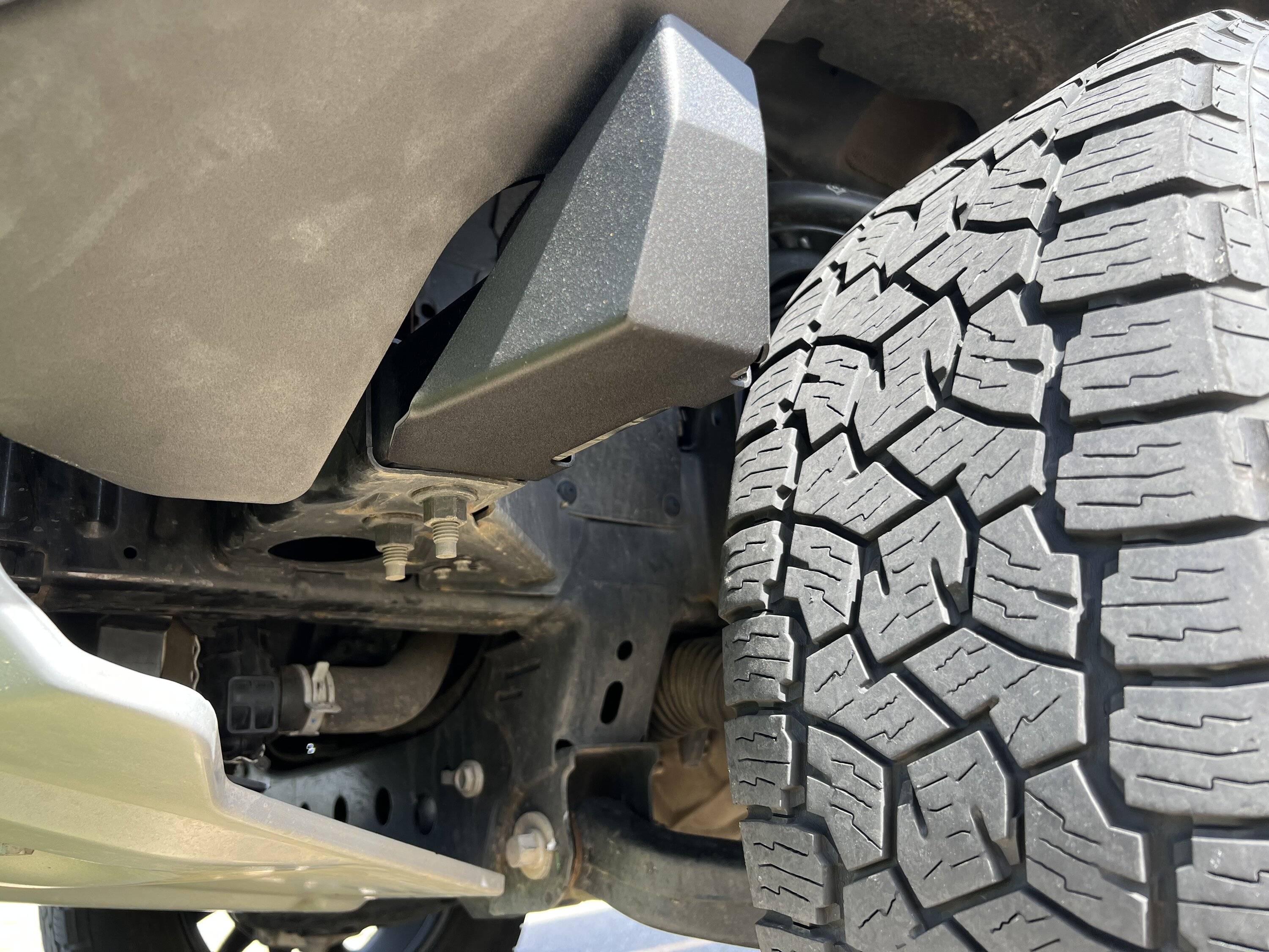

what happens to the crash bars? removed? can i see a pic of where they would be

The bumper comes with trim pieces that cover the stock crash bars. Whether you remove them or not is still based on all the typical considerations. (Lift, tire size, bumper clearance, etc)
